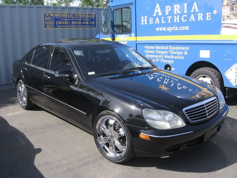

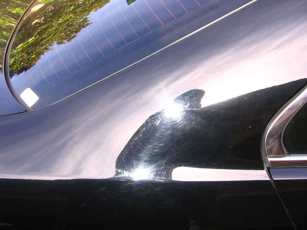

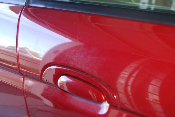

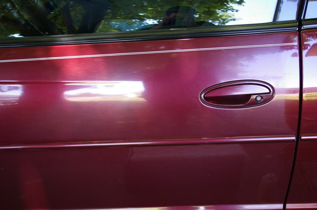

All of the pics posted below are cars that I detailed (i'm not a pro, just a hobby of mine) using a Porter Cable 7424 and various pads/product. The only one I used a rotary on is the black Mercedes due to the abnormally hard paint Mercedes uses (I guess super heavy swirls might have had something to do with that decision too).
Mercedes S430
Before
Posted Image
Posted Image
Posted Image
Posted Image
After
Posted Image
Posted Image
Posted Image
Posted Image

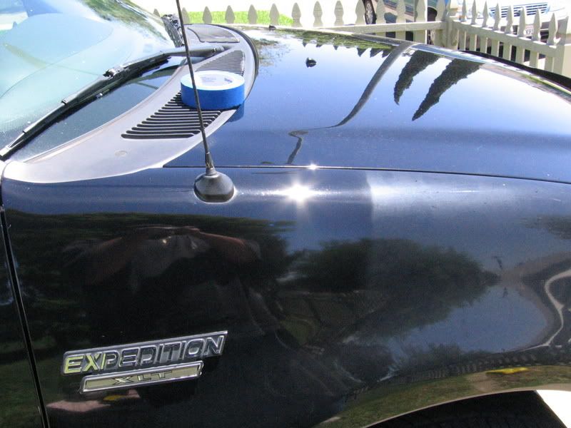

Expedition
Posted Image
Posted Image
Posted Image
Posted Image
Posted Image
Civic
Posted Image
Posted Image
Posted Image
Posted Image
Posted Image

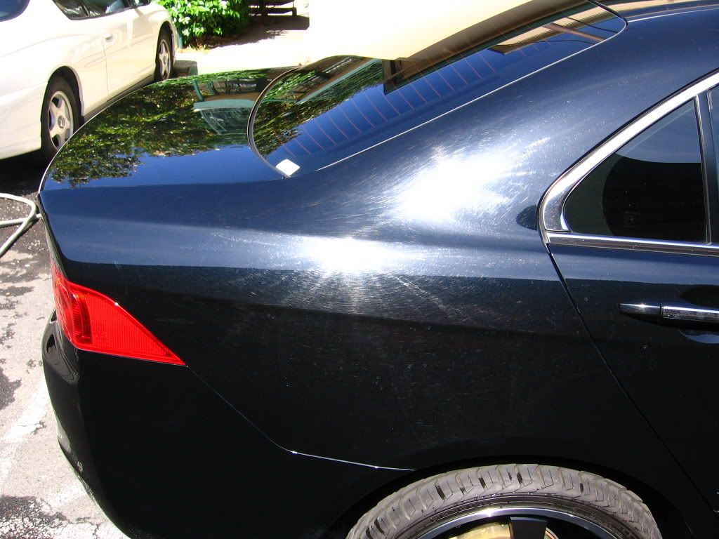

TSX
Posted Image
Posted Image
Posted Image
Posted Image
Posted Image
Posted Image

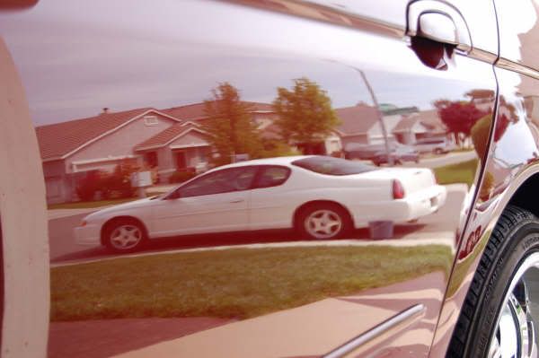

Monte Carlo
Posted Image
Posted Image
Posted Image
Posted Image
Posted Image

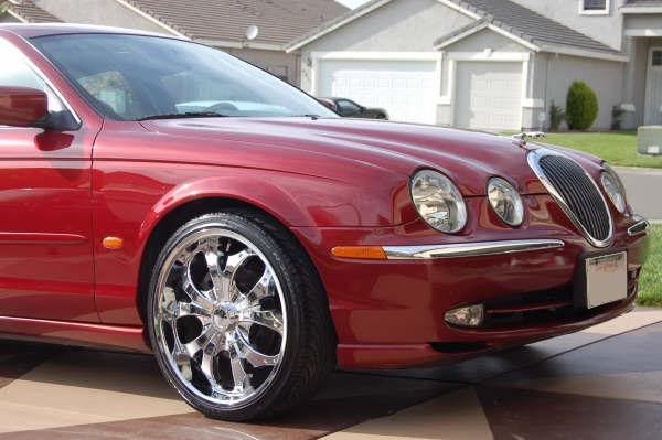

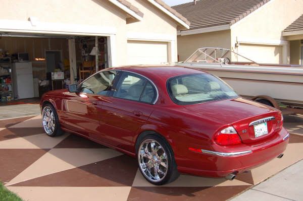

Jaguar
Posted Image
Posted Image
Posted Image
Posted Image
Posted Image
Posted Image
Posted Image
Posted Image
So as you can see, you can obtain lots of correction without having to use a rotary buffer, it's all about pad and product selection (I guess you need some skill too).
