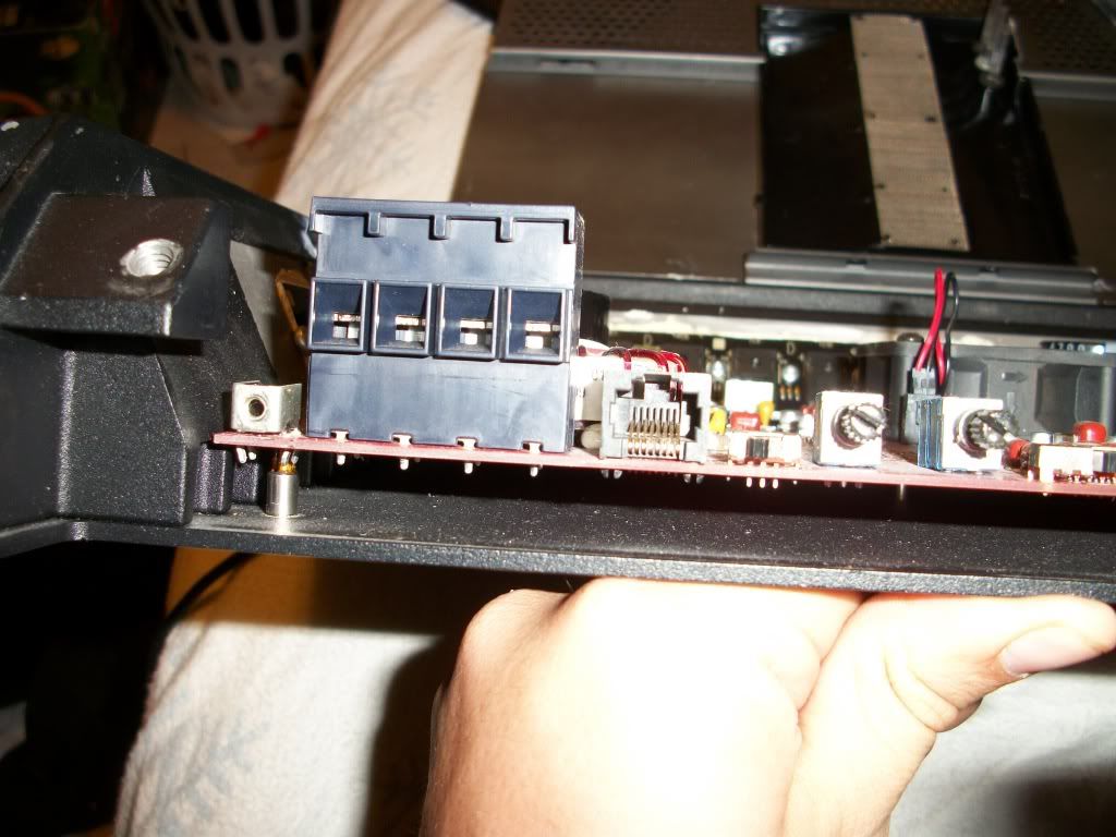

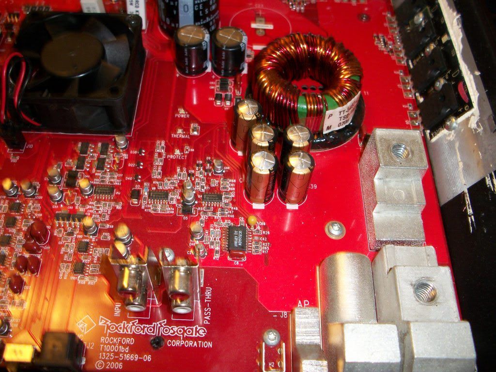

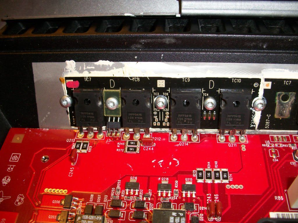

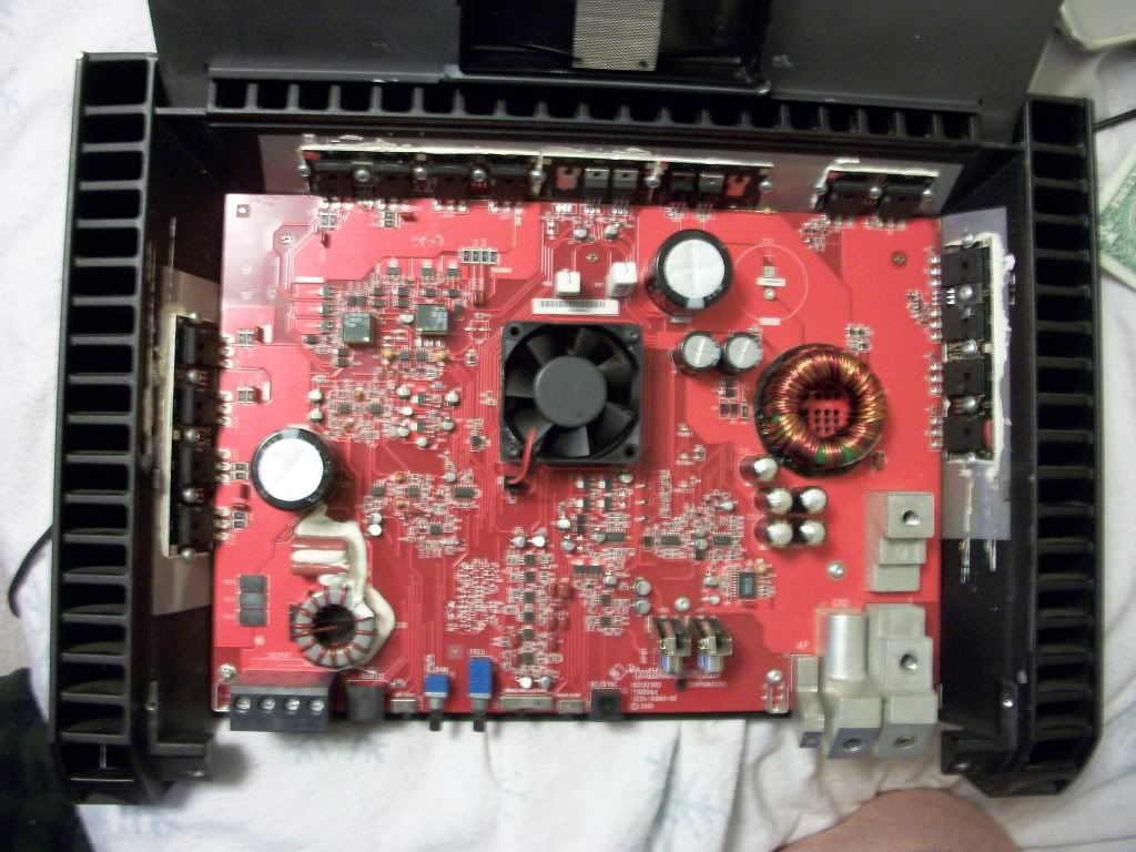

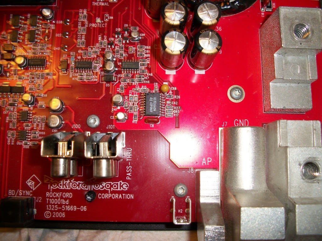

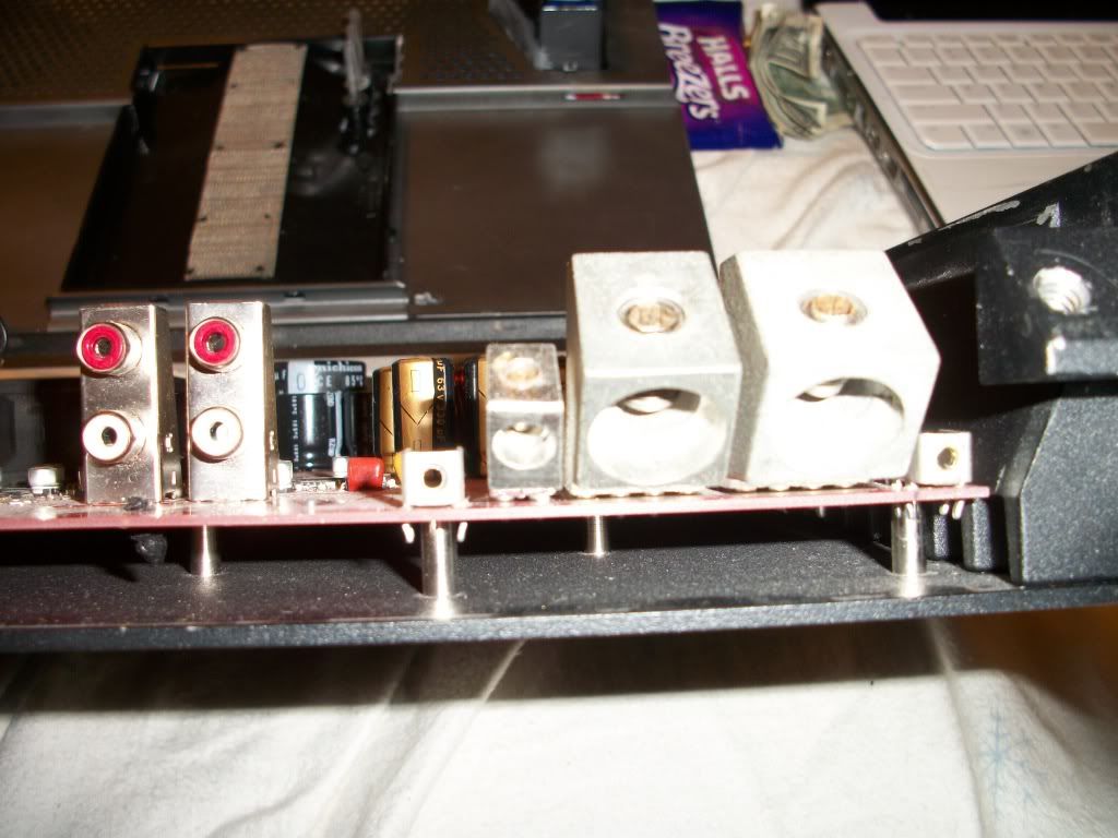

hello i bought a Rf T1000-1 off a fellow firefighter and i was wondering how much it would cost to get her running again havent tried to power her up yet im not wanting her to look pretty cause i can clean her up i just need her running again already have a sub ready for her to marry up too soo heres some pictures

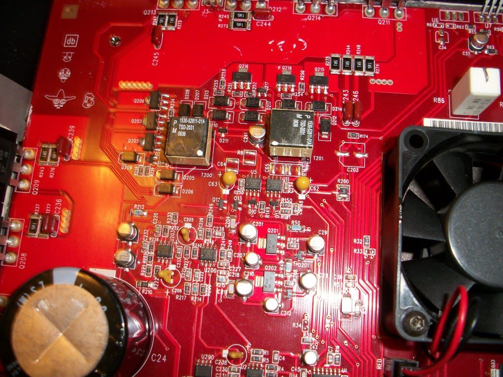

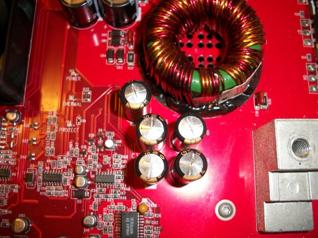

we think these 4 capacitors are shot

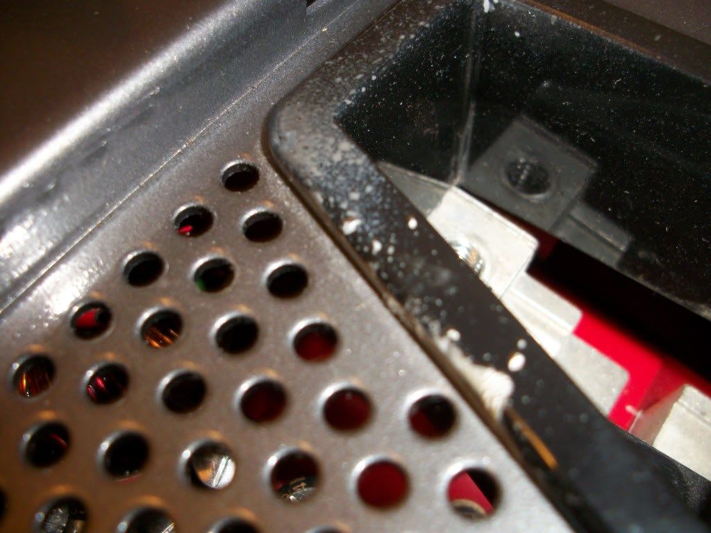

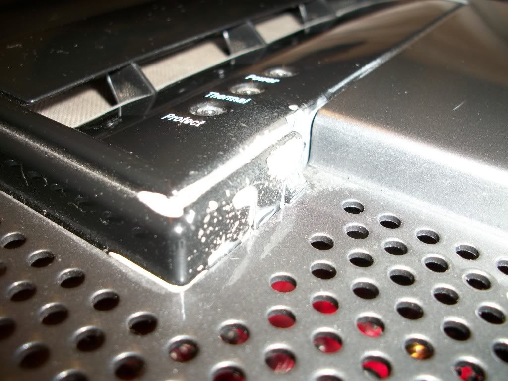

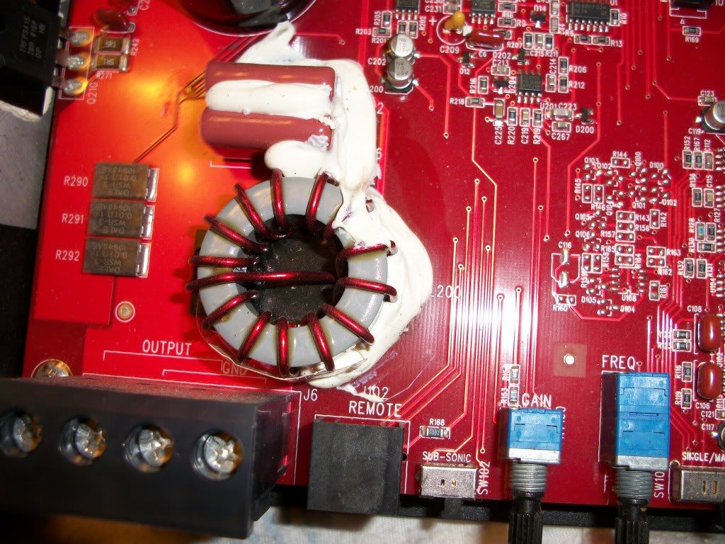

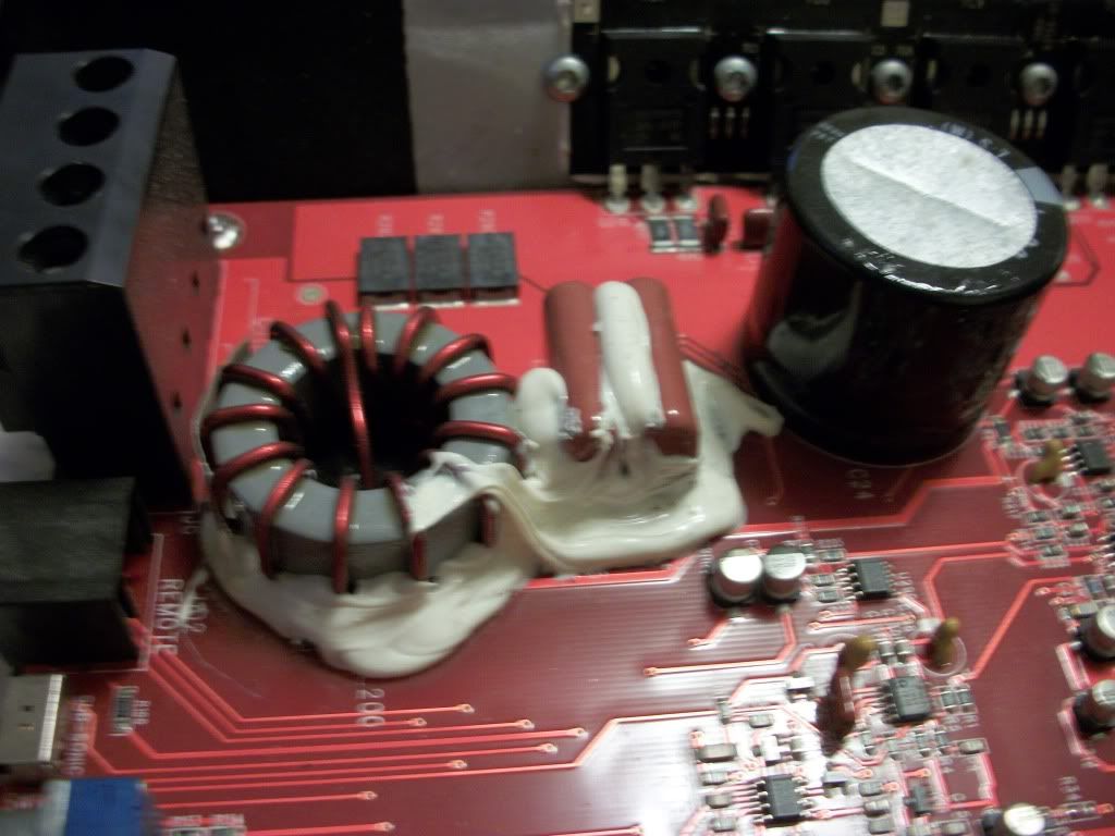

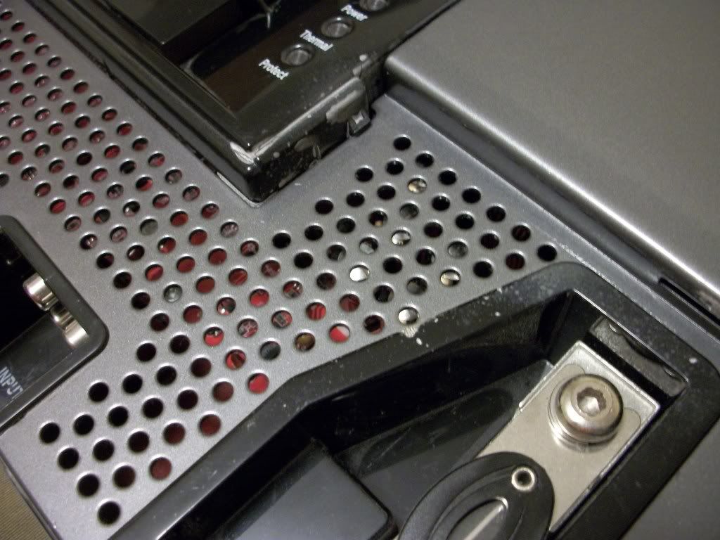

on the corner of this cover piece where the protect/thermal/power lights are there a dried white liquid thought id throw that in there

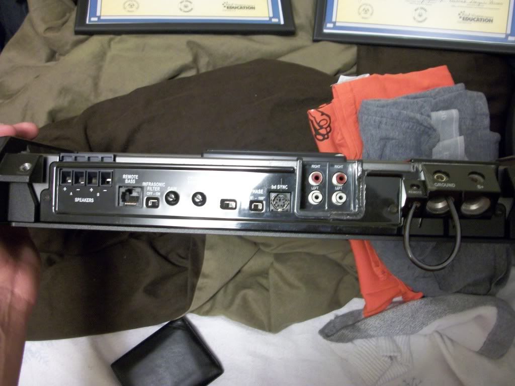

just curious, but why is there a jumper cable from the remote to the ground??
RF charges flat rate pricing for amp repairs, its not pretty. But i'd check out ARC and see what they can do for you
ohhh hahaha there isnt just got bored its 12 gauge wire for a remote and i just stuck it in there just shits and giggles

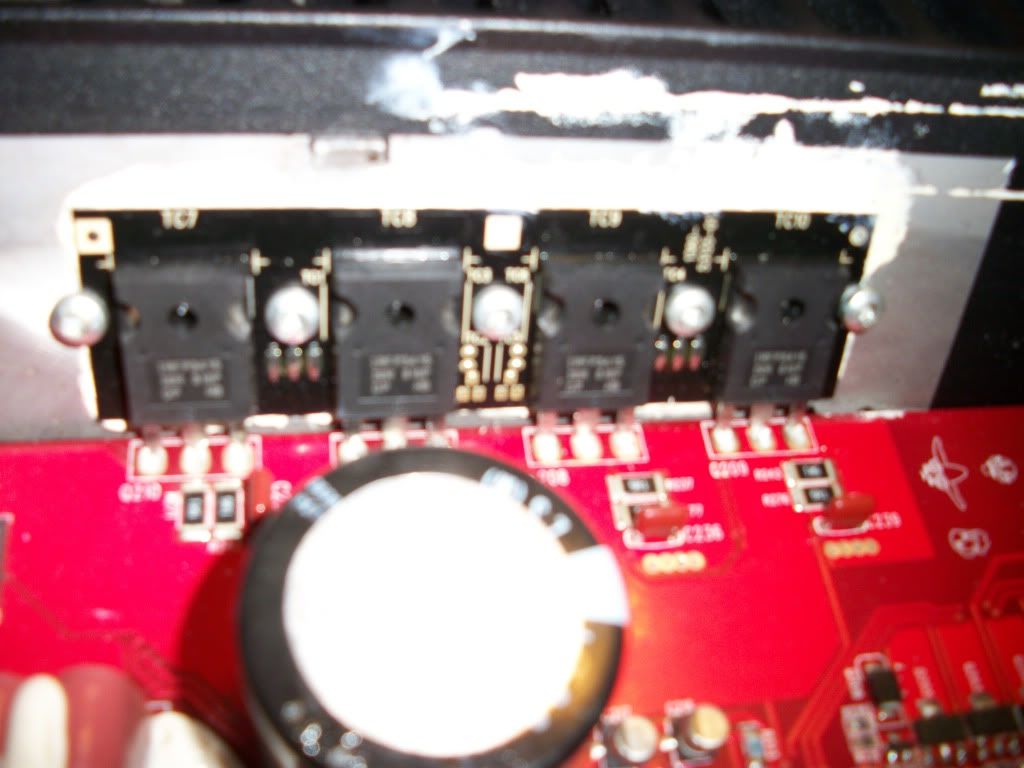

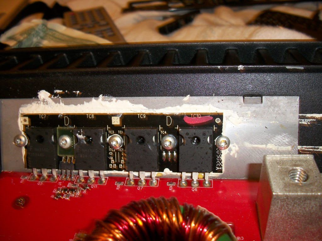

The dried white stuff is probably thermal paste from the old owner taking the board completely out. (it gets messy) If the caps are bulged they are shot. Also it looks like two of those mosfets are crispy where the solder joint is.
Hopefully the old owner didn't attempt to fix it when he had the board out.

those solder joints all look pretty factory to me. rf flate rate is probably going to be expensive btw
which solder joints are yall talking about?

to the mosfets caps do look bubbled thou.
nope those are factory

factory or not im saying they look liek they might be busted. if the top of the cap is flat then its probably still good but if it has a dome on it sorta then its probably broken. but it doesnt make a difference no one can really tell whats busted on an amp by looks. unless your board is burnt of the fets blew up where they burnt or broke apart theres little visual tells of broken parts. and even if there was thats never ever the "only" problem
make sure to tell whoever your getting estimates from that its an 05-07 T10001bd. alot of repair shops wont go near those amps with a 10ft pole because replacing fets is much harder then alot of amps out there.
