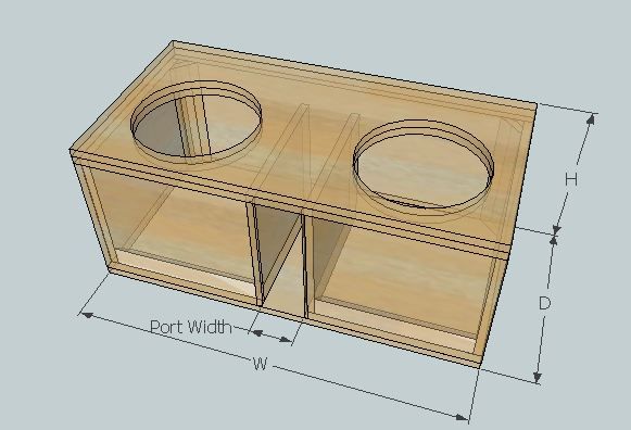

Take a look:
Enclosure Specifications:
Fb = 36.5 Hz
Vb = 9 ft^3
External Height = 21 in
External Width = 41 in
External Depth = 26 in
Port Width = 7 in
Cut Sheet List:
* All Dimensions in Inches.
* Wood Thickness is 3/4 for all Parts.
External Enclosure Parts:
2 x Top & Bottom (3 parts) = 41 x 26
Left & Right Sides = 24 1/2 x 18 3/4
2x Front = 17 x 18 3/4
Back = 41 x 18 3/4
Shared Port Internal Assembly Parts:
2 x Front to Back = 16 1/4 x 18 3/4
Assembly guide (generic dimensions):
Posted Image
Let me know any questions.
