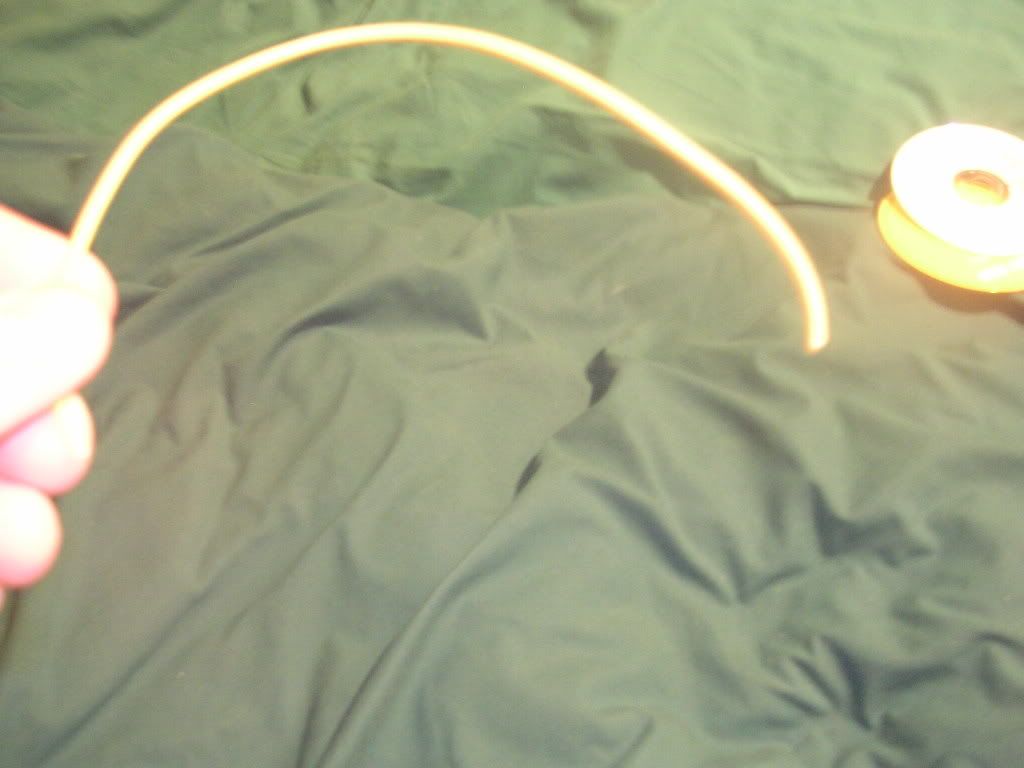

you take a piece of wire mines 18guage

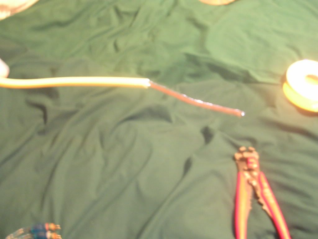

strip it back bout 3inches from end or how ever long needed

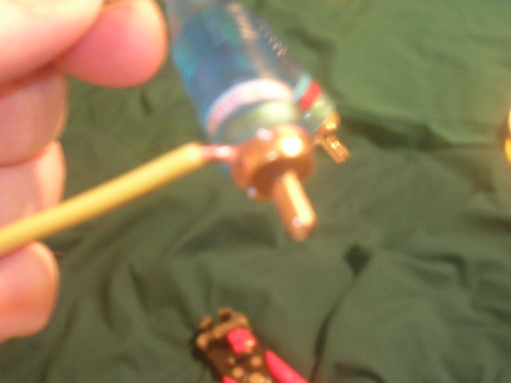

take ur rcas
Posted Image
rap the wire around the O

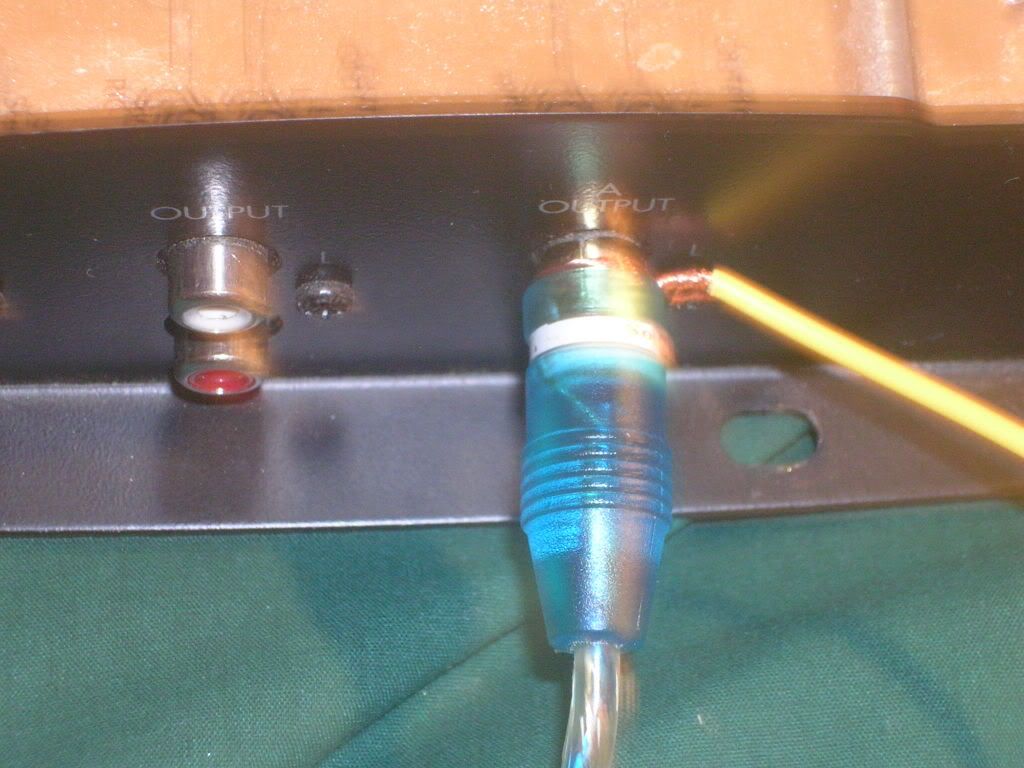

and then hook it up(i used my xover to show how it will look)
Posted Image
after this you hook it into the back of your headunit, and ground it at the headunit or it wont work, most rcas have ground current anyways so it wont affect the headunit at all(mines like this now and works perfect) and then plug it in, you only halfto do it to one side of the rca not both but if u want to thats fine also, and it should get rid of it cause mine aint come back yet, hope this helps all of yall from haveing to halfto rewire alot of shit just to halfto do this in the end cause ive had to many times :lol: , u can soilder(sp) it if u want to but it shouldn't go anywere if u twist it really tight, ive went threw about 4 sets of new rcas tryin to get rid of my ground noise and noise filters and this fixed it fast and right, hope this gets a sticky :p cause i kno some ppl will be comein back to it in time ;) thankx matt
