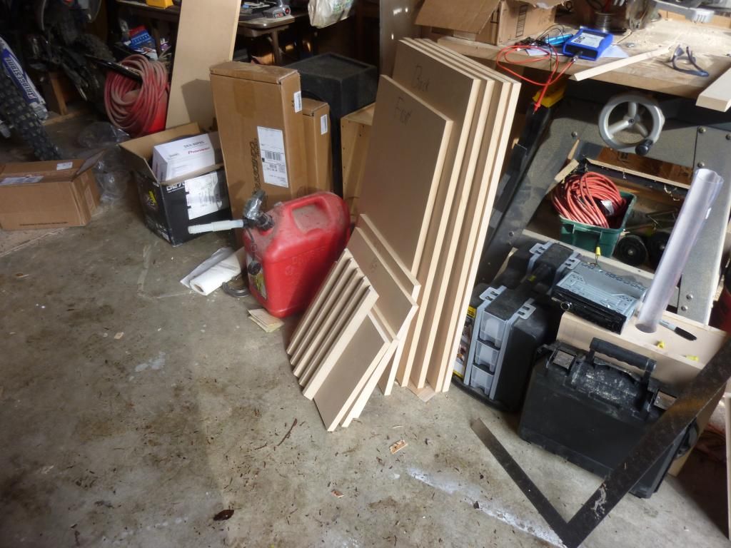

And here's the wood all cut out!
Posted Image
