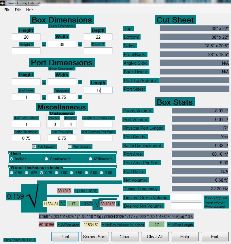

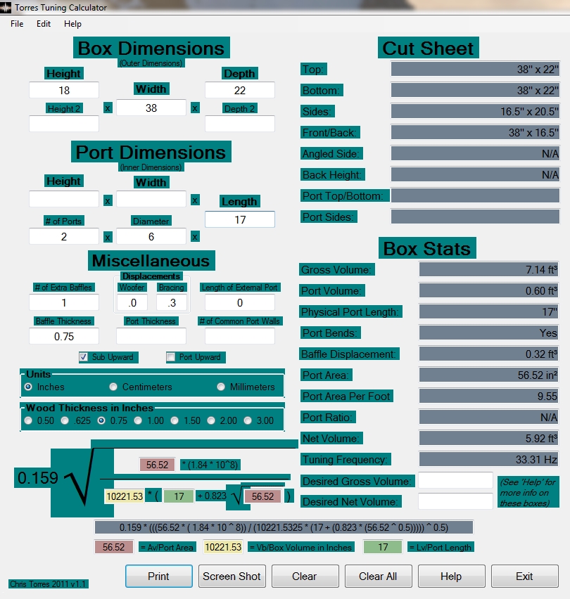

Skater229 Posted September 23, 2014 Report Share Posted September 23, 2014 (edited) Looking at building a new box and would like some input... Here is what I am looking at so far... ****Edit*** Looking to have them inverted, and that is why there isn't anything in the woofer displacement... Edited September 23, 2014 by Skater229 Quote 2010 Chevy HHR Panel (Work in progress) Pioneer AVHX-5800BHS McLaren MLM880's and MLT2's 2ea per door on a DC 175.4 Two DC Audio M4 Level 5 15's On A DC5K Alt CES 200/270+ 4ea Banks of Maxwell 2.7v 3000f caps for a total of 2000f 1ea XS 3100 and 2ea NSB FT170 Batts for 450+ah Not a HUGE build but here it is... DC Audio HHR Build Link to comment Share on other sites More sharing options...
will77530 Posted September 23, 2014 Report Share Posted September 23, 2014 looks good to me Quote Link to comment Share on other sites More sharing options...

Gladski462 Posted October 7, 2014 Report Share Posted October 7, 2014 Looks pretty solid. I wouldn't change anything. Good luck with the build. Quote 08' Grand Cherokee (2) DC Lvl 4 12's Link to comment Share on other sites More sharing options...
Skater229 Posted November 22, 2014 Author Report Share Posted November 22, 2014 Ok so i have ordered a 8.75 inch Psychoport and here is the modded torres info... Quote 2010 Chevy HHR Panel (Work in progress) Pioneer AVHX-5800BHS McLaren MLM880's and MLT2's 2ea per door on a DC 175.4 Two DC Audio M4 Level 5 15's On A DC5K Alt CES 200/270+ 4ea Banks of Maxwell 2.7v 3000f caps for a total of 2000f 1ea XS 3100 and 2ea NSB FT170 Batts for 450+ah Not a HUGE build but here it is... DC Audio HHR Build Link to comment Share on other sites More sharing options...
Smoove Posted November 22, 2014 Report Share Posted November 22, 2014 Ok so i have ordered a 8.75 inch Psychoport and here is the modded torres info... Still on the low end for an aero port for 2 15's Quote 2 Team Fi 15's v1 2 DD M5's 970amps of Alt 6th order blowthroughThe truck Blowthrough build : http://www.stevemeadedesigns.com/board/topic/155555-smooves-1996-chevy-ext-cab-c1500-slow-build/The 350z build : http://www.stevemeadedesigns.com/board/topic/170694-smooves-2003-nissan-350z/ My FB page https://www.facebook.com/pages/Smooves-Car-Audio-and-performance/719746144805343 Team Fi Audio http://www.ficaraudio.com/ Link to comment Share on other sites More sharing options...
Skater229 Posted November 22, 2014 Author Report Share Posted November 22, 2014 ???? Quote 2010 Chevy HHR Panel (Work in progress) Pioneer AVHX-5800BHS McLaren MLM880's and MLT2's 2ea per door on a DC 175.4 Two DC Audio M4 Level 5 15's On A DC5K Alt CES 200/270+ 4ea Banks of Maxwell 2.7v 3000f caps for a total of 2000f 1ea XS 3100 and 2ea NSB FT170 Batts for 450+ah Not a HUGE build but here it is... DC Audio HHR Build Link to comment Share on other sites More sharing options...
Smoove Posted November 22, 2014 Report Share Posted November 22, 2014 9-12 is the generic average used for aero ports. you at 9sqin per cube. I'd shoot for more like 10-11 with those subs. Quote 2 Team Fi 15's v1 2 DD M5's 970amps of Alt 6th order blowthroughThe truck Blowthrough build : http://www.stevemeadedesigns.com/board/topic/155555-smooves-1996-chevy-ext-cab-c1500-slow-build/The 350z build : http://www.stevemeadedesigns.com/board/topic/170694-smooves-2003-nissan-350z/ My FB page https://www.facebook.com/pages/Smooves-Car-Audio-and-performance/719746144805343 Team Fi Audio http://www.ficaraudio.com/ Link to comment Share on other sites More sharing options...
