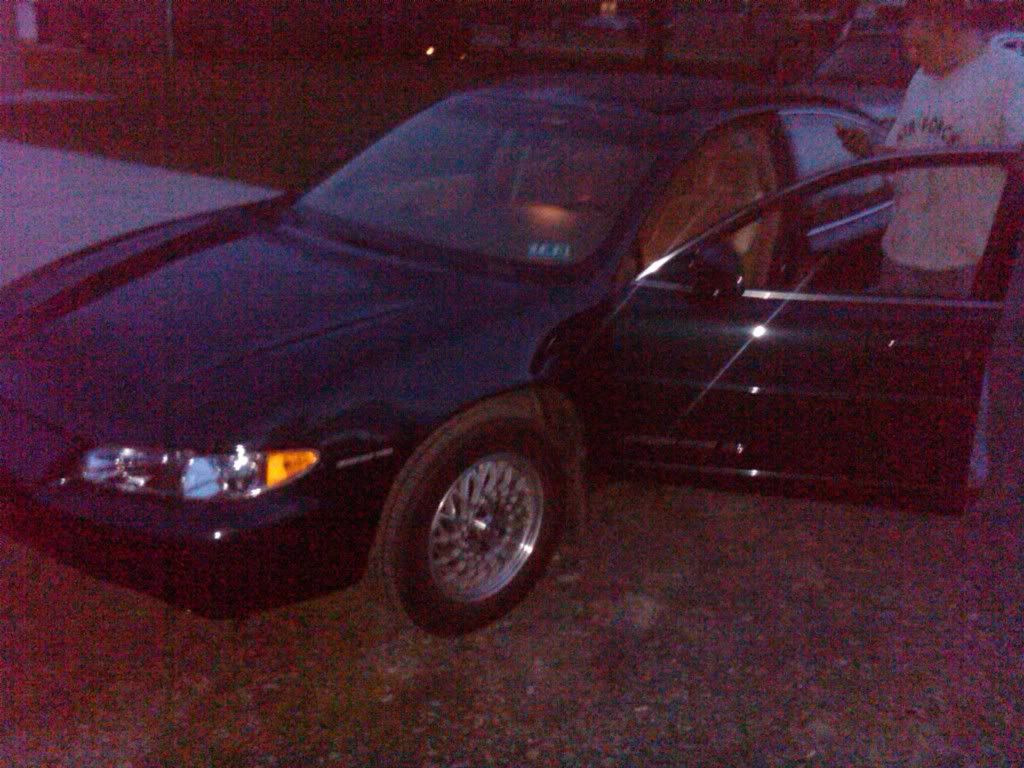

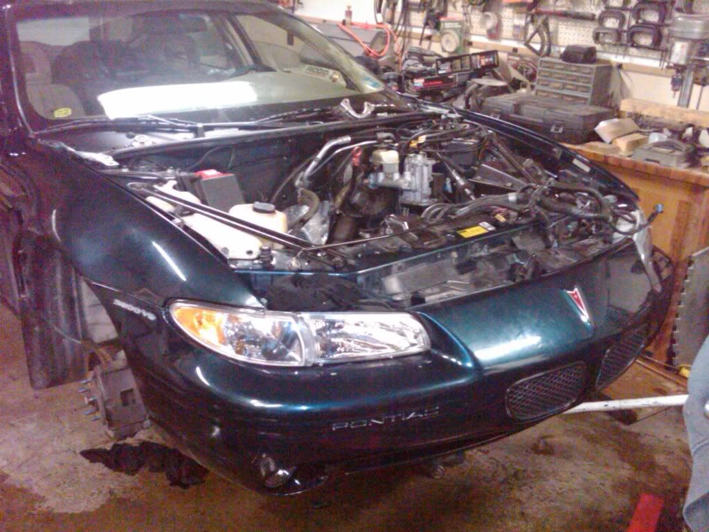

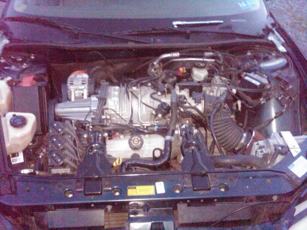

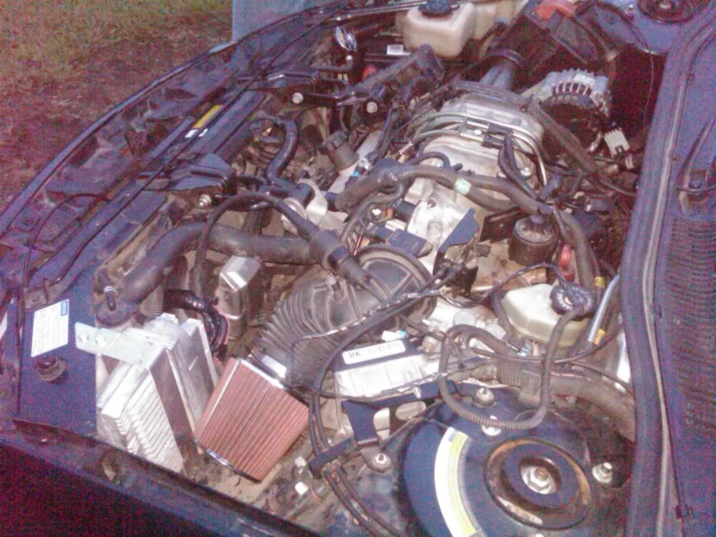

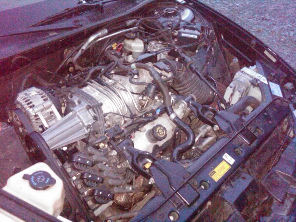

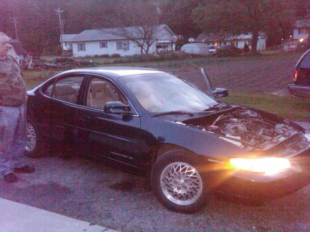

Okay its in a 1997 Grand Prix SE, 4dr no wing = total sleeper.
Posted Image
Posted Image
Posted Image
Posted Image
Posted Image
Posted Image
Posted Image
My brother and I did the swap for my dad... He got lucky and scored the complete running GTP motor for $250 and all it had wrong with it was a bad supercharger coupler which was a $30 30minute fix.
