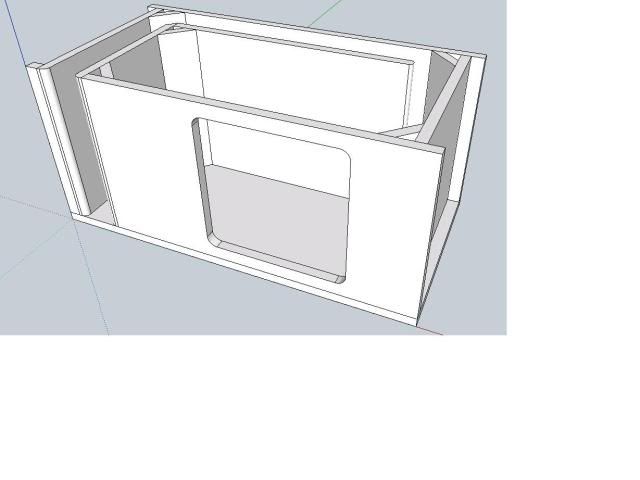

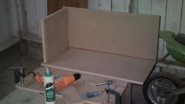

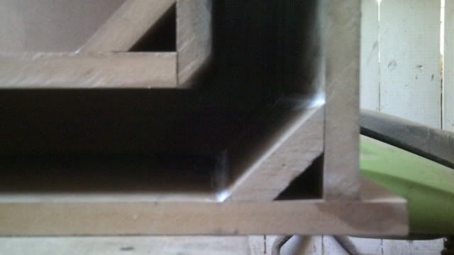

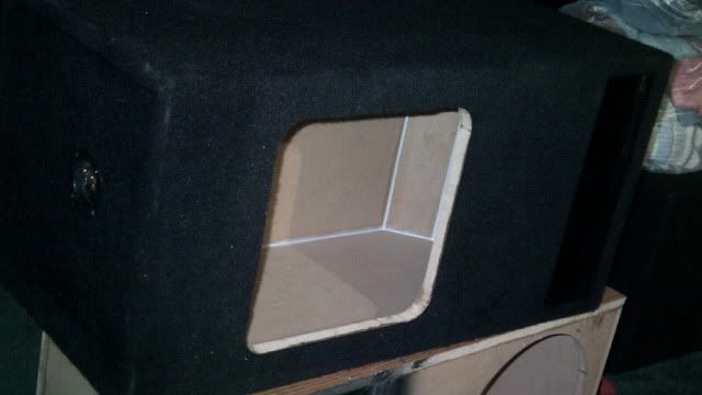

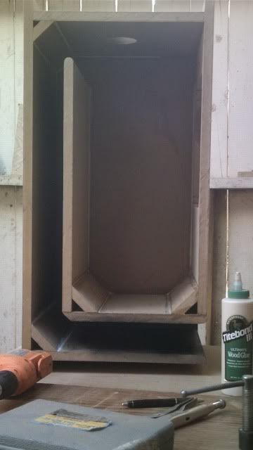

Here's a box I built for a "customer's" 05 kicker L5 12
Specs: 1.75cu.ft(after displacements) with 33.13sq.in. of port area @ 35HZ
Lets get started:
Sketch-ups:
Posted Image
Posted Image

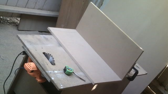

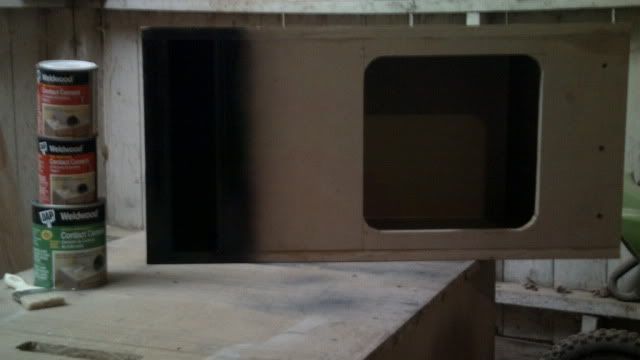

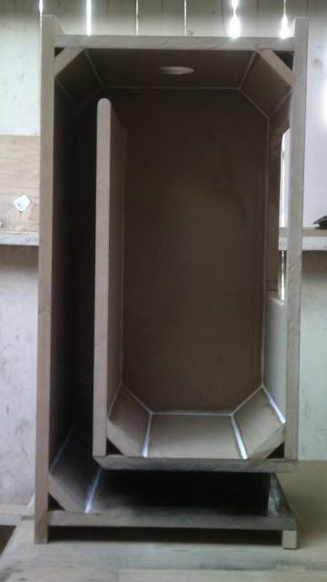

Started putting it together:
Posted Image
^^Home-made tablesaw FTW!!!B)
Posted Image
Posted Image
Posted Image
Posted Image
Posted Image
Posted Image

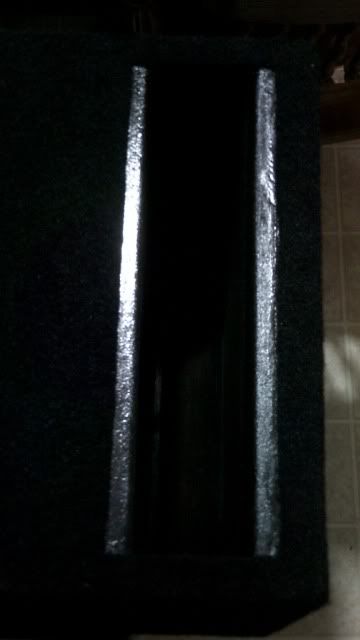

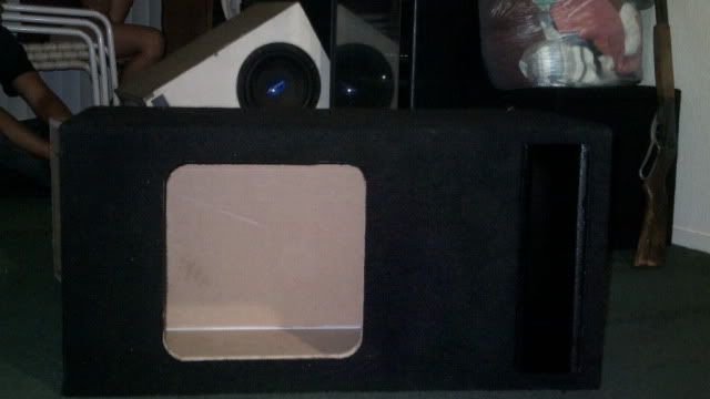

Carpetted:
Posted Image
Posted Image
Posted Image
LMK what ya'll think! :)

came out great. i like the homemade table saw. lol.

Thanks! Lol! Couldn't afford a real table saw, so extra pieces of wood & free circular saw had to work!
