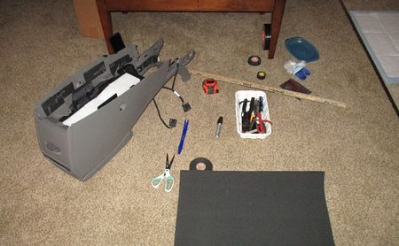

Working on center console to minimize rattles.
 IMG_3061
I had to take it apart as much as possible to add mass and stuff CCF in as many places i thought would help.
