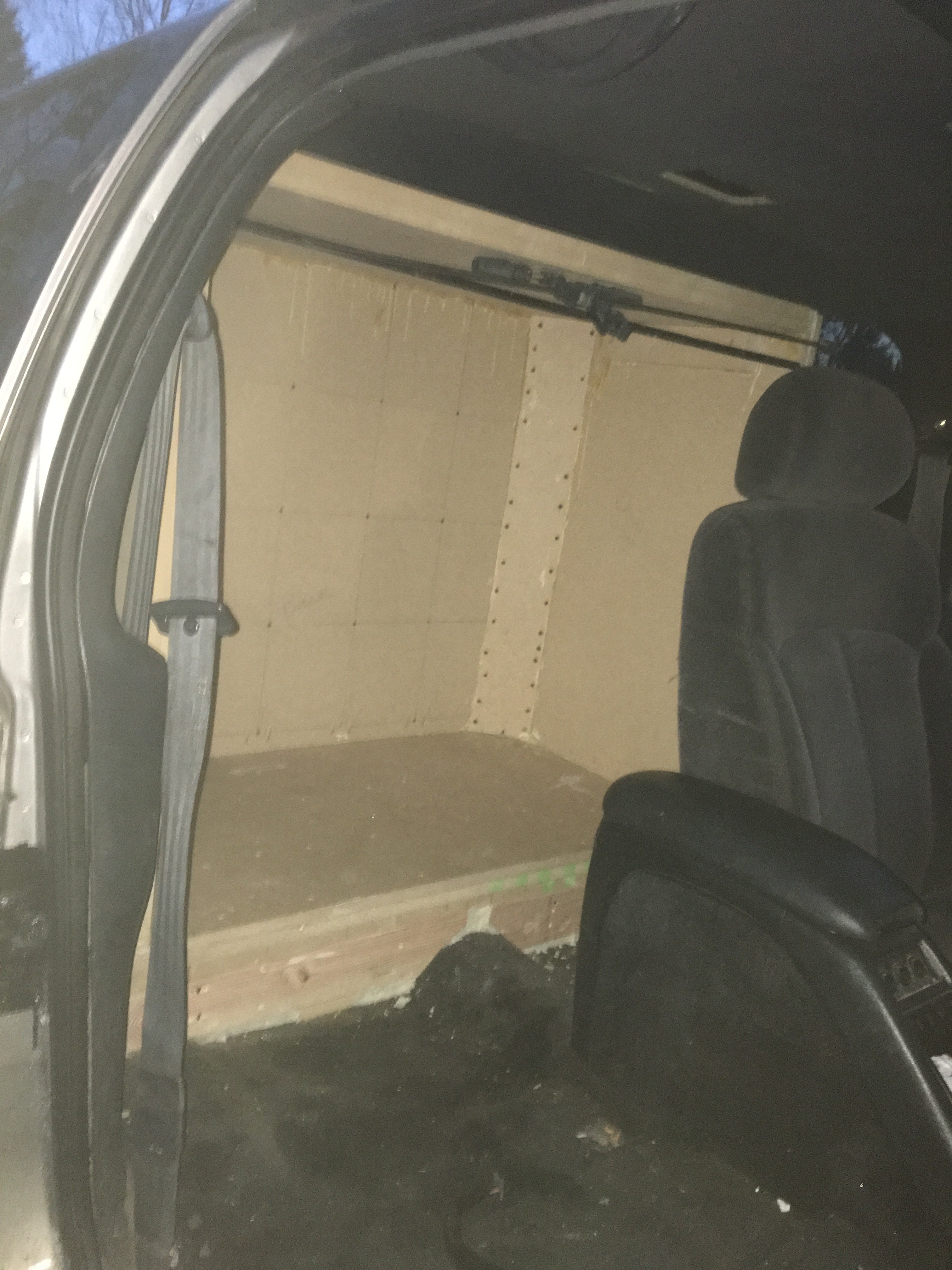

Well, new build has started. Pulled out everything today, and started working on the base. Made a 2x4 frame and started laying down the floor. The frame is bolted down using the seat bolts.
IMG_3632.thumb.JPG.1c23a94aa366314ed066ab9efd629d8c.JPGIMG_3633.thumb.JPG.a409af1e38d83de76a503e24274d0c44.JPG

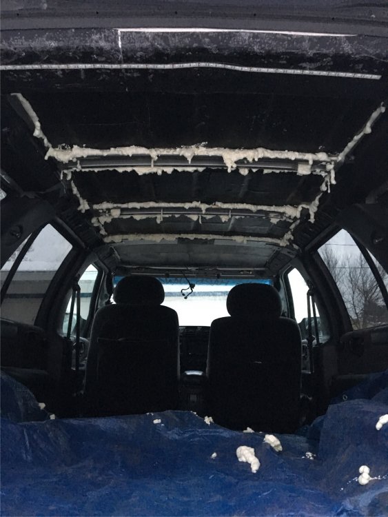

Got a little more progress done today. Got two layers of 160mil vibraflex put onto the roof in front of b pillar. Super solid now!
got two layers put down on the base. Hoping to have the rest of the floor done by tomorrow
then em decided to foam the roof supports and all the other gaps on the roof.

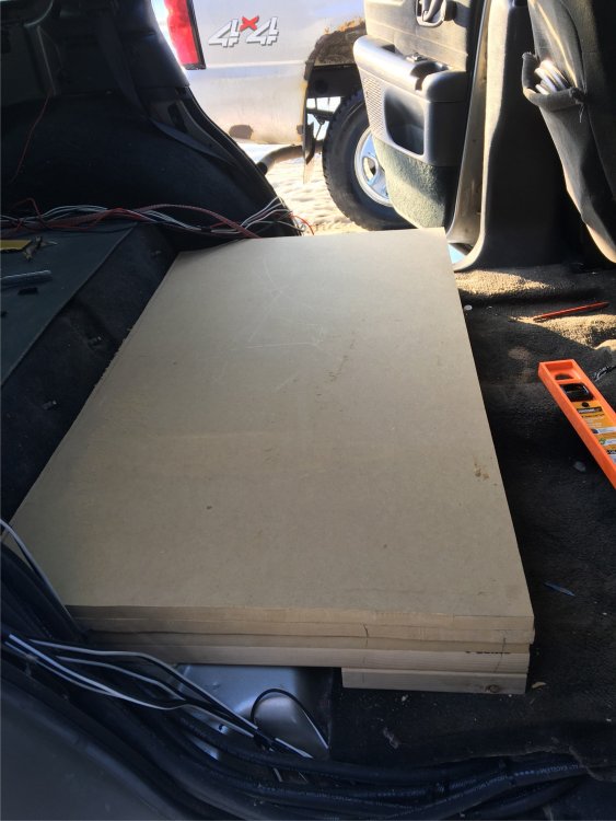

Got the shell all assembled today! 2 layers all the way around. Just need to add 45’s to all the corners, fiberglass all the seams, make the port, and make the quad baffle. Hopefully I’ll get most of that done tomorrow. Here’s what it looks like now. Getting excited to get this done!
