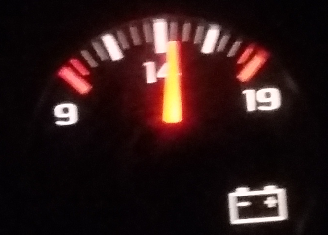

On 9/12/2017 at 3:38 PM, goldeneye4564 said:
should have asked the guy at the counter for blinker fluid too.
I know blinker fluid is not a legit thing i took Automotive classes at a College here and worked on cars and FYI for those who are NON-Belivers i have a picture that will not only shut you up but realize maybe oh he is telling the truth!
And this was with the headlights & fog lights & blower motor running and system up to 35 of 35 on my deck and sitting idle!
