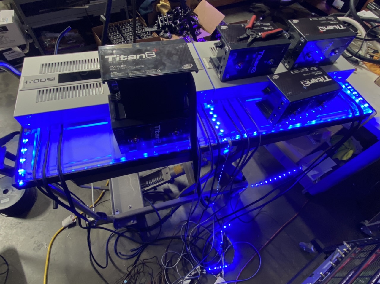

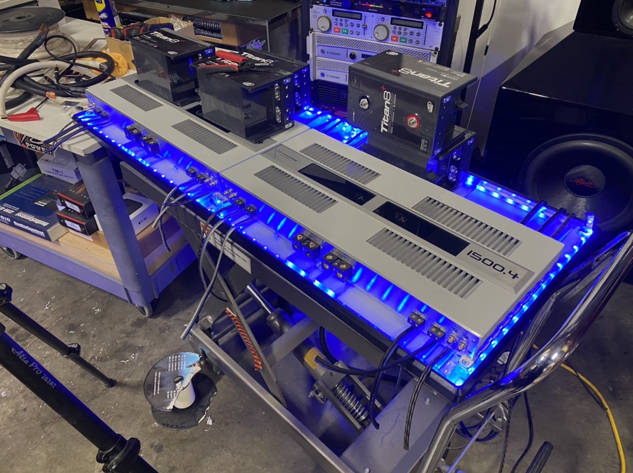

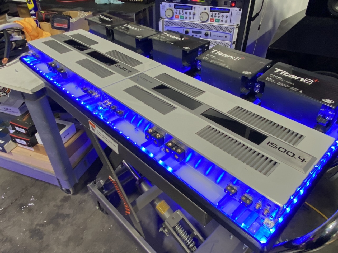

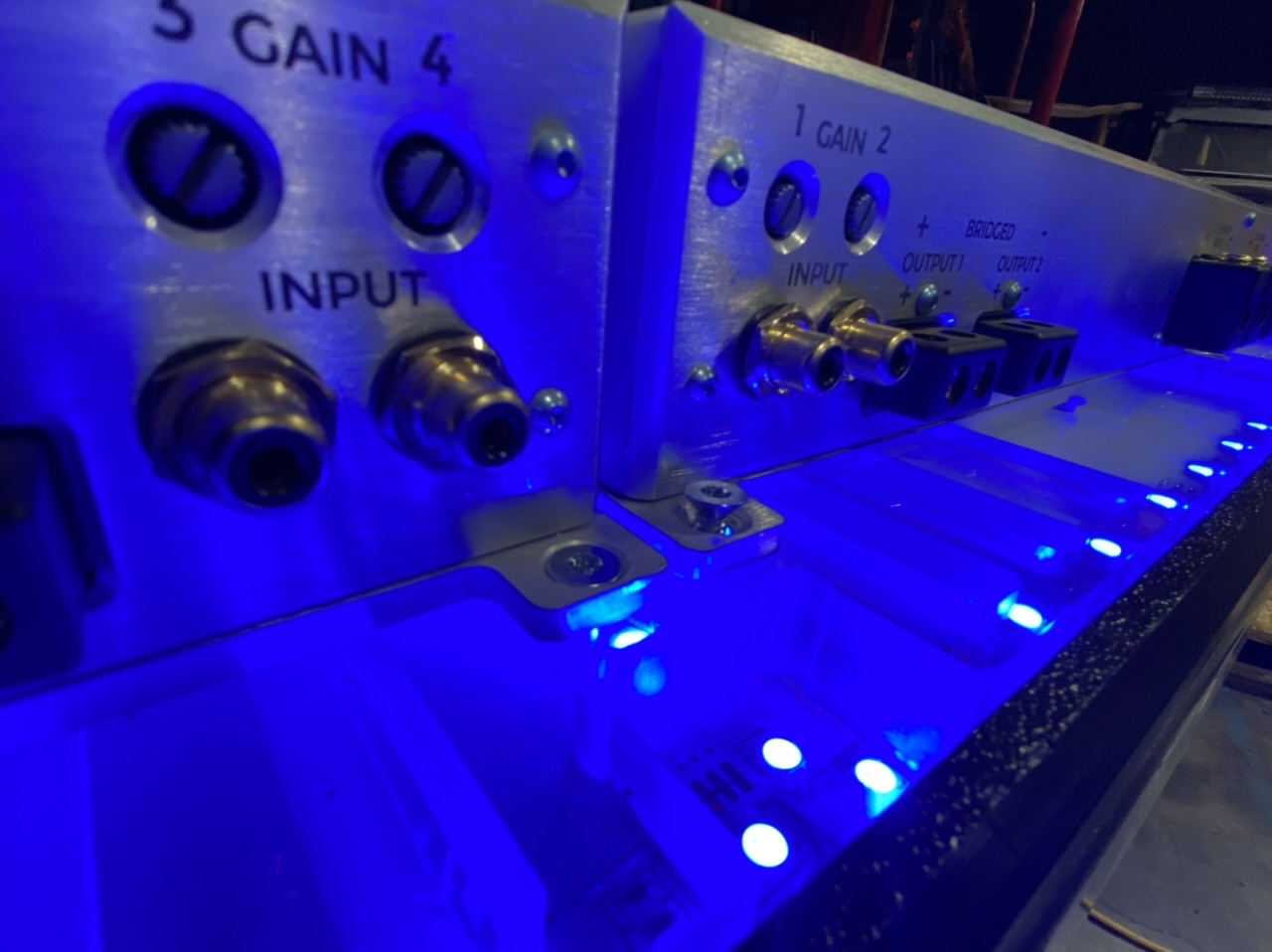

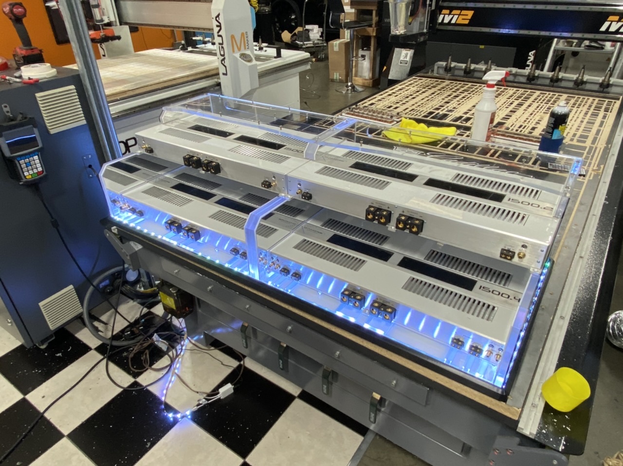

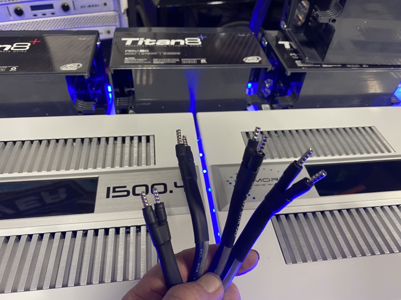

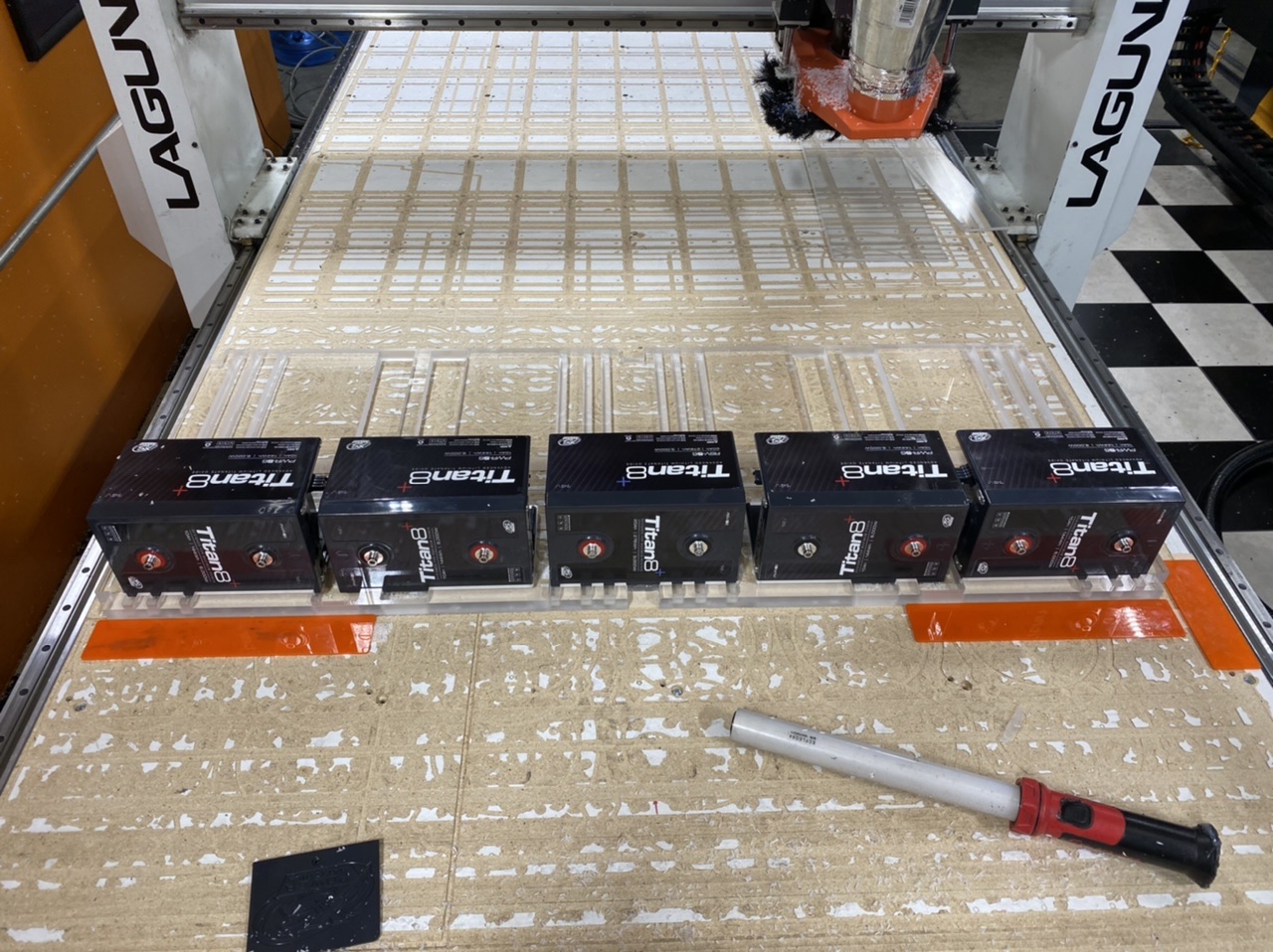

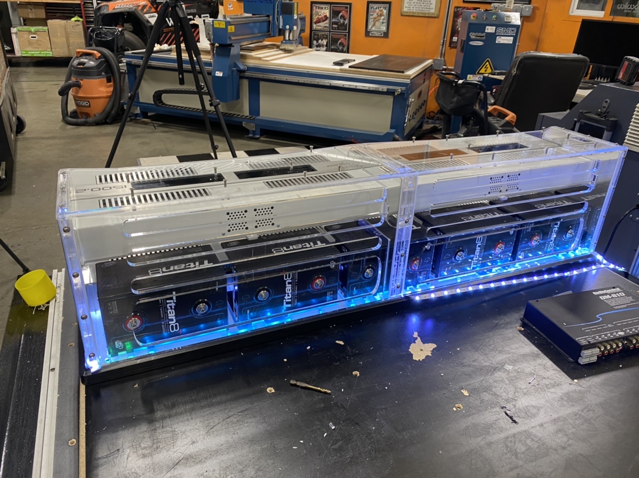

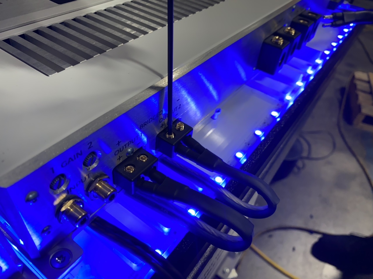

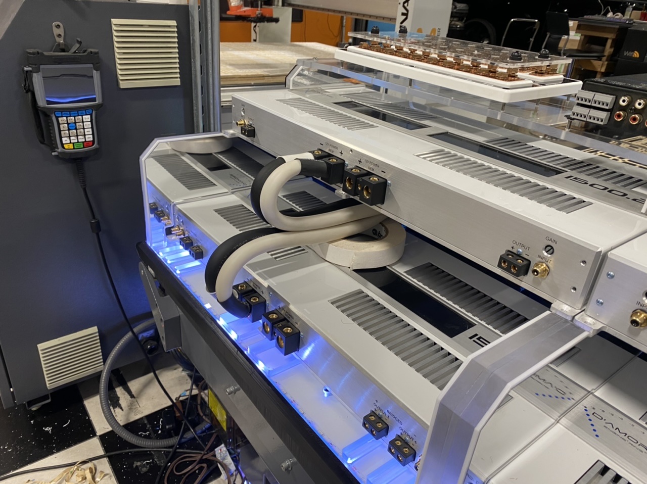

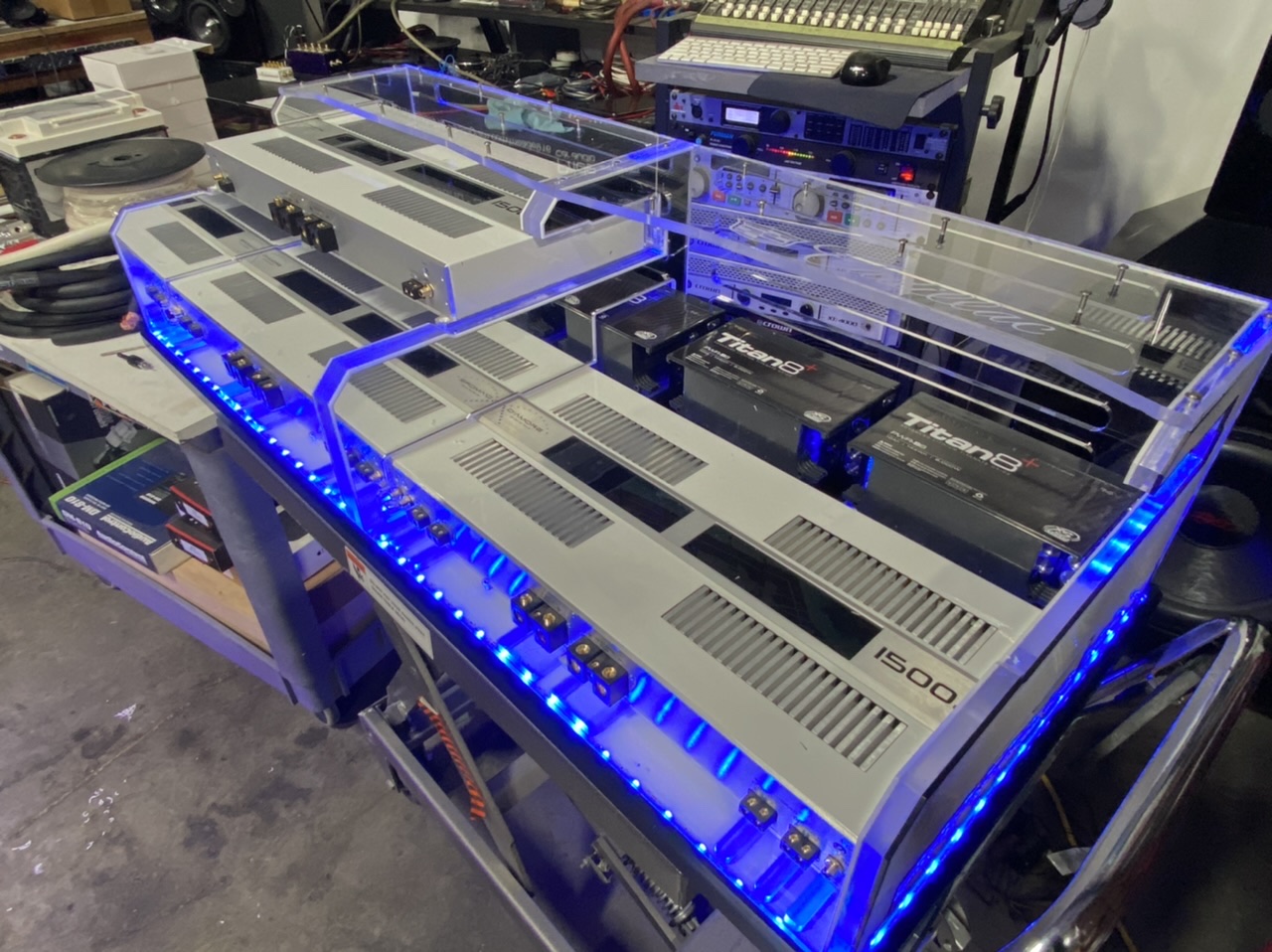

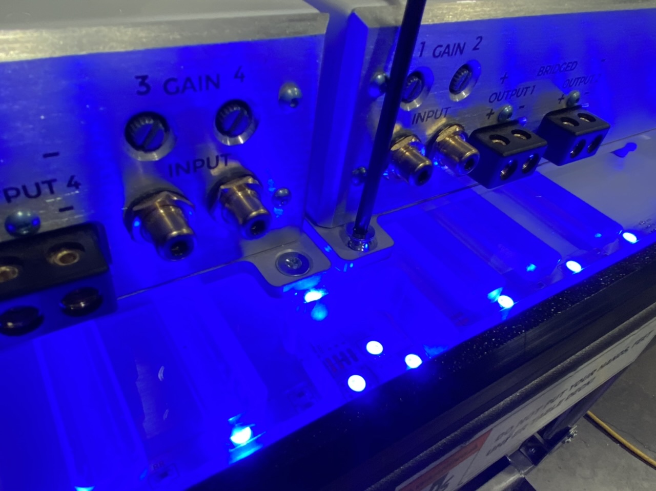

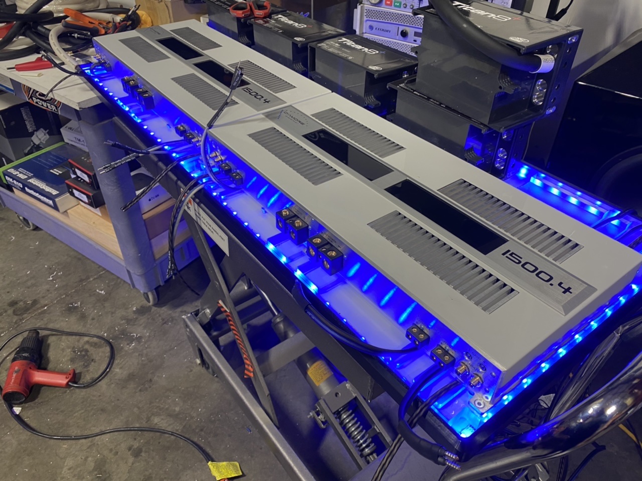

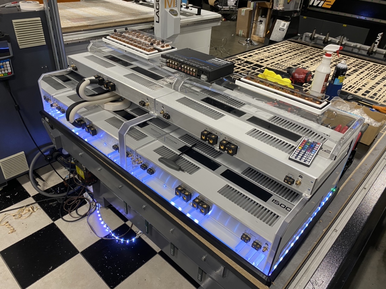

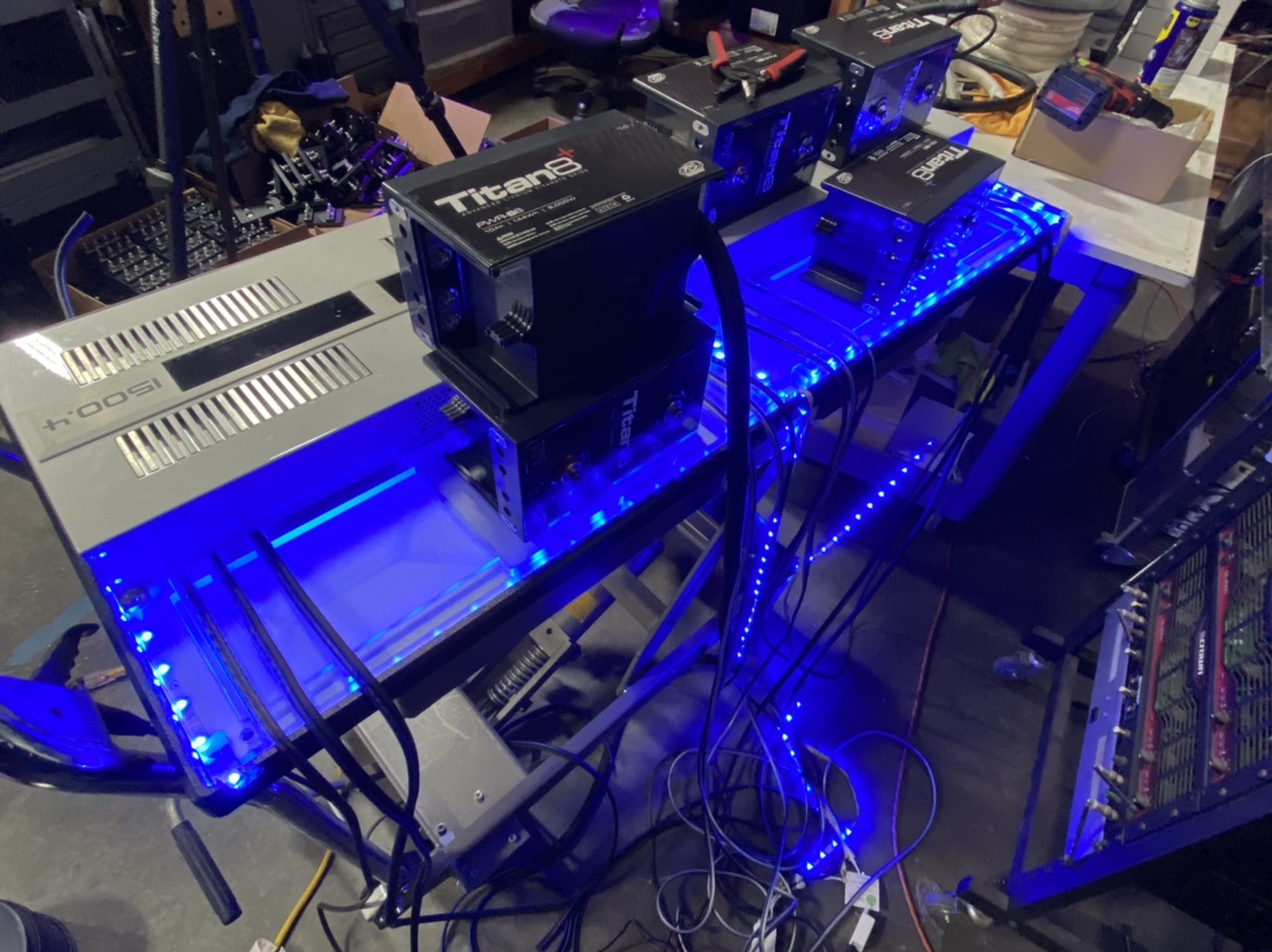

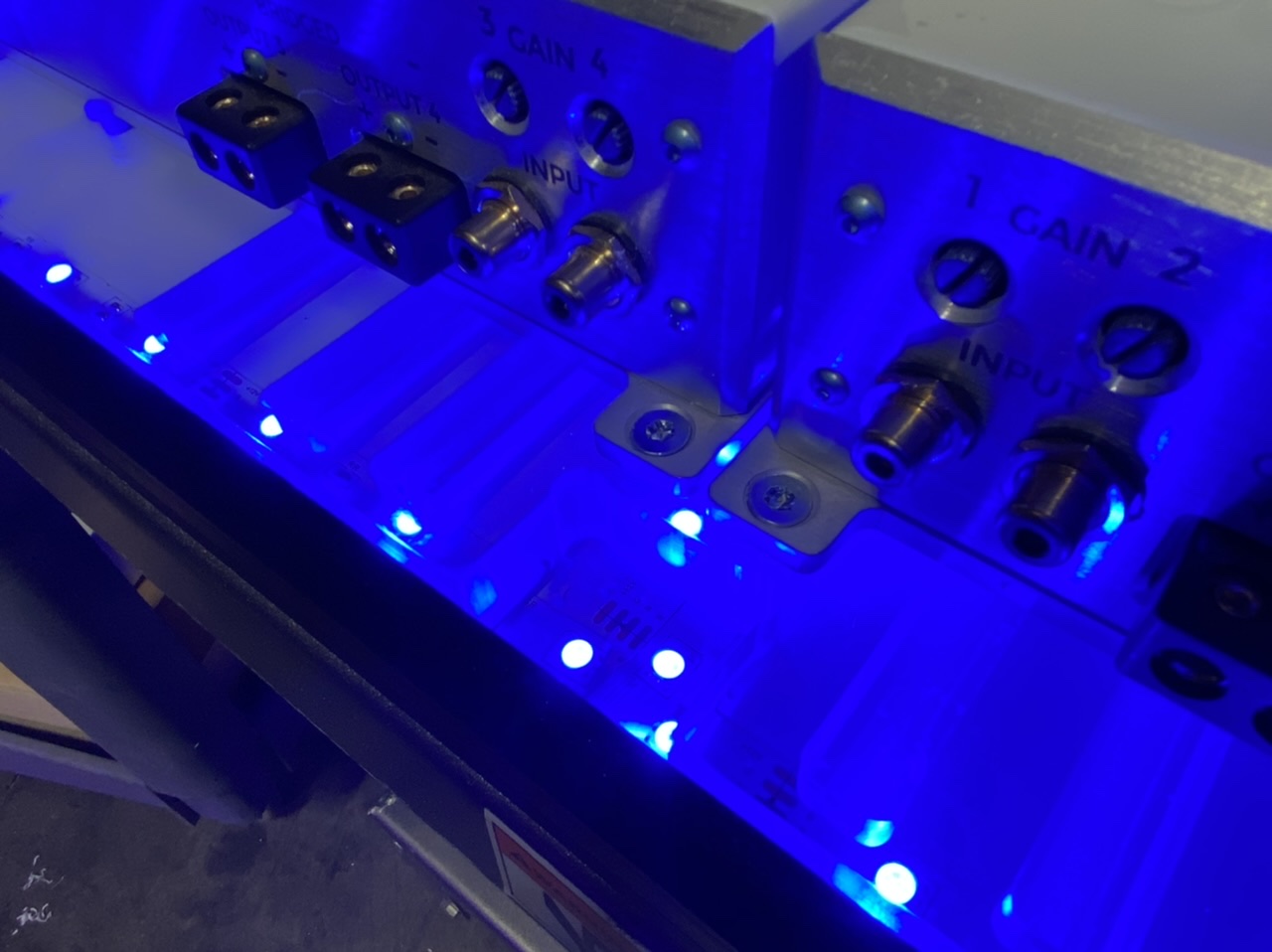

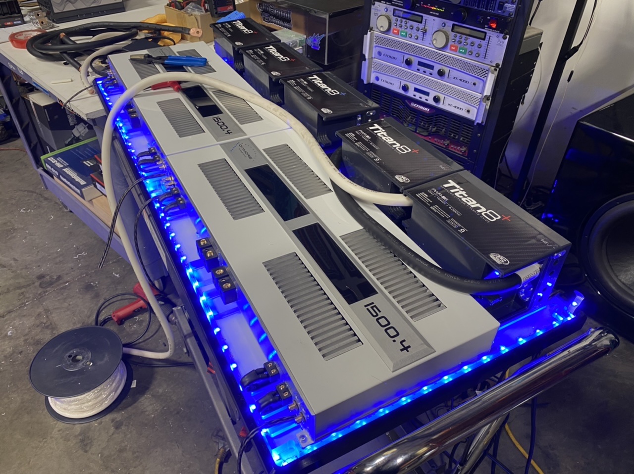

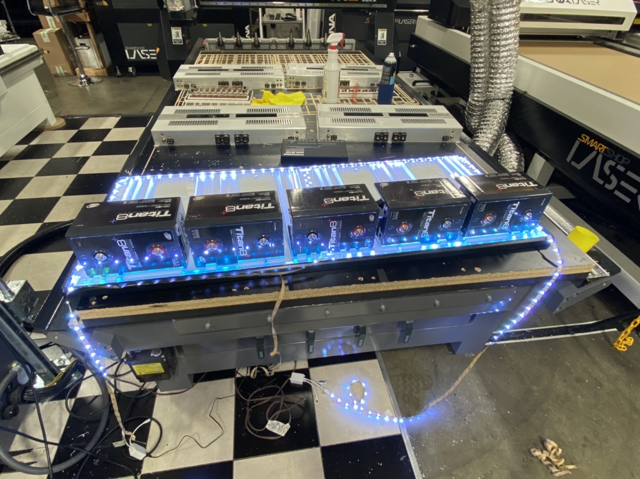

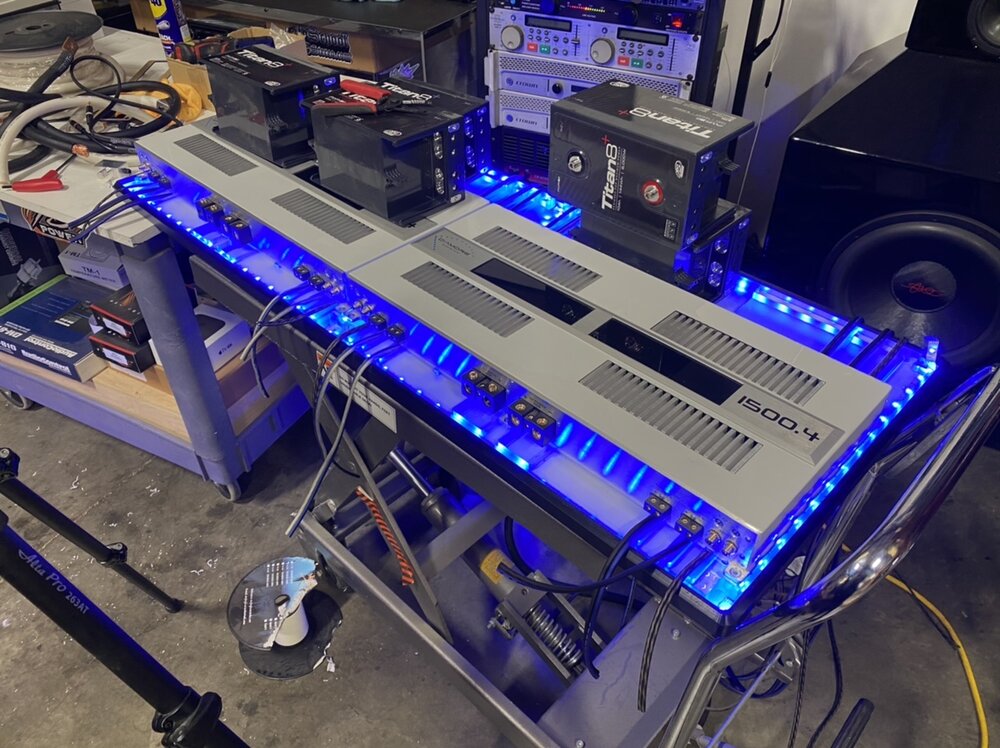

time to drill and tap the acrylic so i can mount the amps down. I used stainless 10-24 with tapered T-20 torx bit head. Fits in the amp like it was meant to be.

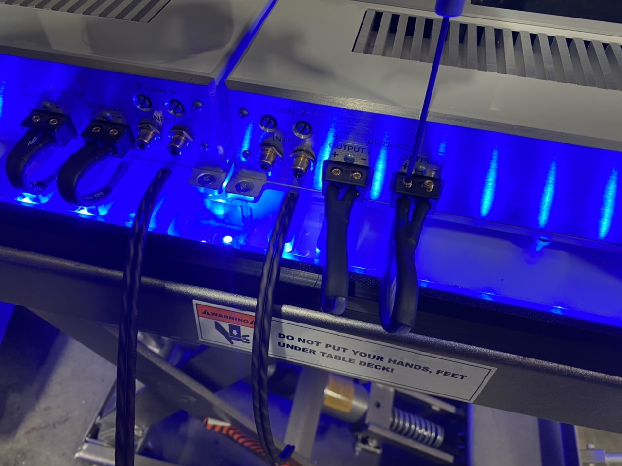

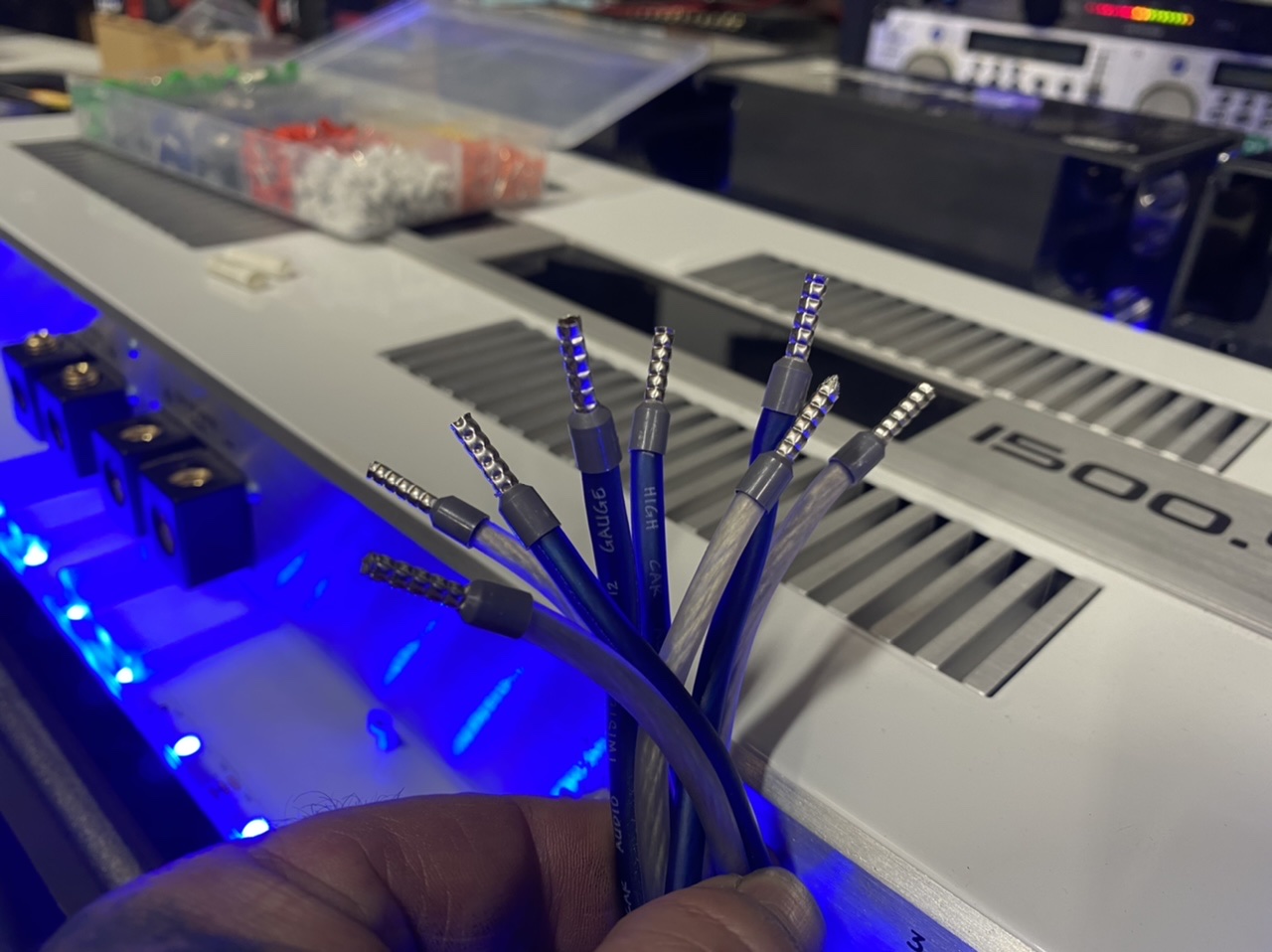

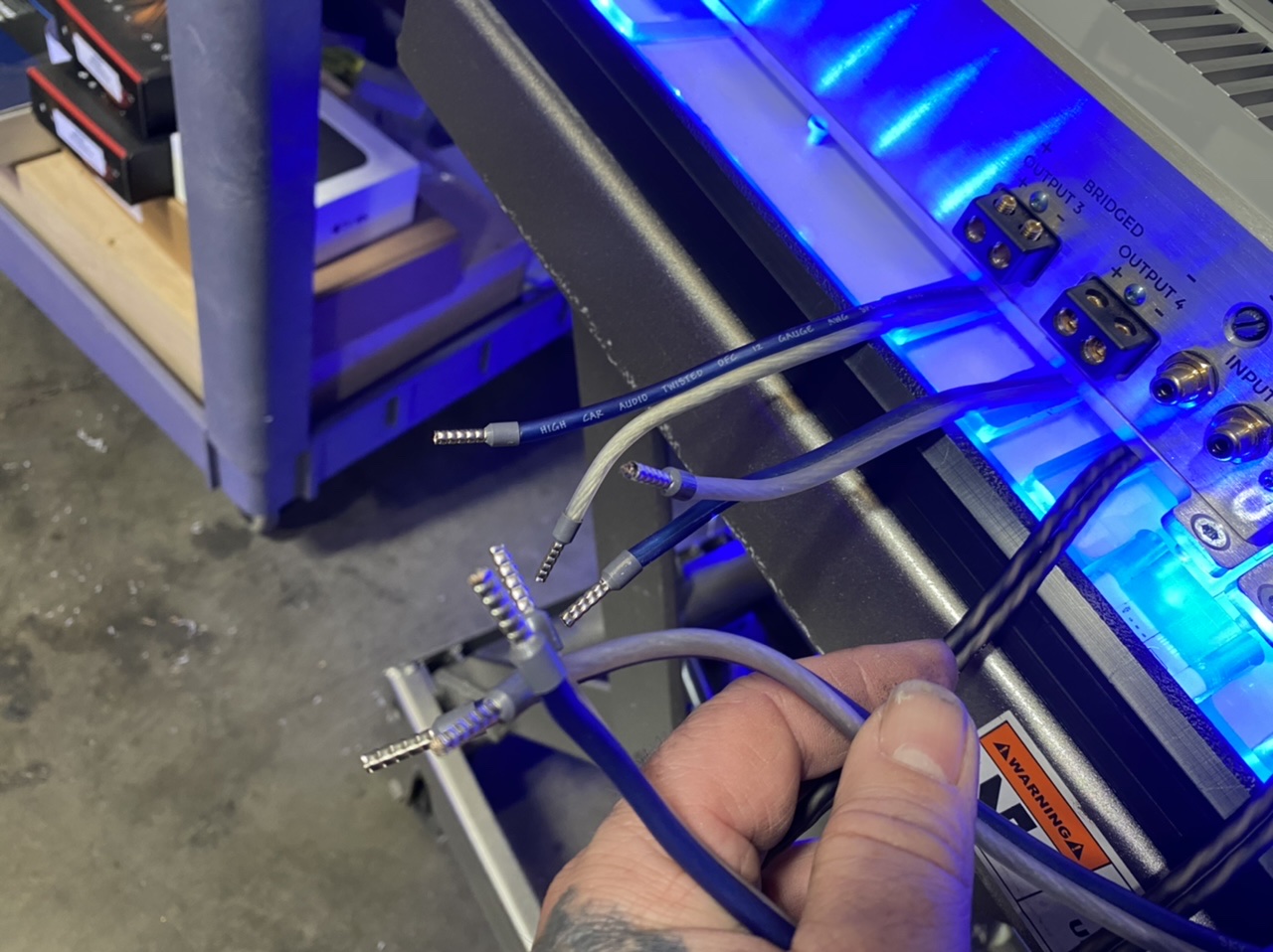

Also started to wire it all up. I used Skyhigh 2/0 black and white OFC power cable, 10 ga OFC speaker cable (midbass) 12ga OFC (mids/highs). I also will be doing 8ga black/white speaker cable up to for the sub amps when i get to that part. I used ferrules on everything and since the sleeves are an ugly color i covered them in heat shrink and tucked them into their guide rails. See pics below! More coming soon!

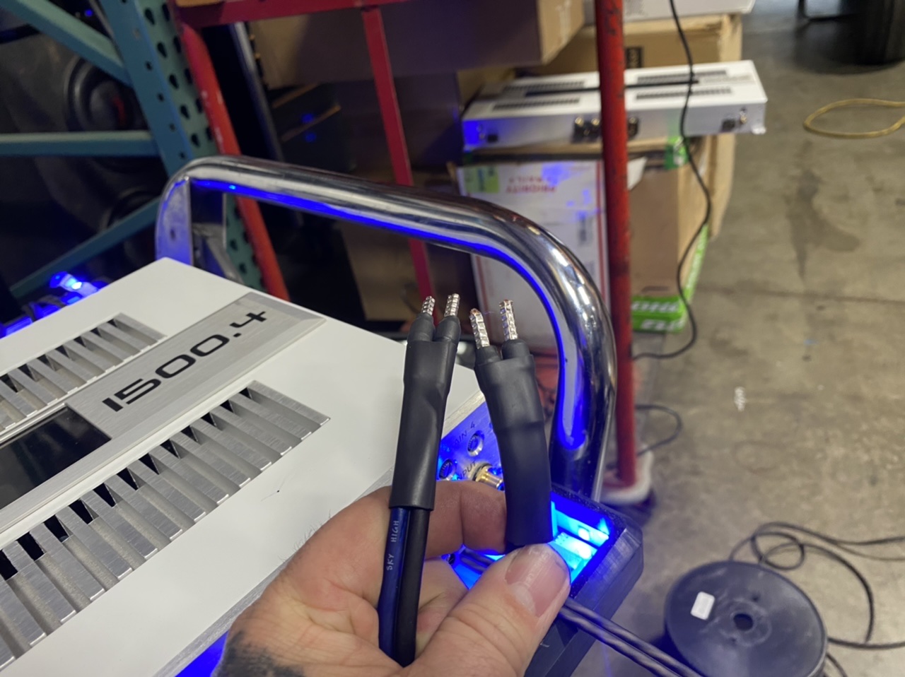

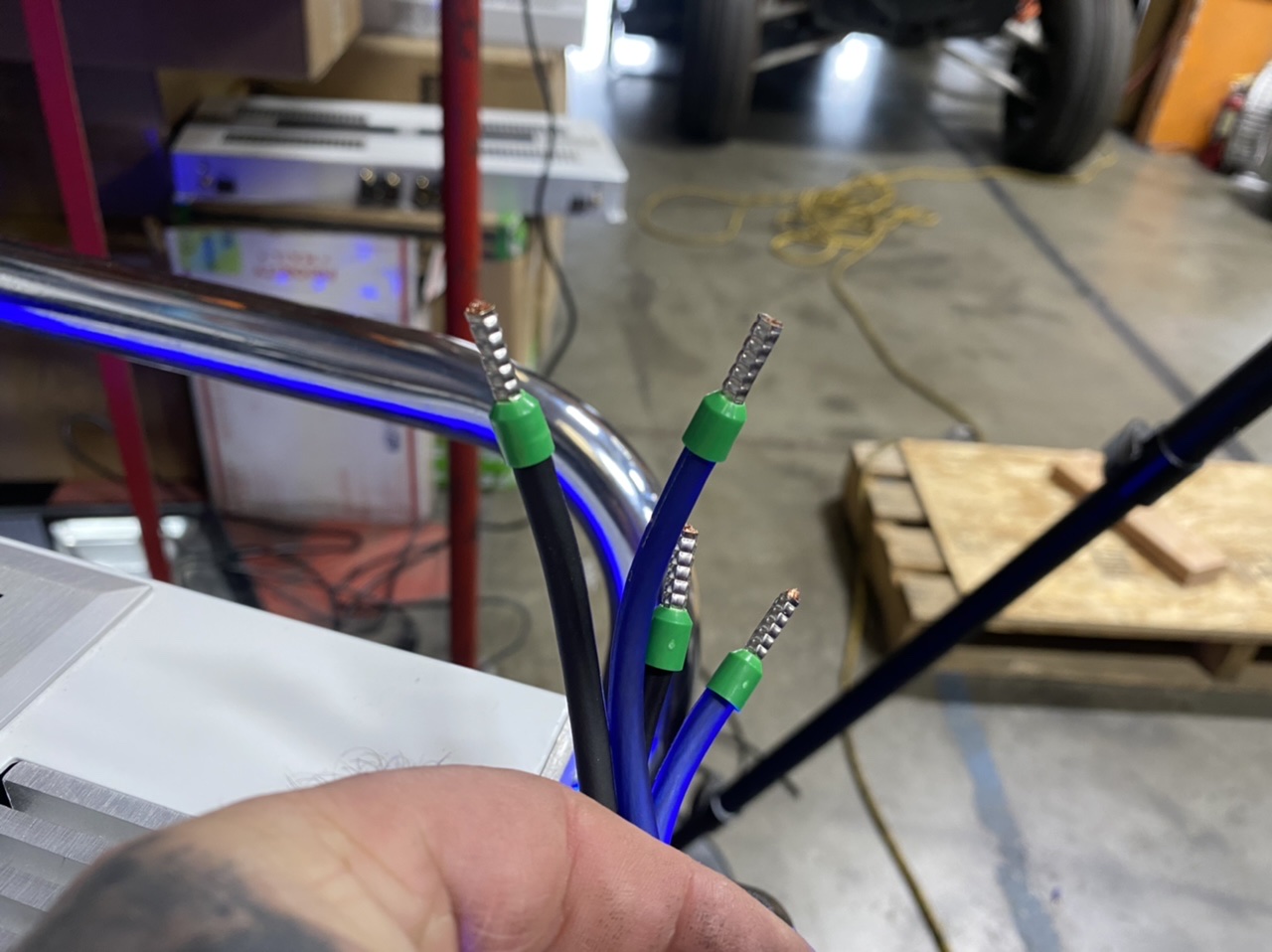

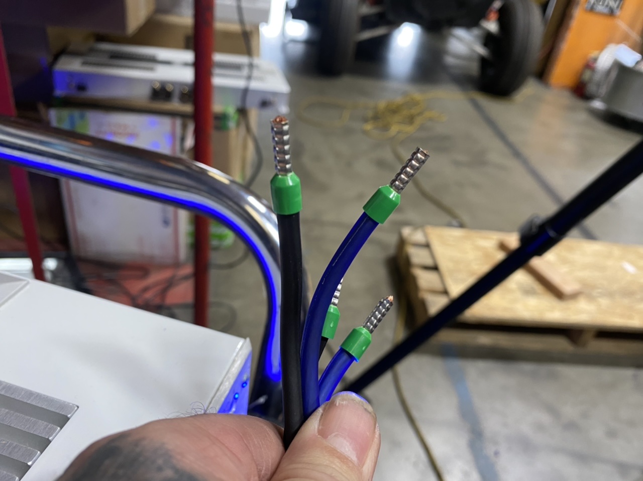

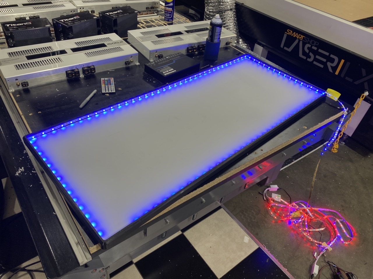

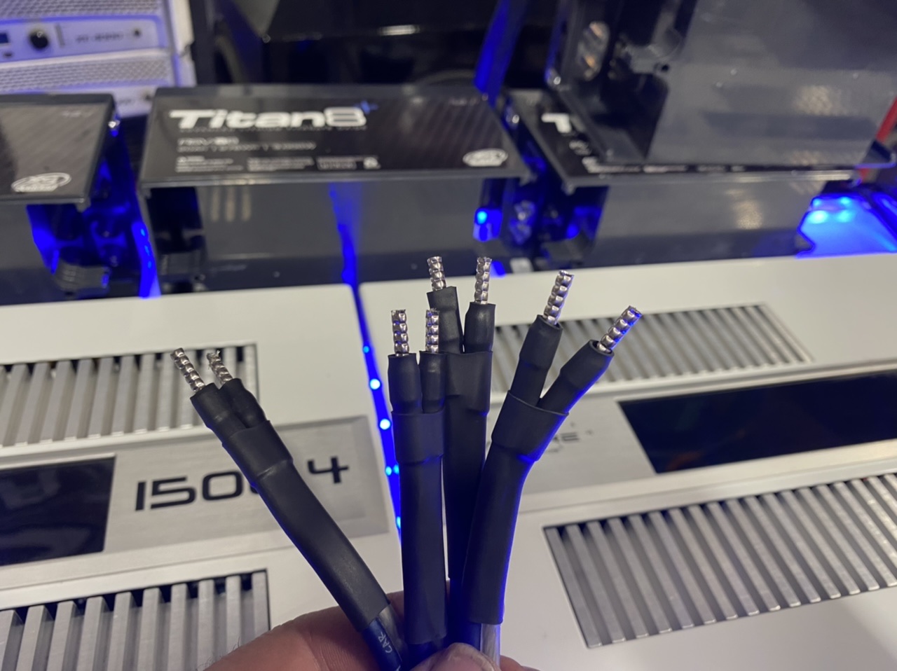

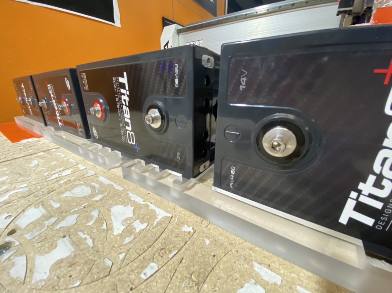

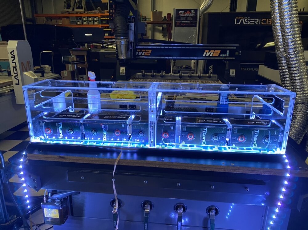

I didn't like the plastic on the wire ferrules so i covered them up in heat shrink and tucked them into their channels (below the amps)
