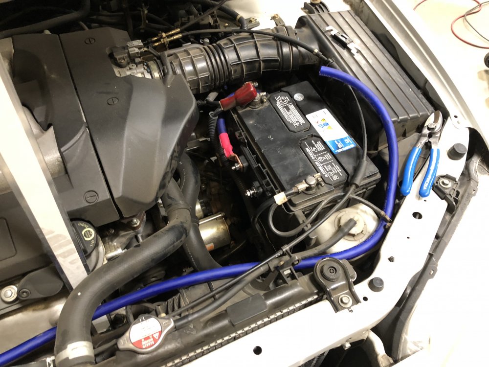

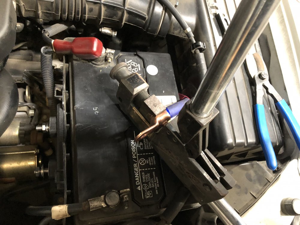

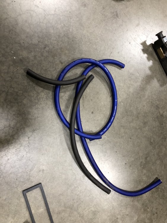

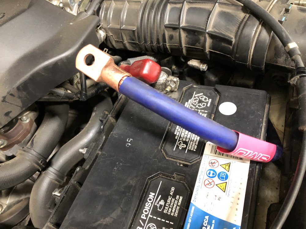

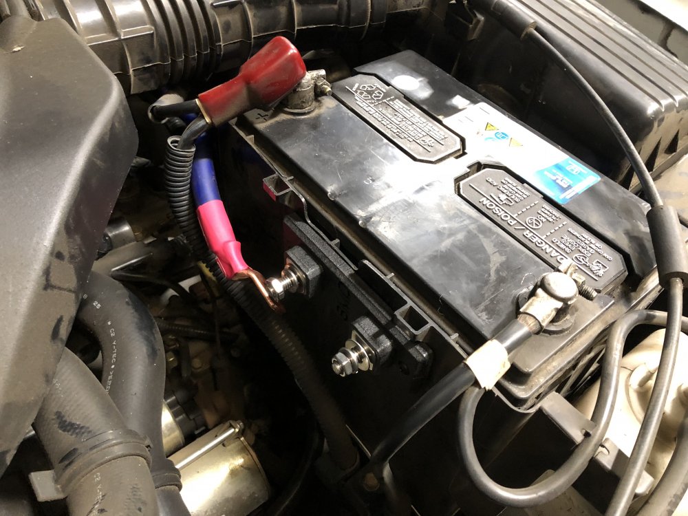

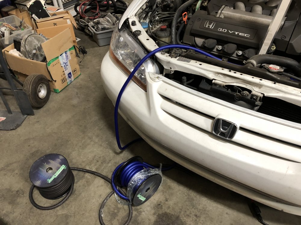

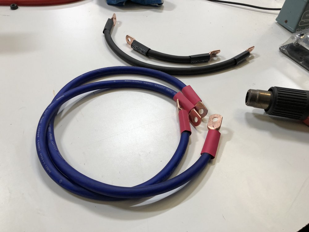

 Of course it always sounds easy but there is more and more to do every time i look.  I just realized i can't half step and just slap a positive on the battery and call it done.  I actually have to do his "big 3" as well. LOL. DAMMIT! :D  Anyhow, i used some Mechman 1/0 OFC.  Probably a little overkill for the power he is getting but at least nobody can say it isn't enough.  Also, i know his stock battery terminals are ugly and.....STOCK. I don't have any at the shop to give him or i would.  This will work for now.
