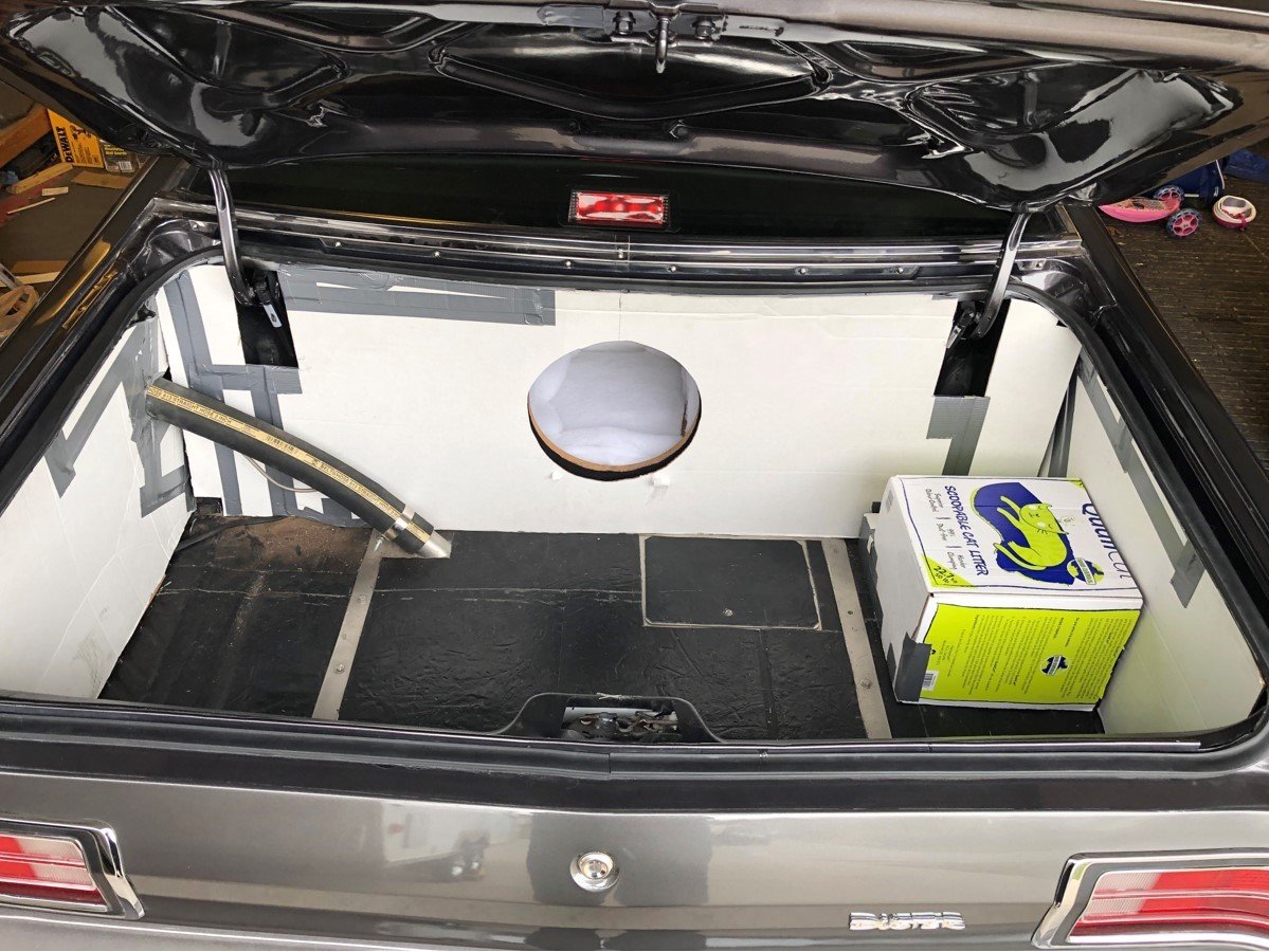

After the Second Skin Damplifier Pro was installed. The Damplifier Pro dropped the sound of the fuel pump to nearly no sound at all.
Here a picture showing the trunk sound deadening completed. It’s totaling covered the floor, wheel wells and one full sheet of Damplifier Pro on each inner quarter panel.  The rear trunk panel was completely done as well.

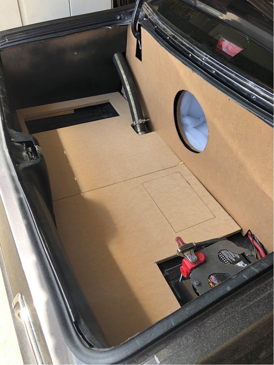

This photo show cardboard being used to make templates for the false wall and also inner quarter walls.  The cat little box is to show a cover for the trunk mounted battery.

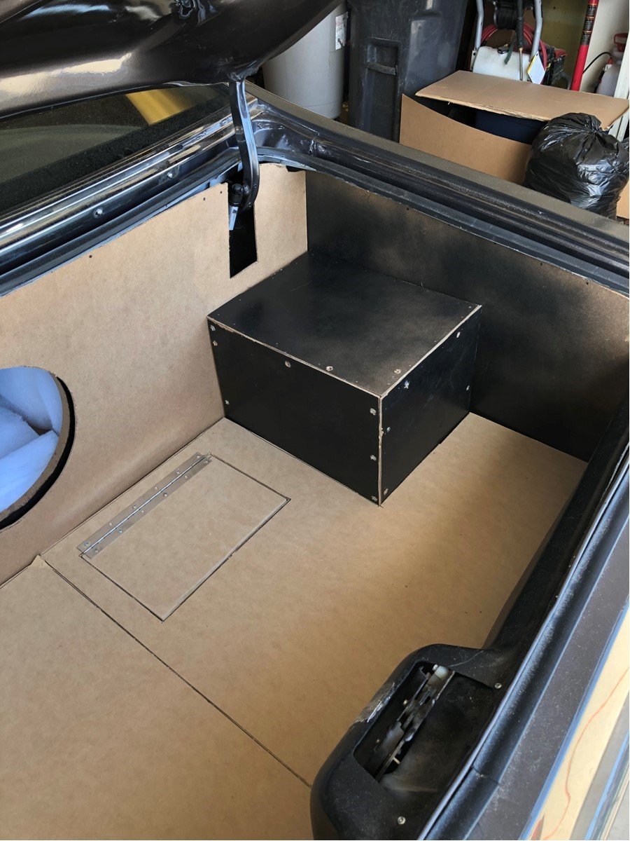

These two photo’s show all the card board templates being replaced with mdf or fiber wood panels.

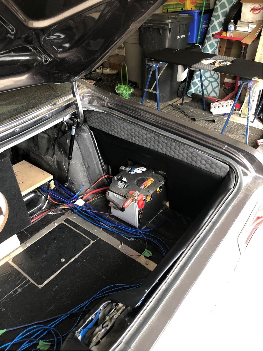

The wiring was completed for the stereo and the sub box was mounted into it’s final resting place.  You can see the battery here which will be covered by the upholstered box.  Behind the battery is the first upholstered panel I completed.

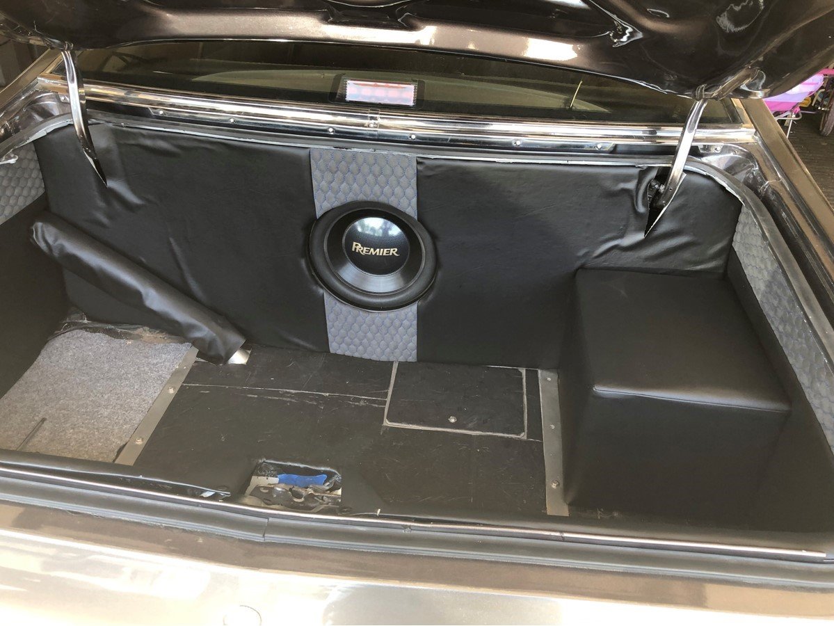

Finishing touches on the Duster Trunk Build.
This picture shows more of the upholstery being completed.  I have to work the wrinkles out with steam.

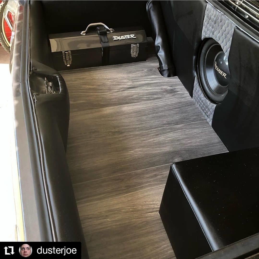

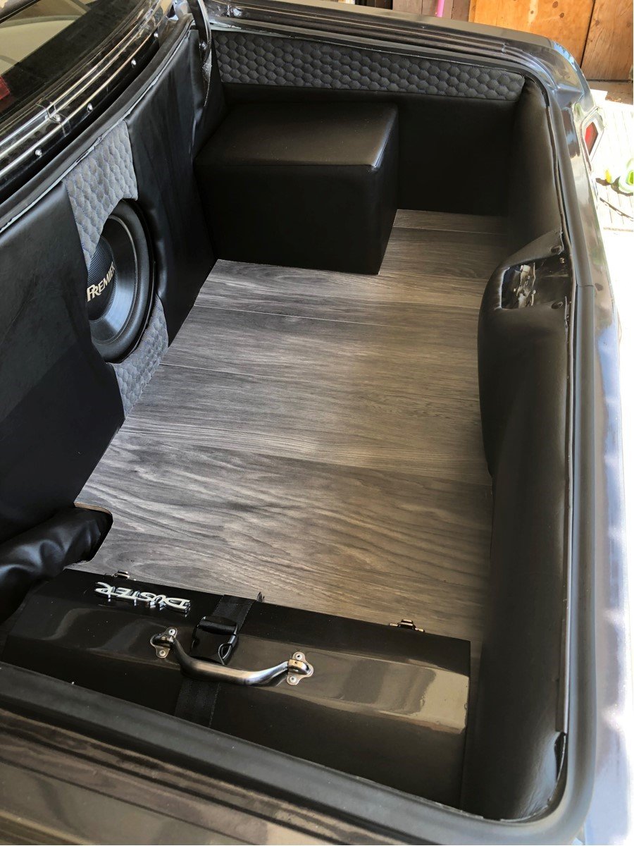

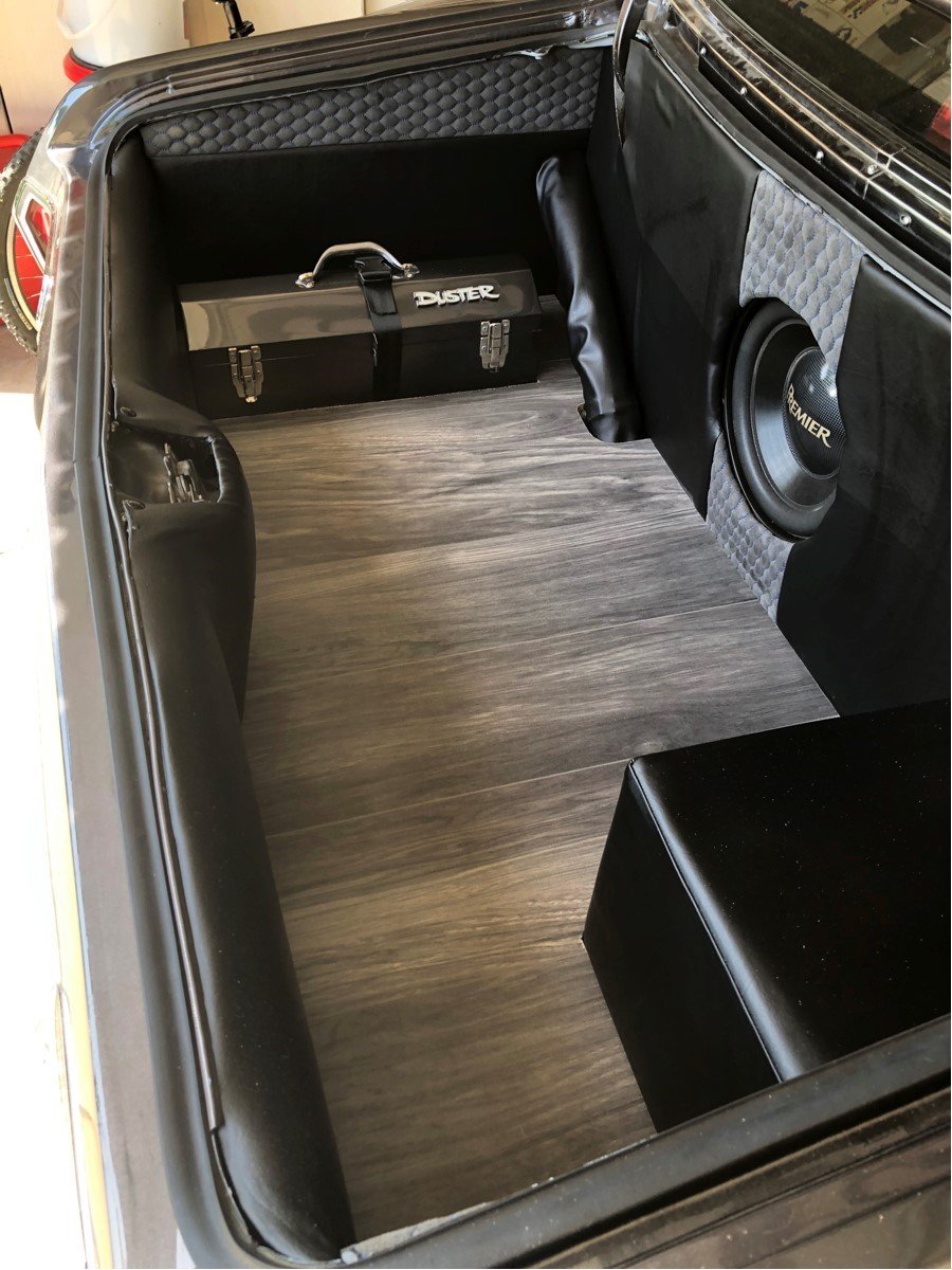

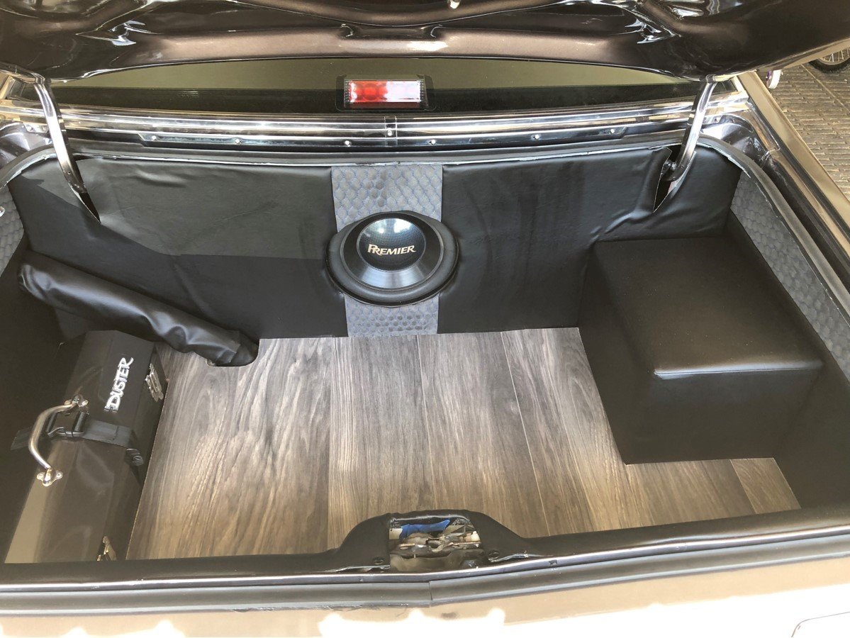

Completed Trunk with matching flooring.
