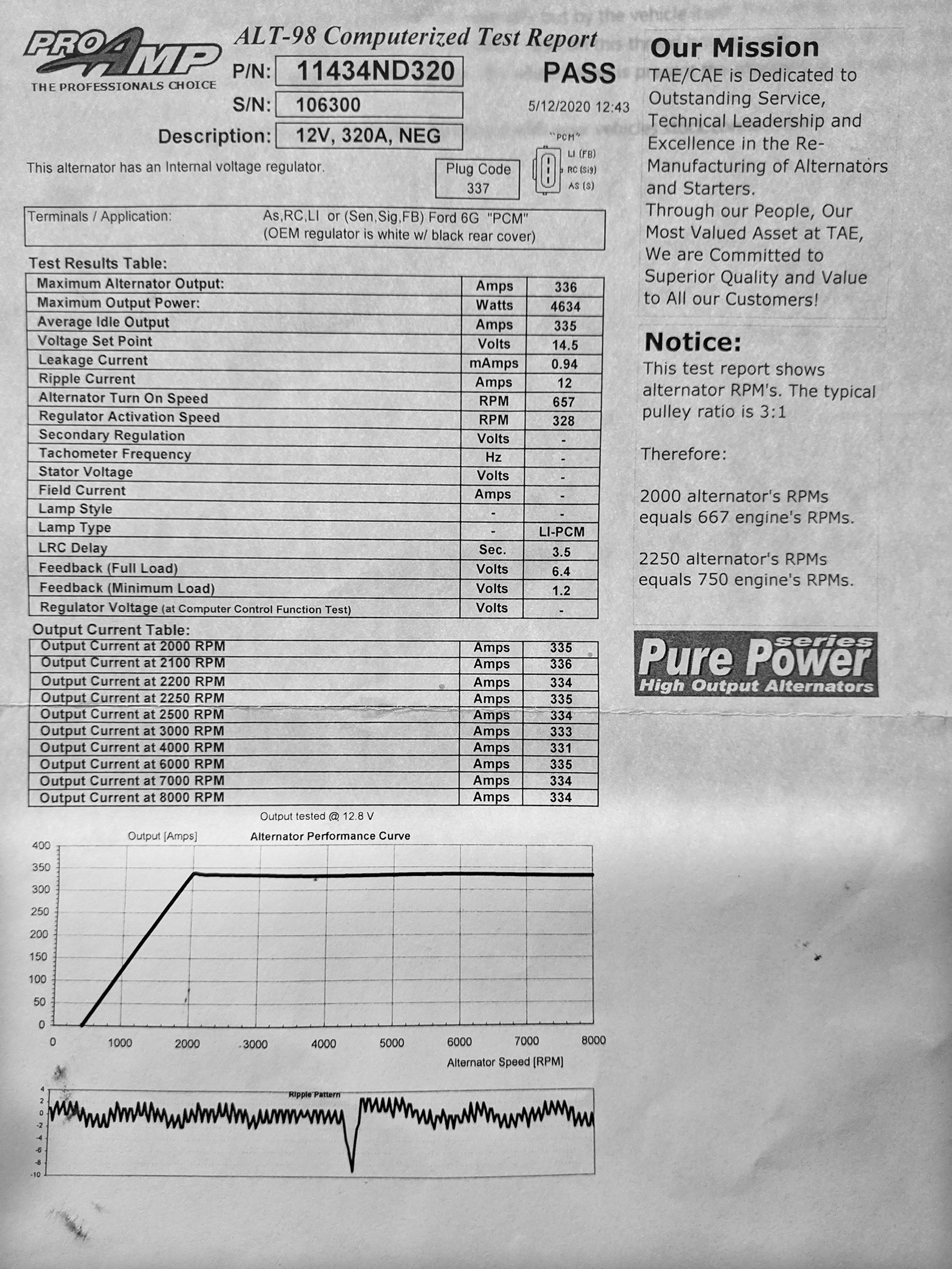

Fish Chris Posted May 21, 2020 Author Report Share Posted May 21, 2020 9 minutes ago, Wishuponasub said: 335 amps at idle is insane. Im not saying its impossible im just saying i have never heard of it. That would be one hell of an alt. Yea, I thought so too ! But I can really tell that's true, as it charges just about as strong at idle, as it does on the freeway. BTW, when I first saw the birth sheet, I was thinking I had to be turning 2000 rpm's in my truck... and even on the freeway, that hardly ever happens, with the truck being geared so low. Then I found out that the alternator itself, because of the smaller pulley, turns at 300% the rate of my my motor RPM's Cool ! Because I typically idle at about 675.... so that is 2000 RPM's for the alt. Link to comment Share on other sites More sharing options...
1point21gigawatts Posted May 21, 2020 Report Share Posted May 21, 2020 20 minutes ago, Fish Chris said: Yea, I thought so too ! But I can really tell that's true, as it charges just about as strong at idle, as it does on the freeway. BTW, when I first saw the birth sheet, I was thinking I had to be turning 2000 rpm's in my truck... and even on the freeway, that hardly ever happens, with the truck being geared so low. Then I found out that the alternator itself, because of the smaller pulley, turns at 300% the rate of my my motor RPM's Cool ! Because I typically idle at about 675.... so that is 2000 RPM's for the alt. I would clamp it to see. I bet you it’s not doing them numbers. I’m not talking shit by any means, I’m just sayin. Just like power bastards says their alternators put out full amperage at 1200 rpms. That’s a negative on that one. Get a clamp meter and set it to dc current and put it on the runs coming from the alternator to the battery and you and buddy find out what that alternator really does. “How can we help you?” “And don’t forget to tell them that the customer isn’t always right.” Link to comment Share on other sites More sharing options...

Dragonsyph Posted May 22, 2020 Report Share Posted May 22, 2020 So it puts out 335 at any speed and it’s max output is 336? Seems pretty fishy to me. ♦ Sundown NSV4 18" + Sundown SALT-4 Baby ♦ MechMan Elite 370a + XS3100 - XP3000 ♦ SHCA 1/0 OFC(blue) + SMD Fuse Holders(blue) ♦ Pioneer AVH-2440NEX + SHCA Pro RCA Link to comment Share on other sites More sharing options...
1point21gigawatts Posted May 22, 2020 Report Share Posted May 22, 2020 7 minutes ago, Dragonsyph said: Your graph only shows 336 amps at 2000rpm, that’s not idle, it shows about 100amps at 800 rpm which is pretty bad or am I reading this wrong? It appears to be about that on the graph. “How can we help you?” “And don’t forget to tell them that the customer isn’t always right.” Link to comment Share on other sites More sharing options...
fishchris1 Posted May 22, 2020 Report Share Posted May 22, 2020 9 minutes ago, Dragonsyph said: Your graph only shows 336 amps at 2000rpm, that’s not idle, it shows about 100amps at 800 rpm which is pretty bad or am I reading this wrong? Your making the same mistake I first did. This alternator is equipped with a smaller pulley, so that 2000 rpm's of the alternator, is achieved with 667rpm's of the motor. Thankfully, as I almost never turn 2000 rpm's in my truck, other than when I'm romping on it, to get on the freeway, or to pass someone. If you look close, there is a note on that page saying alternator rpm's are typically 3:1 to motor RPM's. Link to comment Share on other sites More sharing options...
