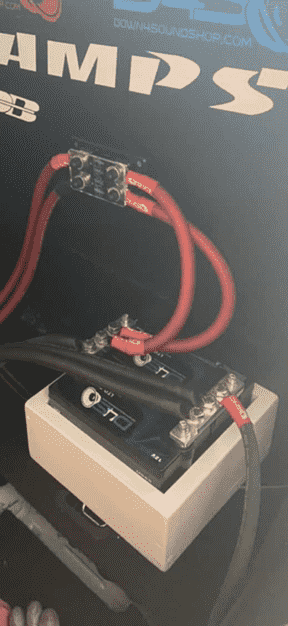

Noobie strikes again ok so guys I have my bass stage all set but I ran out of terminals on my bussbars for my multichannel amp. Y’all think I could just attach the 4 gauge lugs I’ll be using for my multichannel to the small bolts? (Picture below for reference) dying to get my doors done! I can’t hear a thing really besides bass because the subs are so loud!
