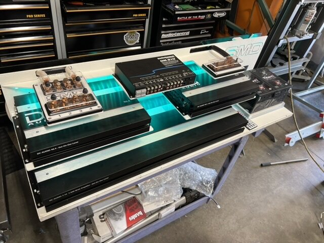

Kay Kay’s GMC Yukon - 2 24” subwoofers, amp rack started (all steel)

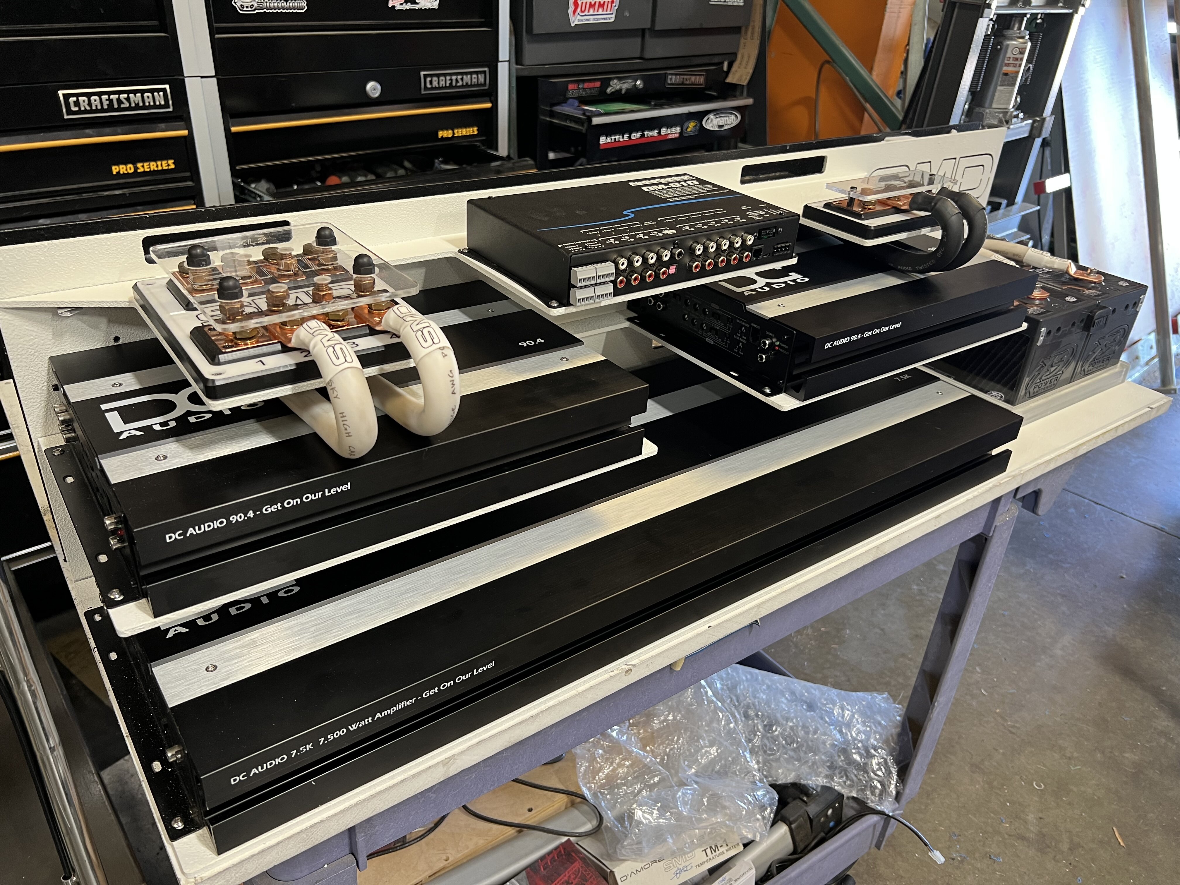

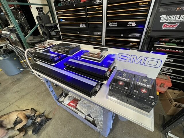

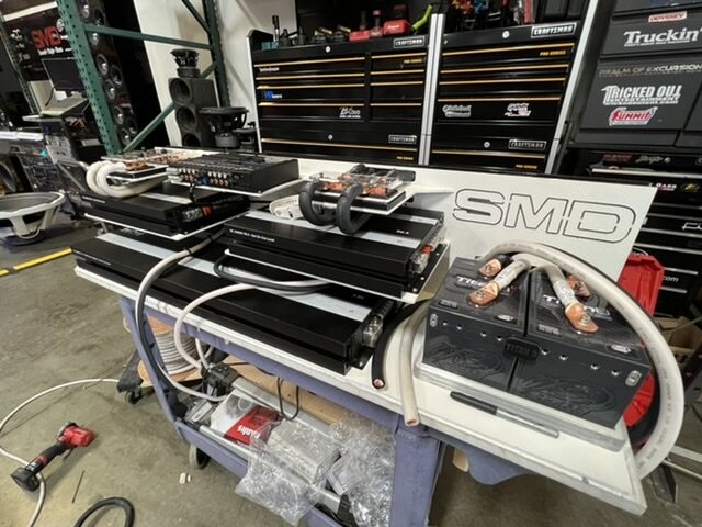

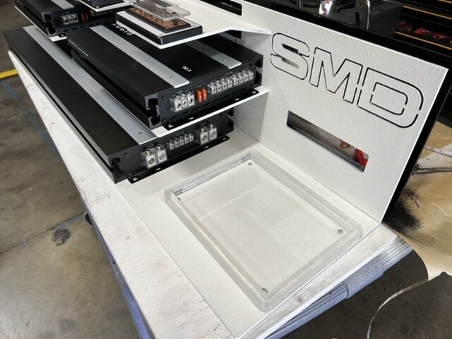

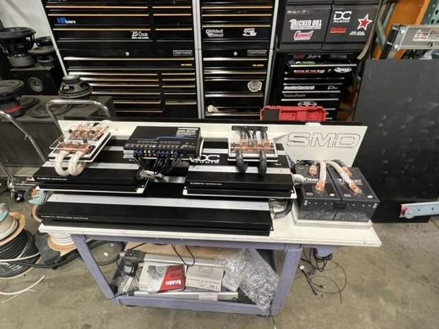

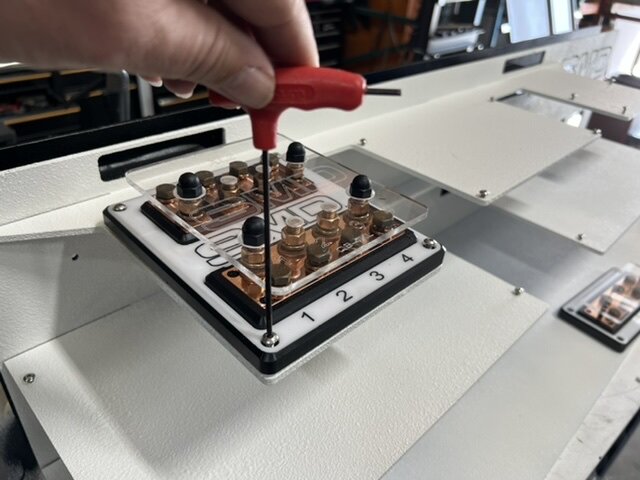

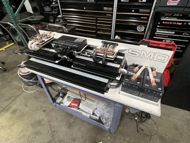

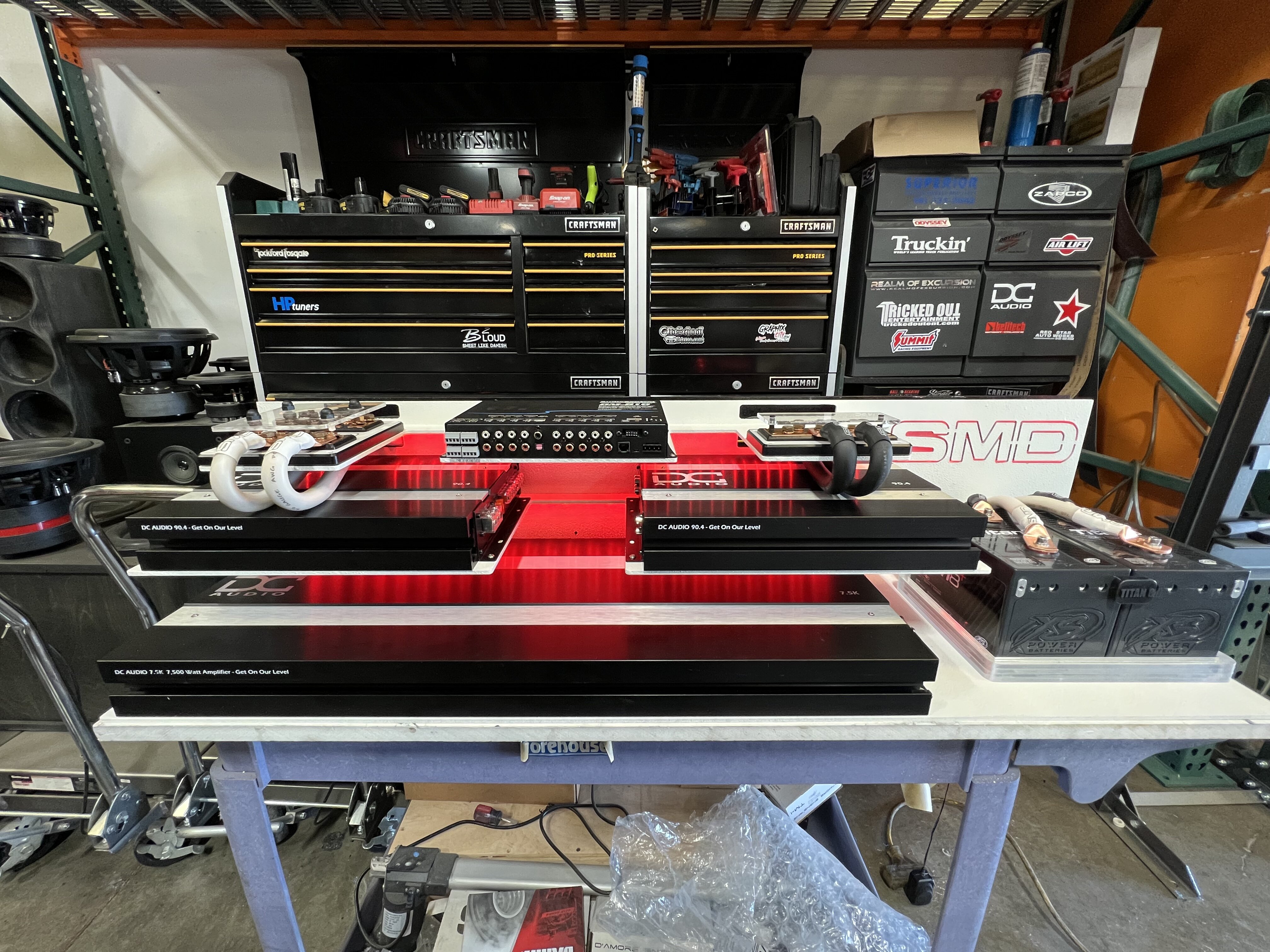

3/16" Steel plate with #8x32 allenhead stainless bolts.  Everything drilled and tapped to accommodate.

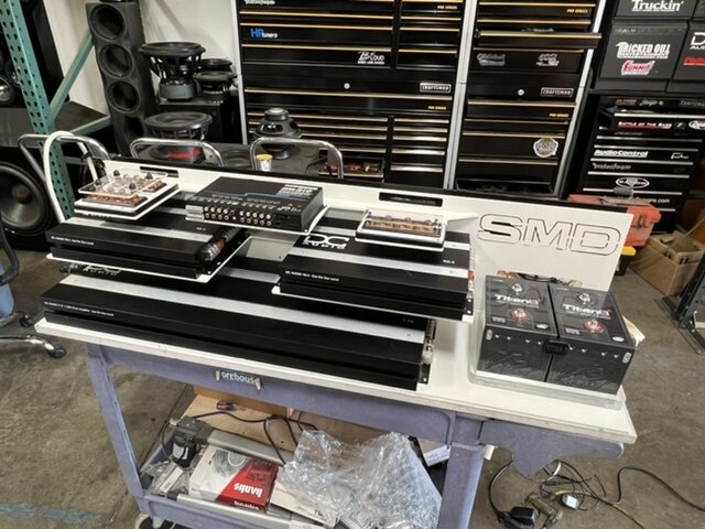

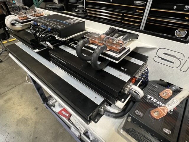

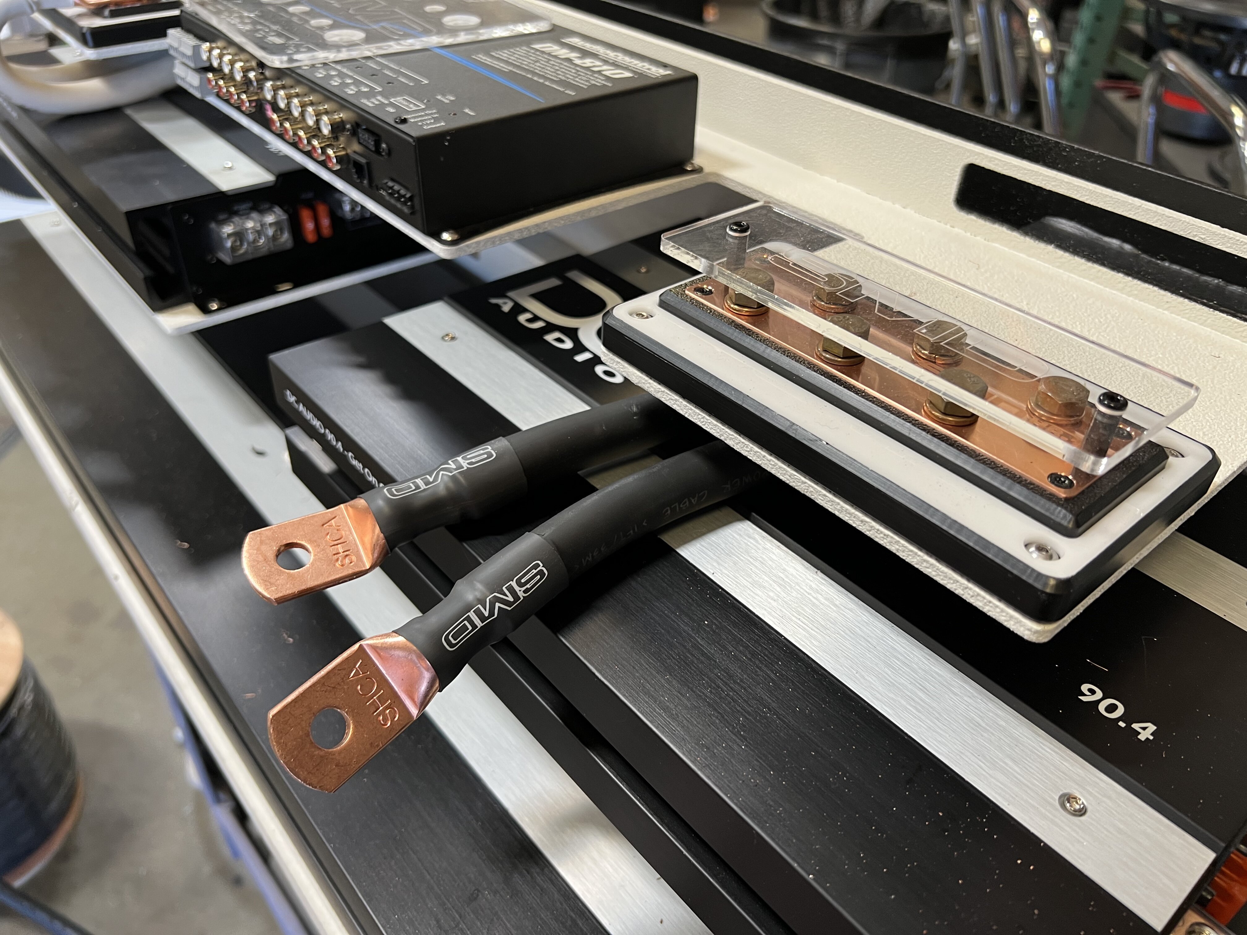

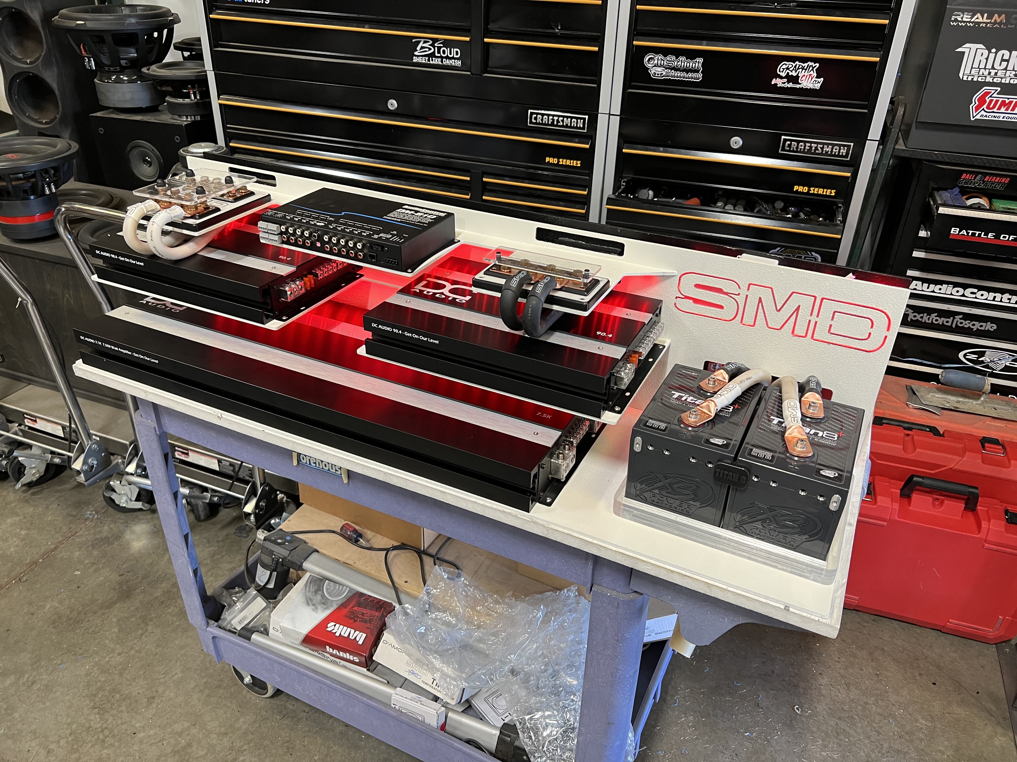

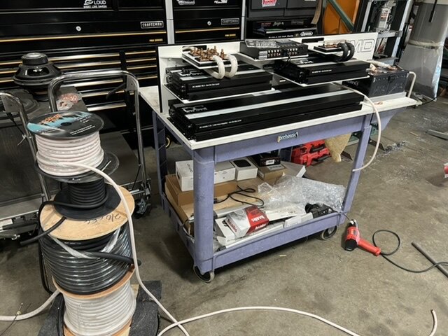

Time to run some Skyhigh Audio 2/0 positive/negative from the battery's to the blocks.  The second wall in the rack is to run the wires nice and clean.  They will still be seen but it will be a lot cleaner disappearing into the back and popping out where they go,

Well that turned out great. Made a ton of stuff fit wicked nice. Good shit per usual.
EDIT- man, ive used a SHIT TON, of that Raptor liner, but only in the dual part kit. Never used the aerosol can. Looks like it did great.
Ive sprayed fucking everything with raptor liner. I love it. I just sprayed my rock sliders with it. I love that stuff.
Also, for anyone that knows, what are the silver, threaded holes on the sides of the Titan8's ? Im way unfamiliar.

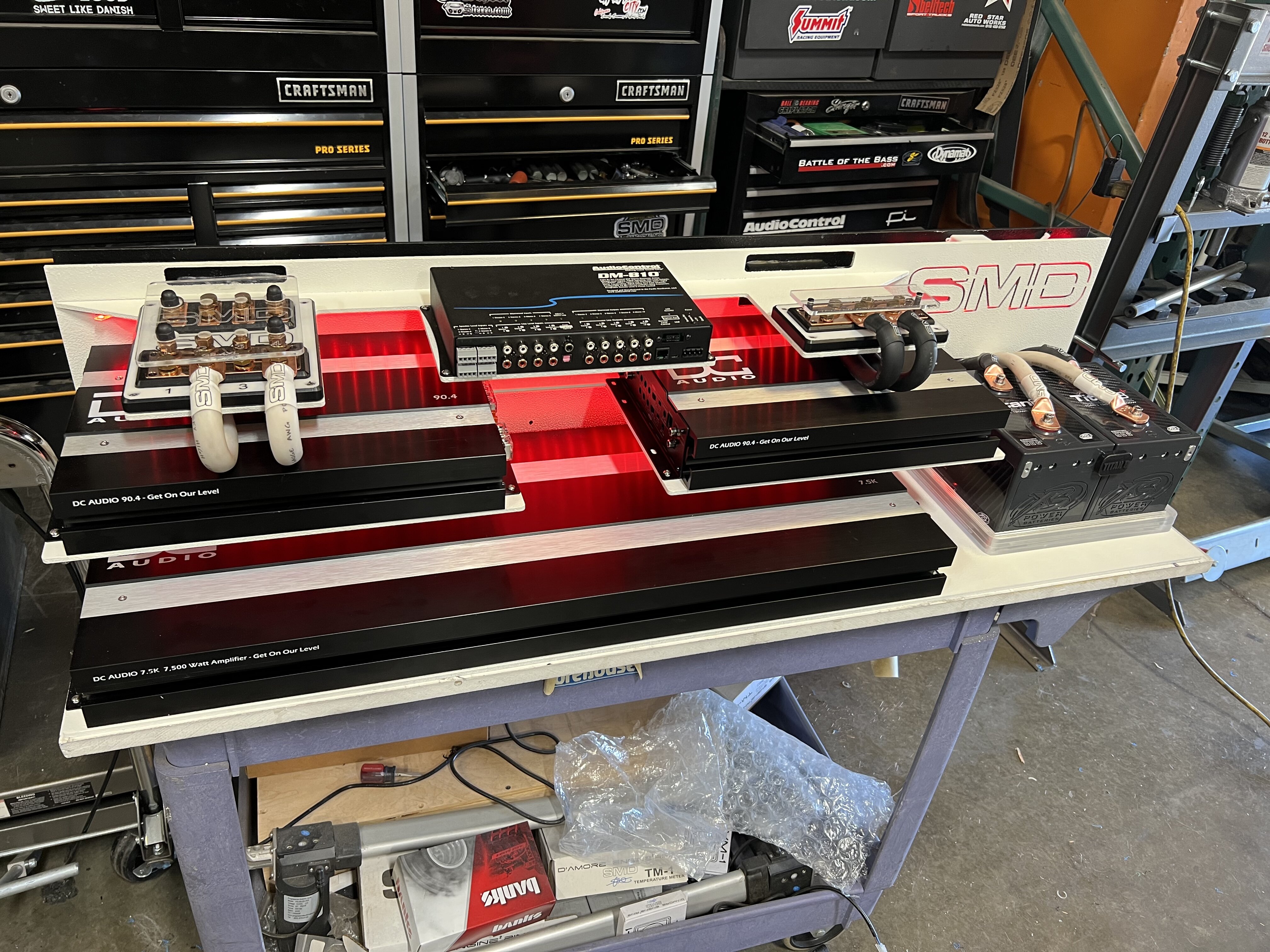

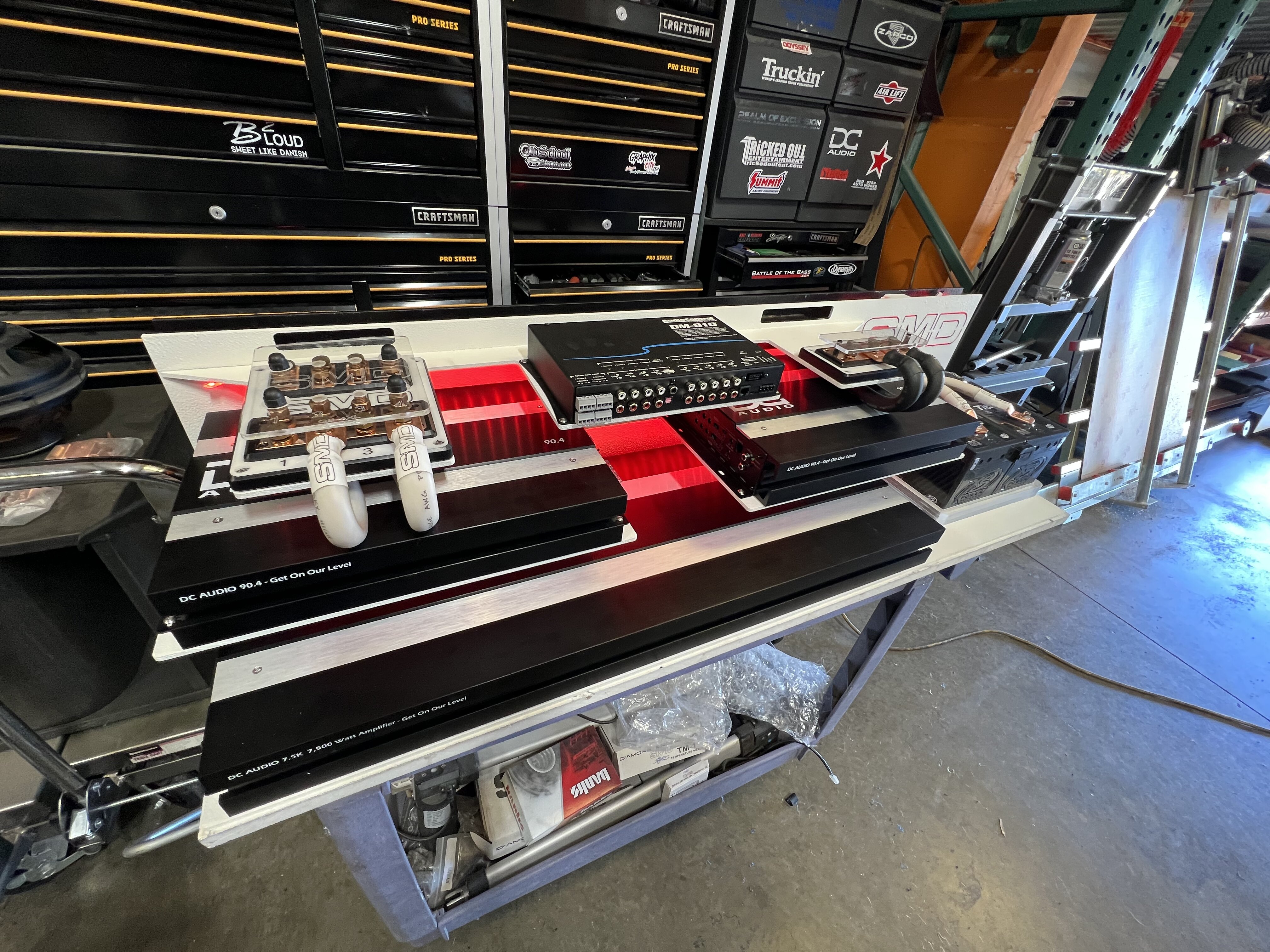

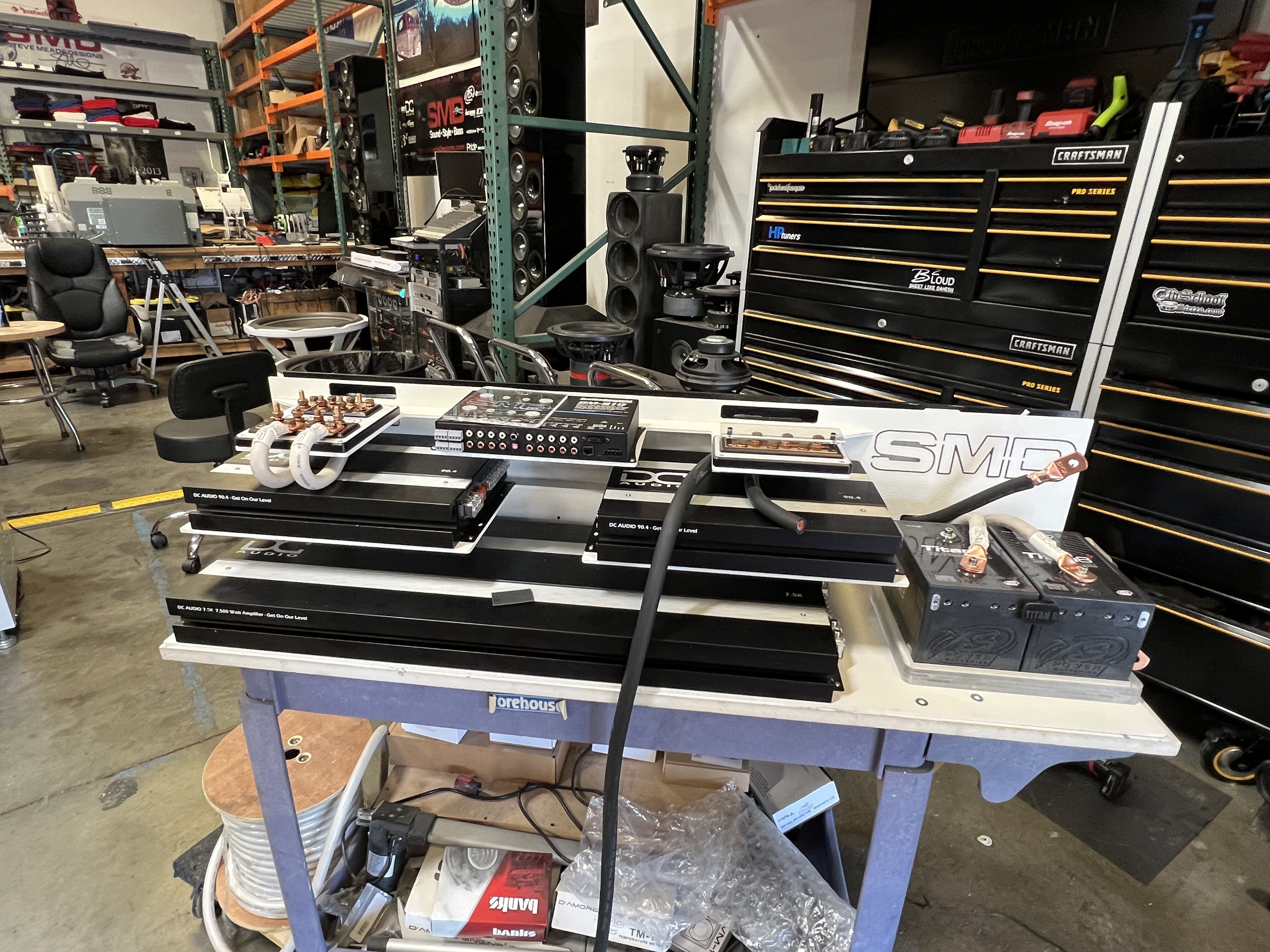

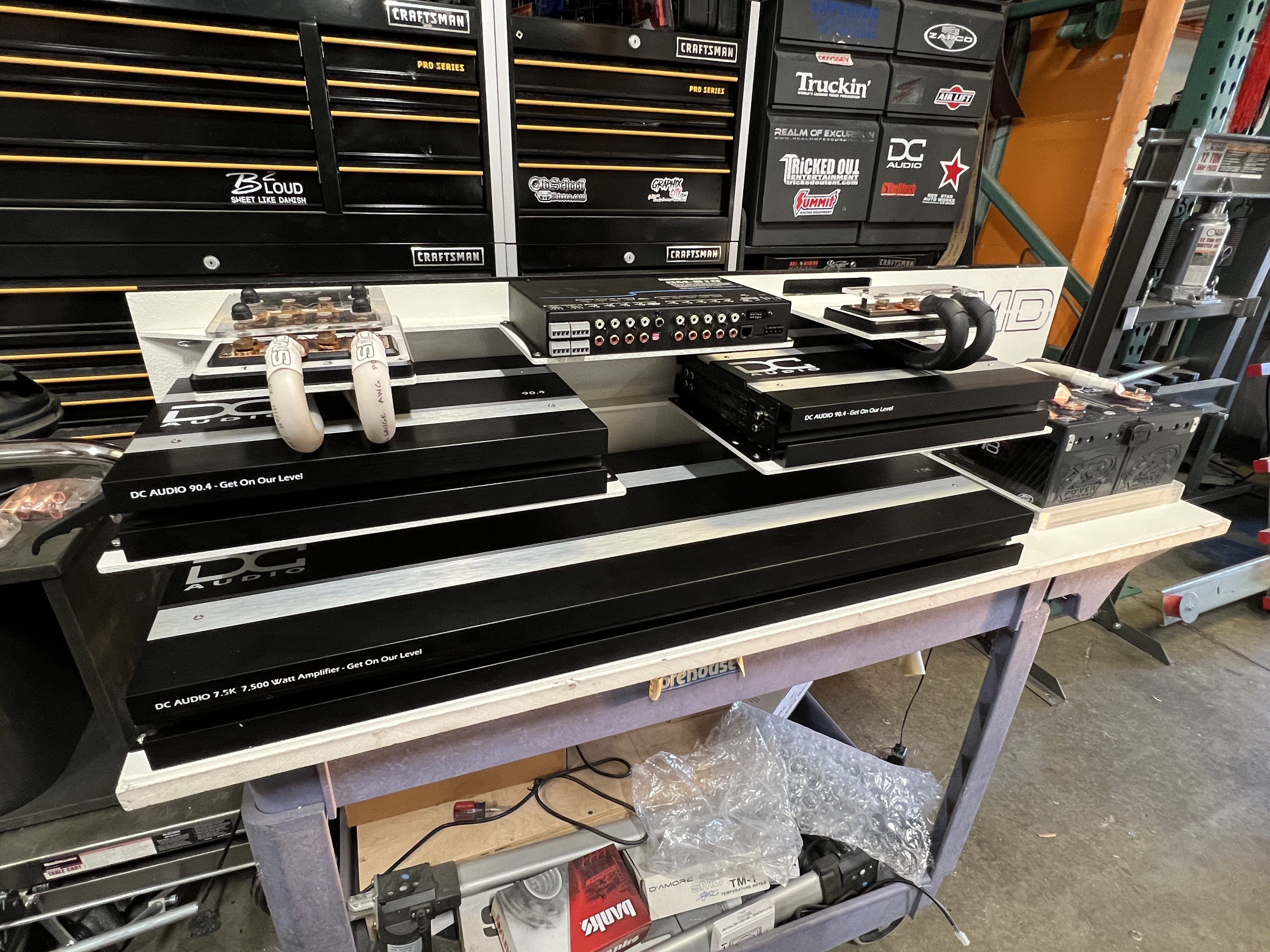

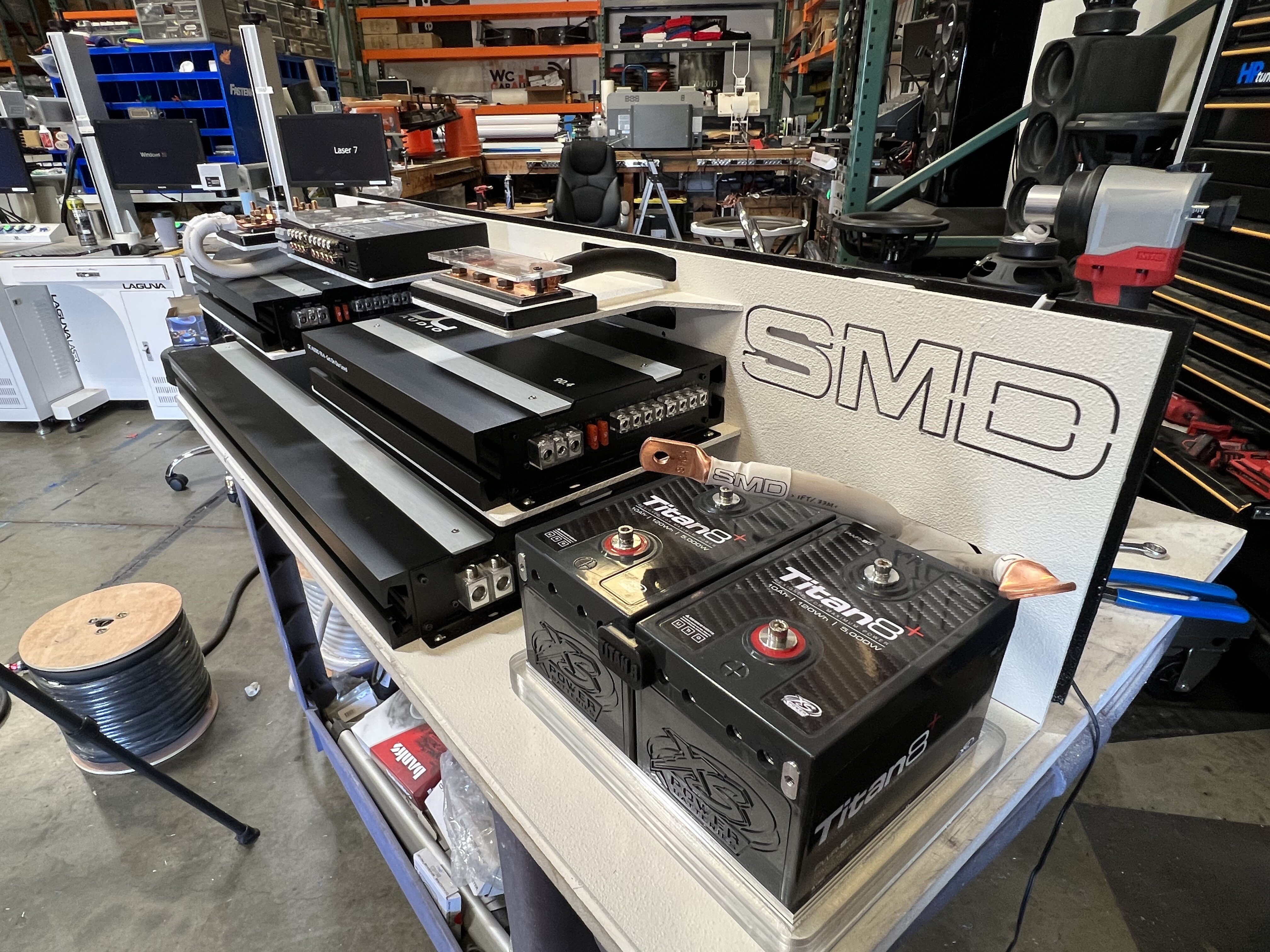

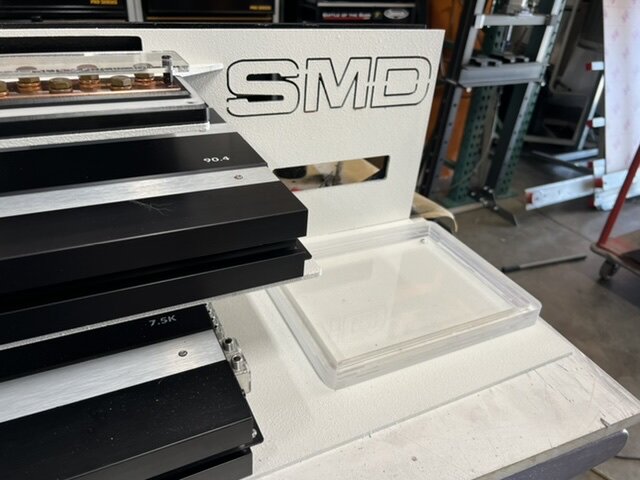

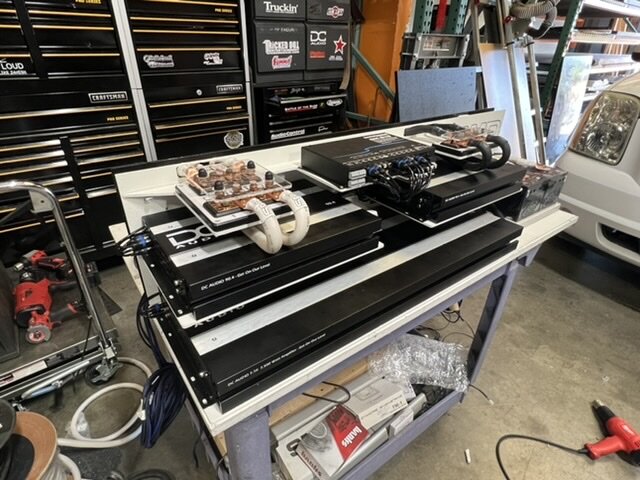

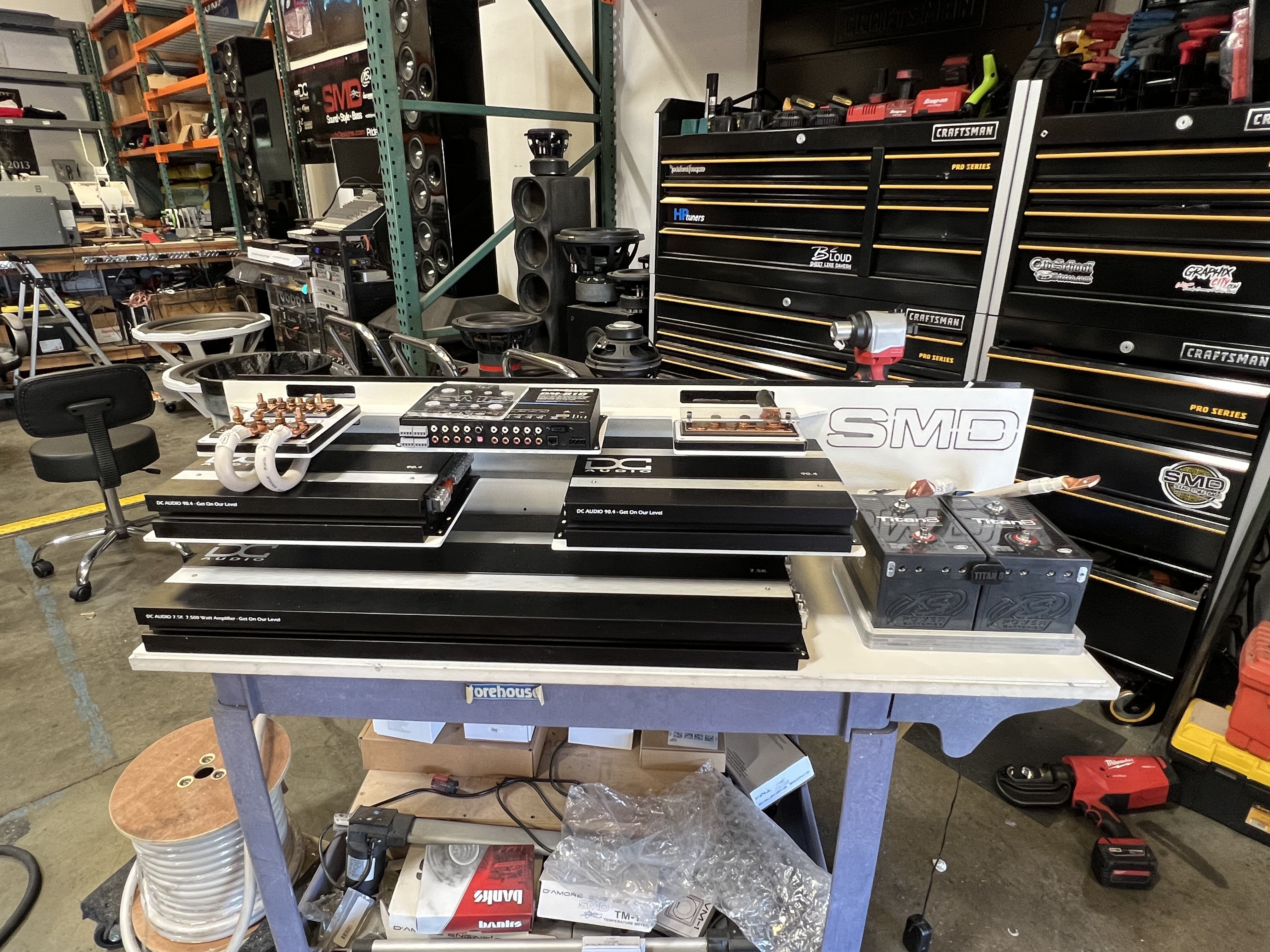

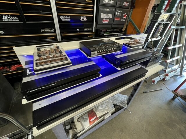

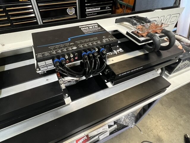

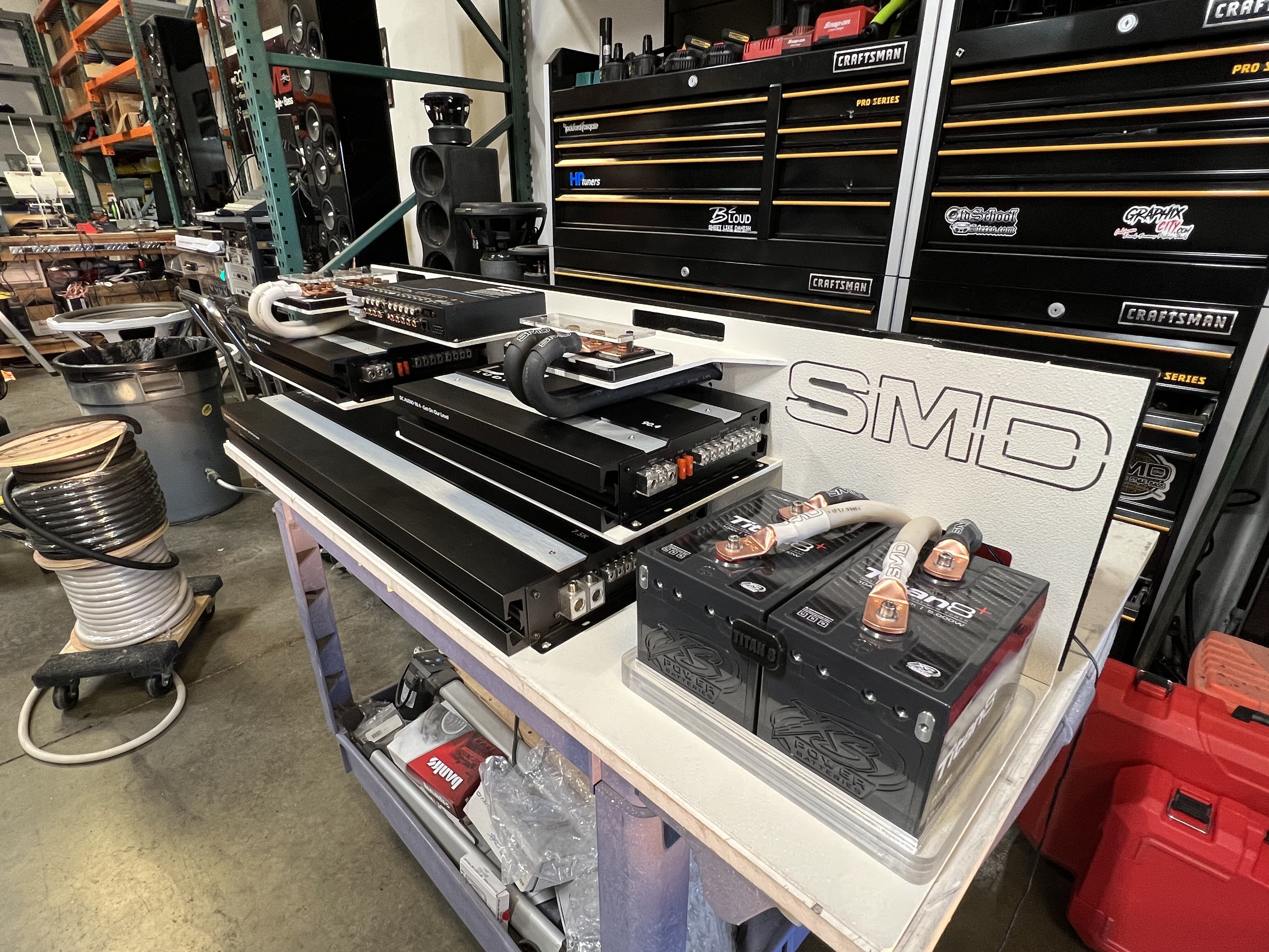

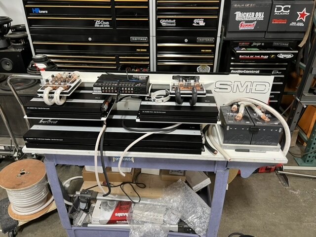

wiring the rack. Sneak peak. there are 2 4 channels. First four channel amp is left/right tweeters on channels 1 and 2 and 3" mids (left/right) on channels 3 and 4. Second four channel amp is Right and left 6.5's on channel 1, 2, 3 and 4. In other words, each 6.5 has it's own dedicated channel. Of course the 7.5k is on the @official_sundown_audio 24's... skyhigh 2/0, 4ga, 10ga and 16ga OFC wire used. SHCA Rca's too. @4xspower Titan 8 Lithium delivering the juice. New video coming soon!
those are more terminals.  You can link these together. If you look i bridged them and they are bolted together :)

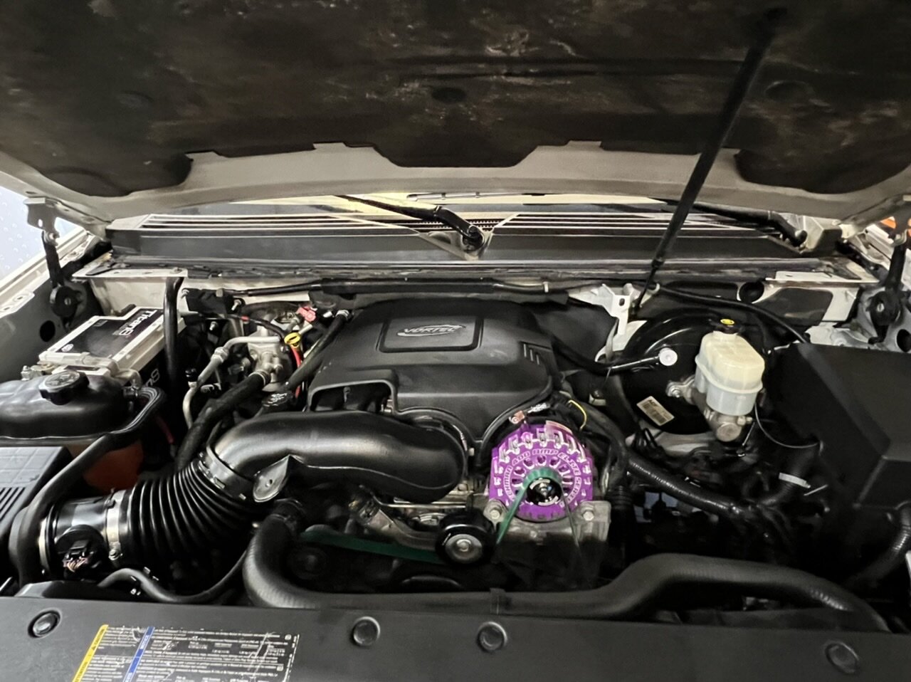

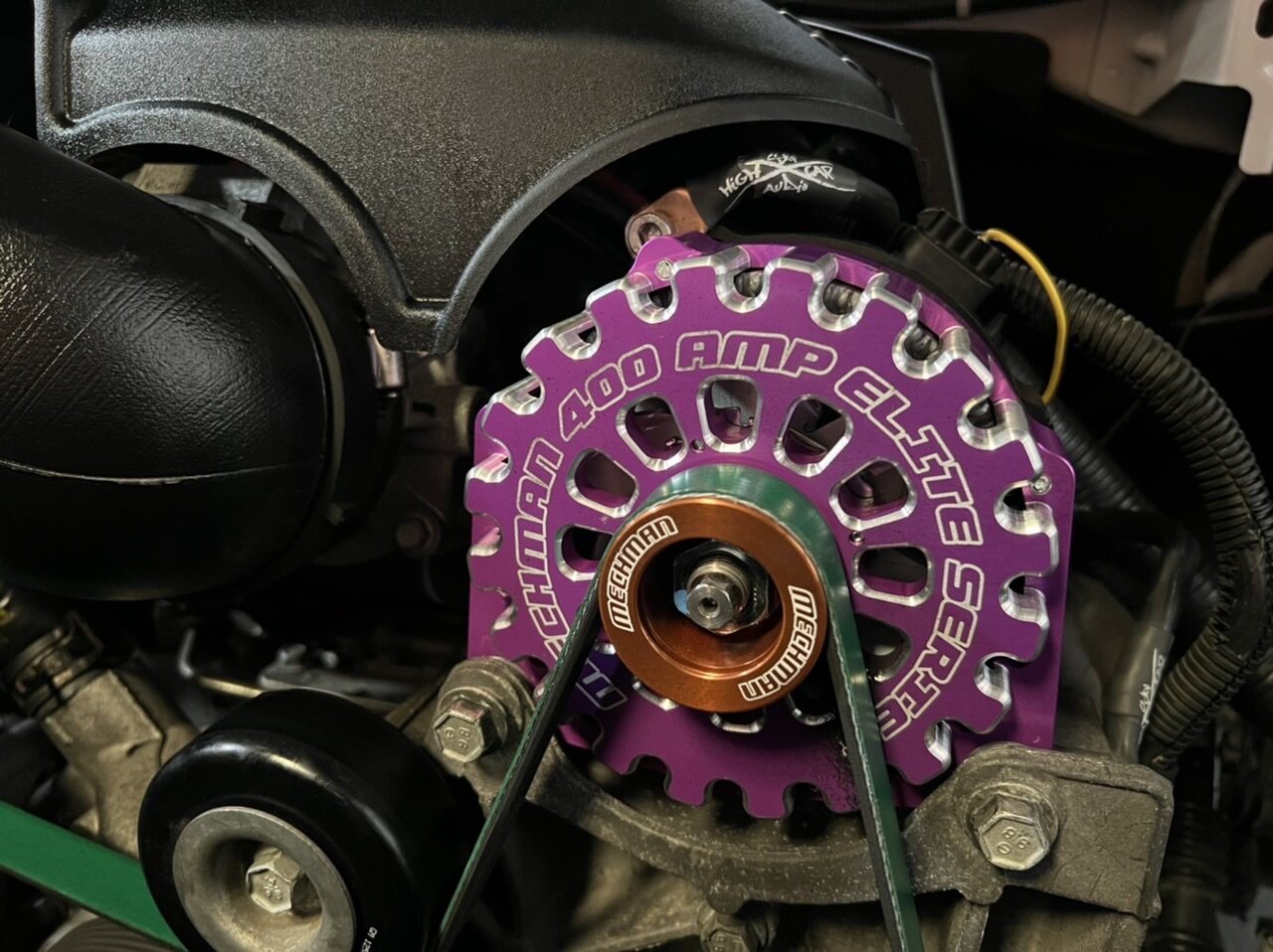

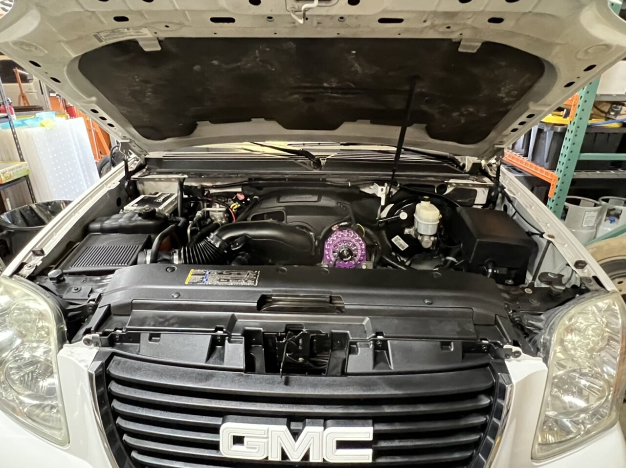

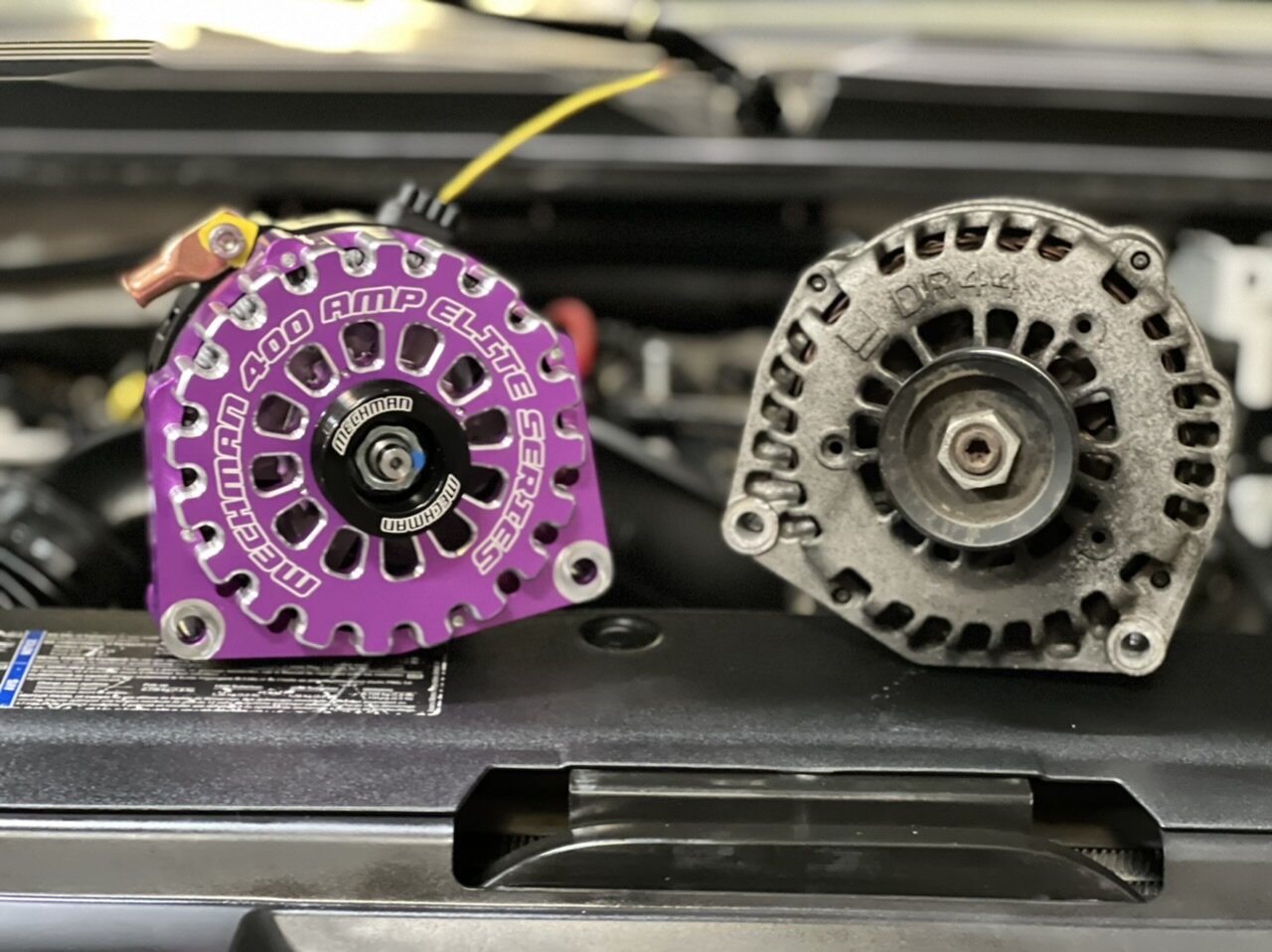

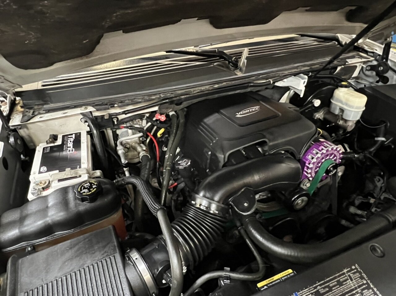

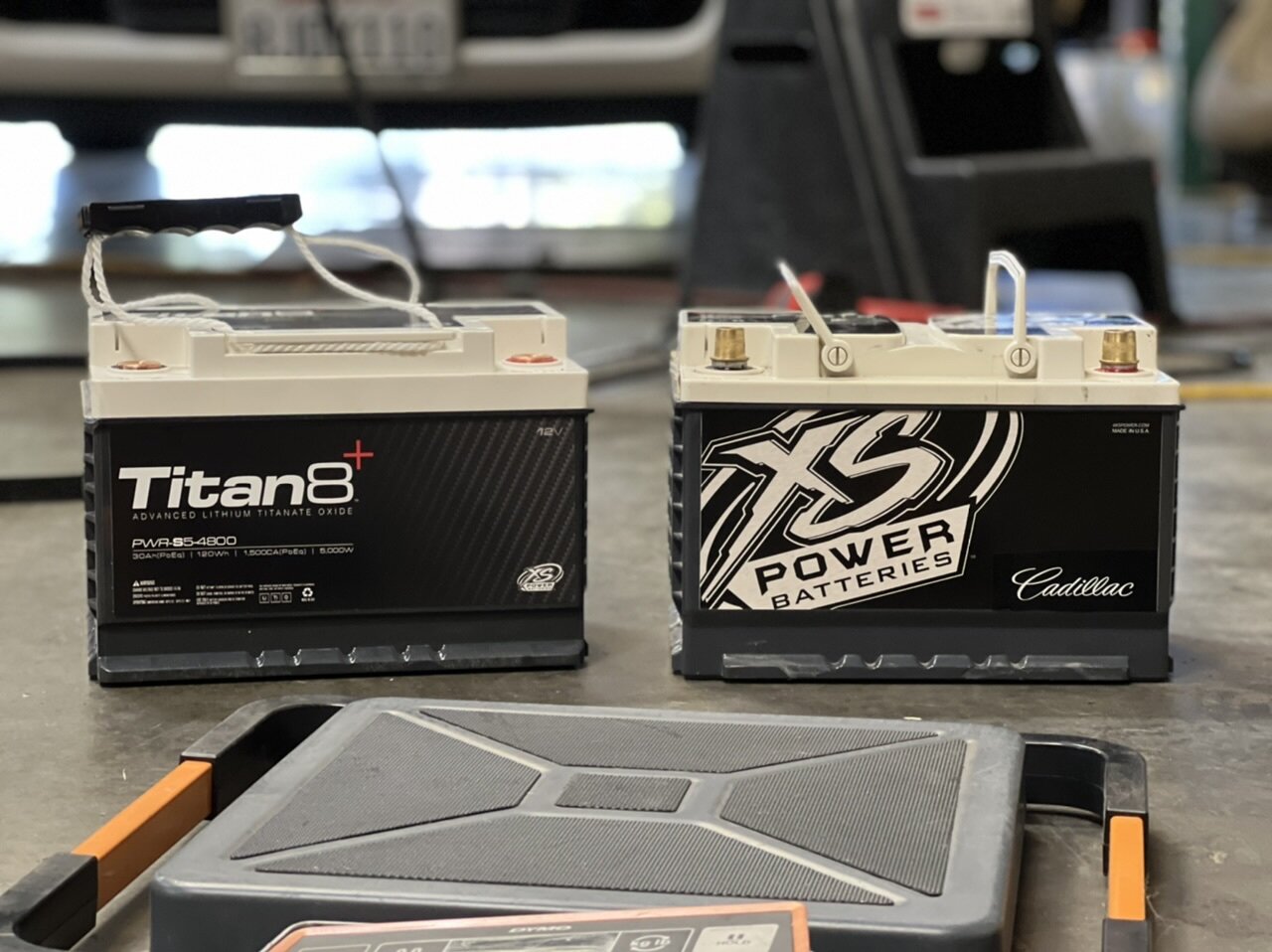

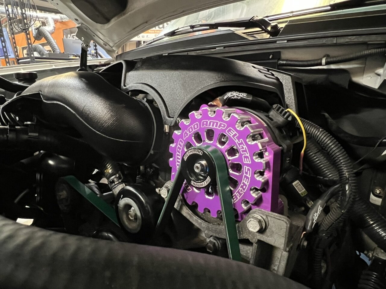

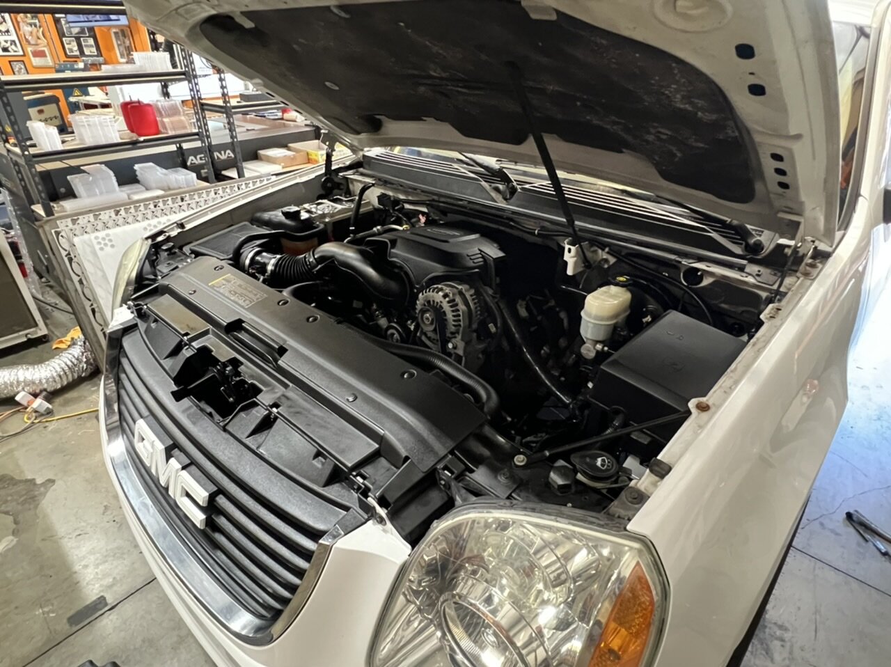

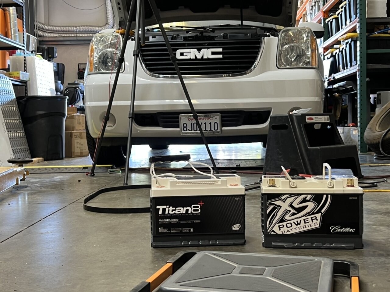

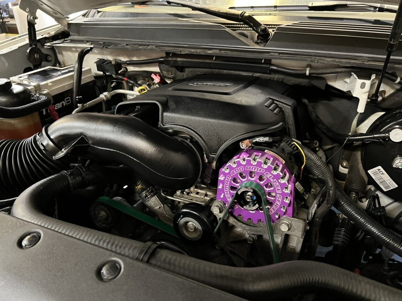

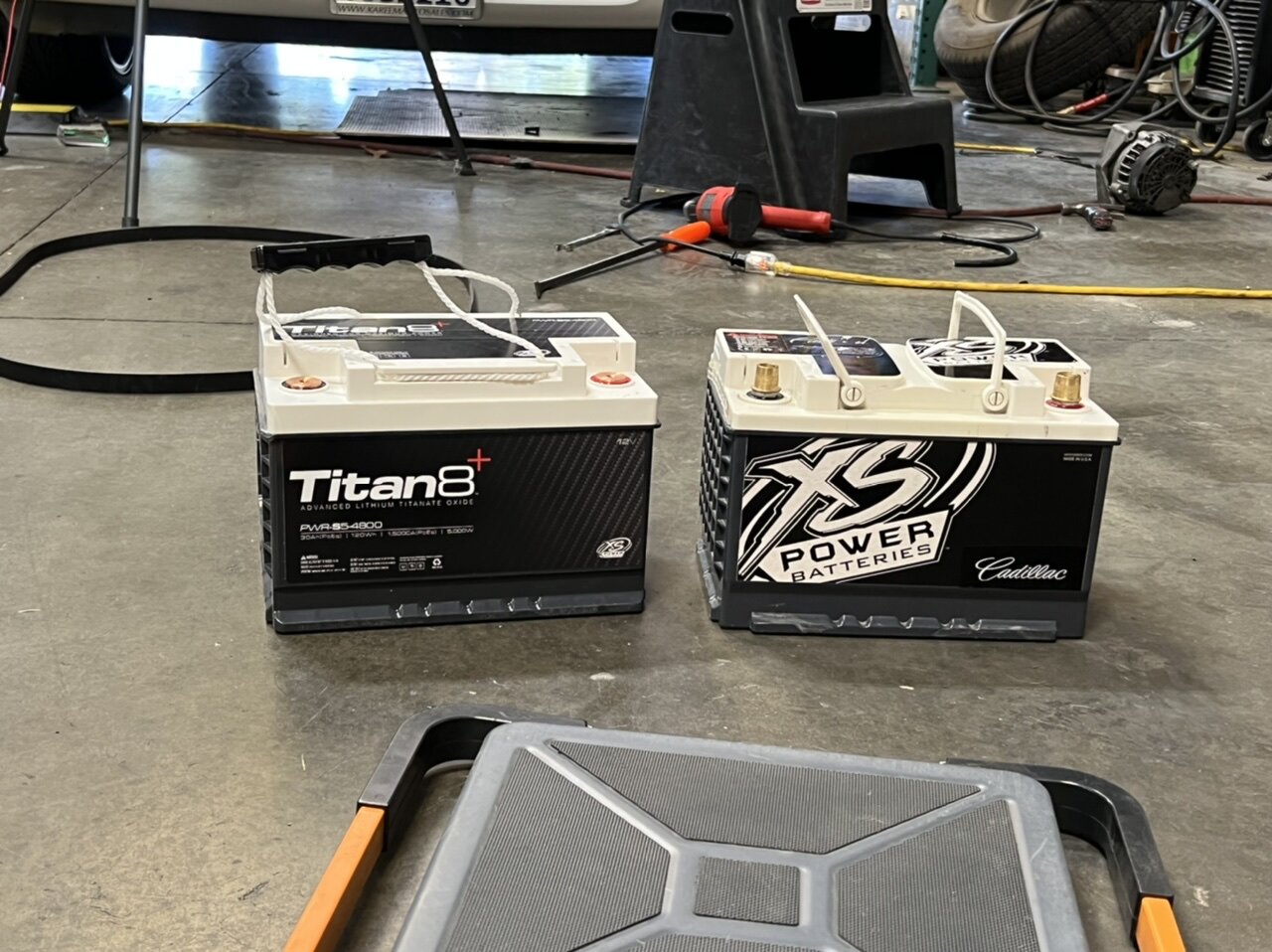

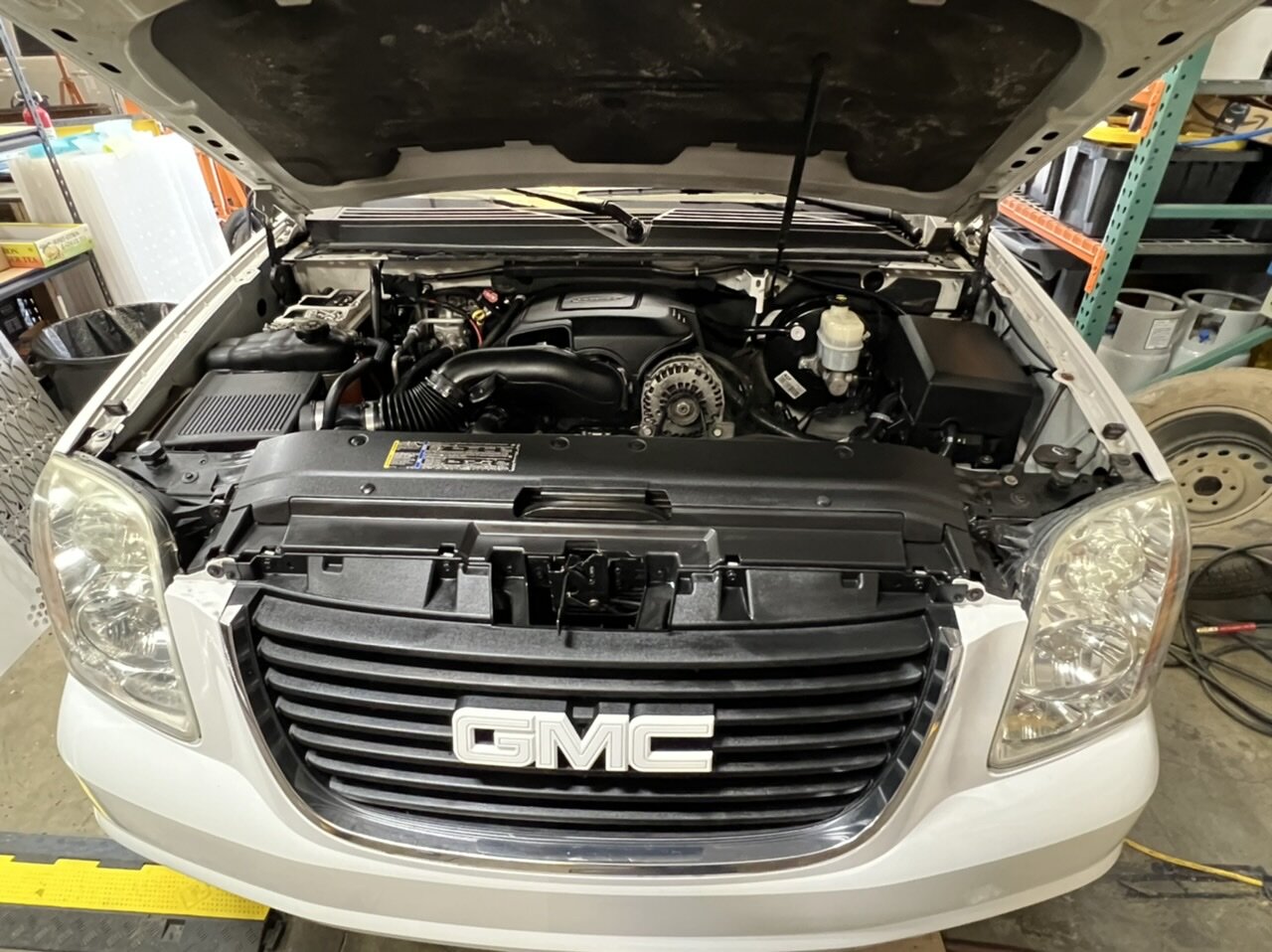

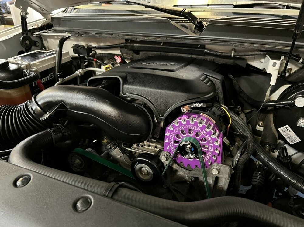

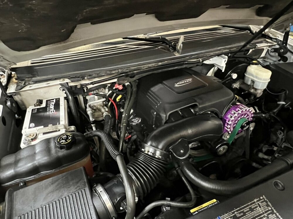

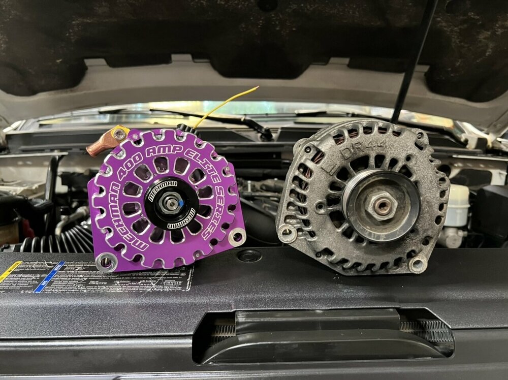

time to get started with the electrical upgrades!

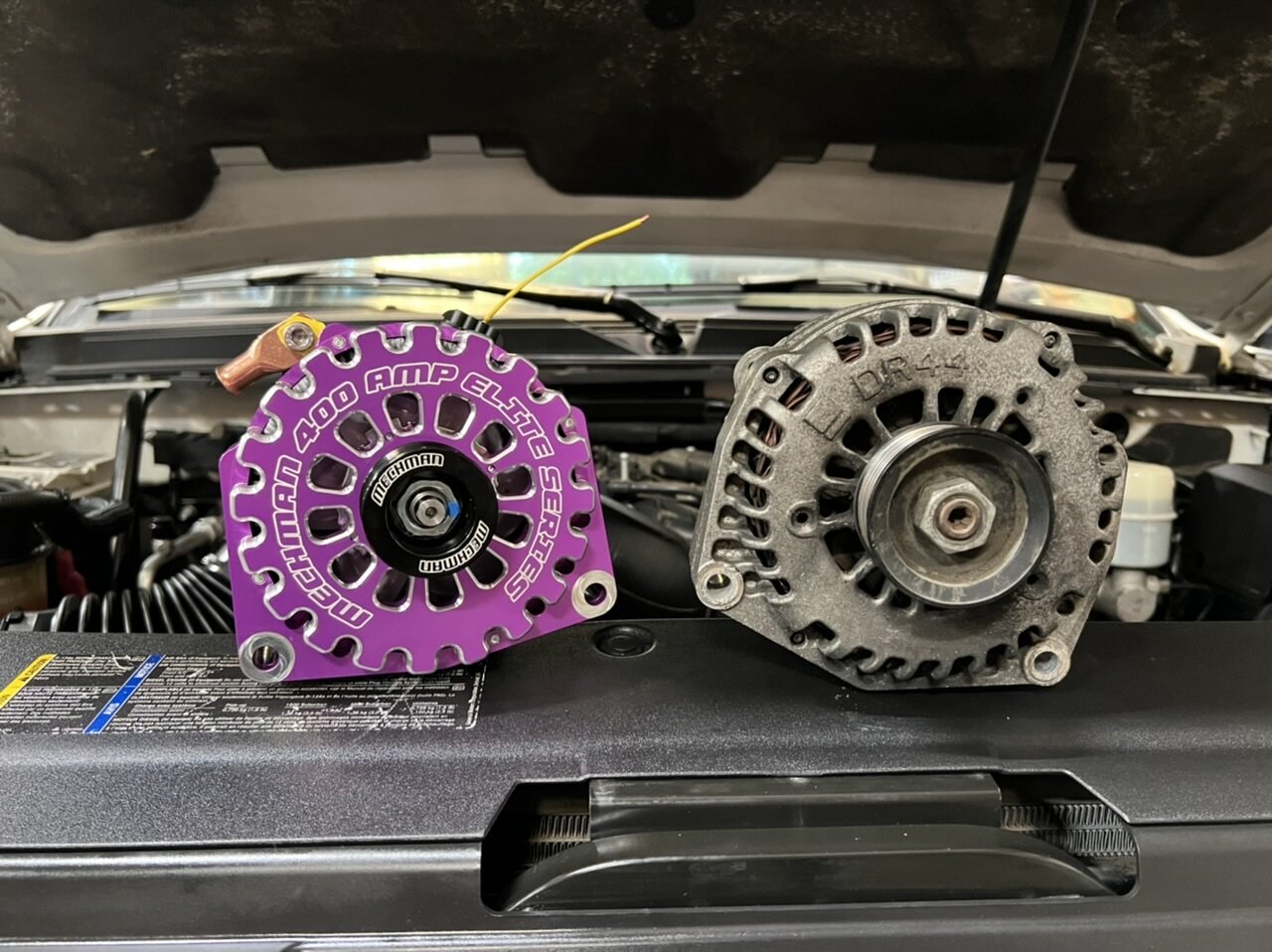

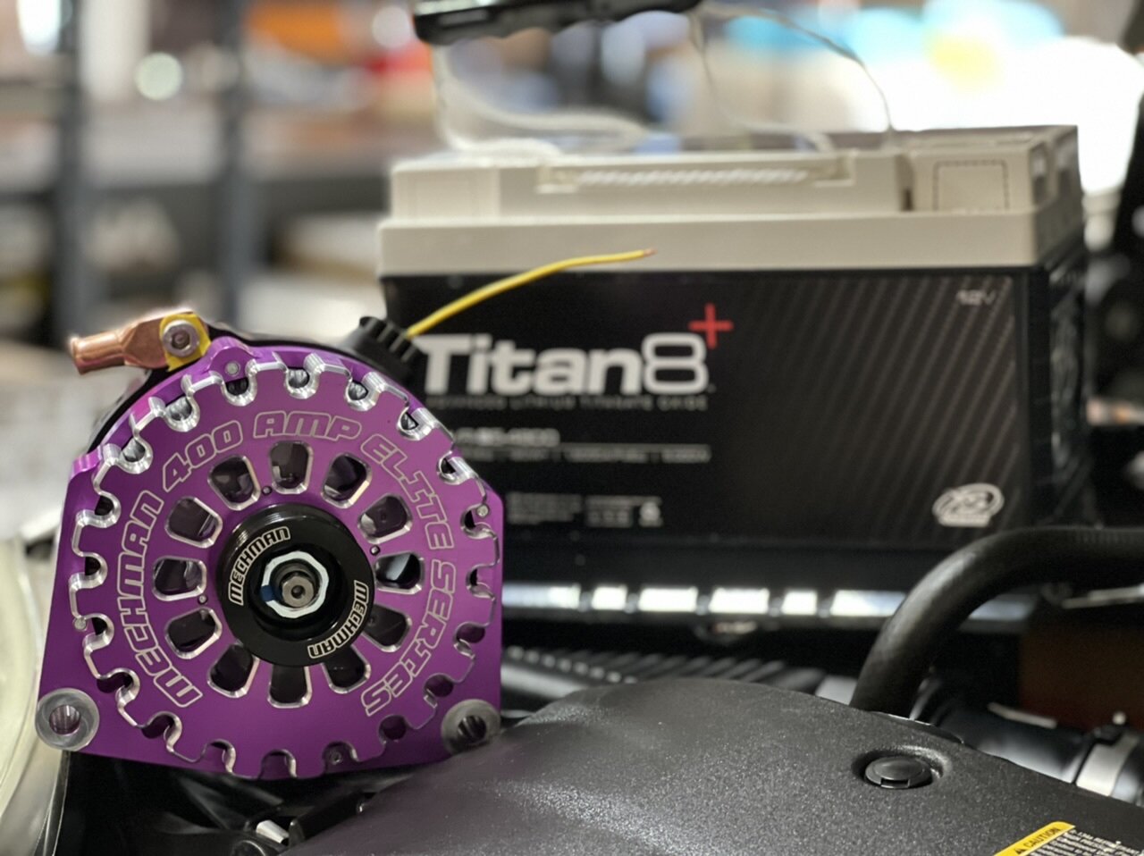

The 3rd XS Power Titan 8 lithium showed up for the front and also we got a 400a Mechman Elite series alternator.  I have a few spools of Skyhigh Car Audio 2/0 from my last build so we will wire it all up with that!  SMD Fuse blocks and ground distro of course!
9.5lbs vs 48.5lbs.... Lithium FTW!
