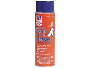

If you have to use a spray adhesive, I recommend Permatex spray adhesive in the orange can with a blue top. They make another in a blue can with white top that isn't as good. Orange can blue top is what you want. 3M is ok as long as it is the Super90. Anything else is garbage household crap for scrapbooking old ladies.
Now if you use a spray adhesive, it will let go when resin hits it. The trick is to spray and stretch the material past what will be resined. If it is on a door panel or kick or something, spray it and wrap the material around to the back side of the pieces and don't allow resin on the back side.
