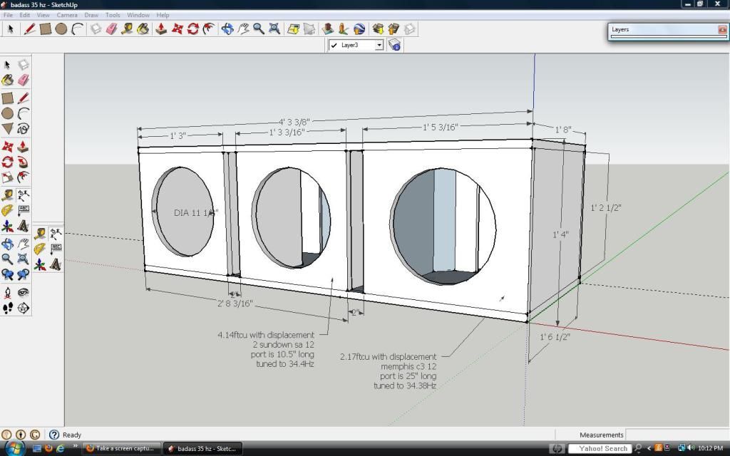

Will Rouse Posted July 25, 2012 Author Report Posted July 25, 2012 this is the box i'm planning on building i hope the separation will do away with cancellation through me any ideas i love suggestions Quote how i sound wit my windows down
jhmeg2 Posted July 25, 2012 Report Posted July 25, 2012 don't put in the seperate sub... its not a good idea to mix subs and or have different sizes. just run the two 12's.are the 6x9s going in the rear? are you able to bandpass the mid amp? are you running a cross over for the midrange and tweets, or are they going to be active? just a few good questions. Quote ////Alpine, Eclipse, Load Boss, Pheonix Gold, MB Quart,Digital Desings, Memphis, Stinger, Periphial, MTX, Visualogic

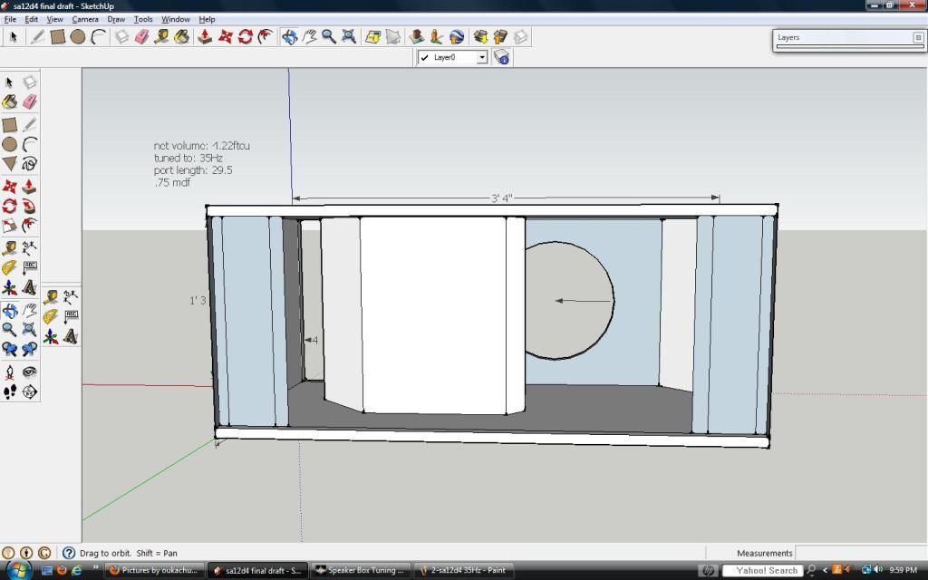

Will Rouse Posted July 25, 2012 Author Report Posted July 25, 2012 (edited) this is my start my sa's should be here tomorrow i will post more as i get into it Edited July 25, 2012 by Will Rouse Quote how i sound wit my windows down

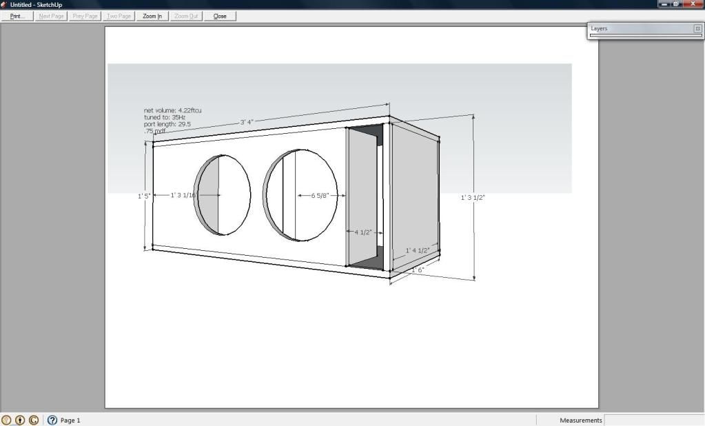

Will Rouse Posted July 27, 2012 Author Report Posted July 27, 2012 this is my final draft start building sat am Quote how i sound wit my windows down
