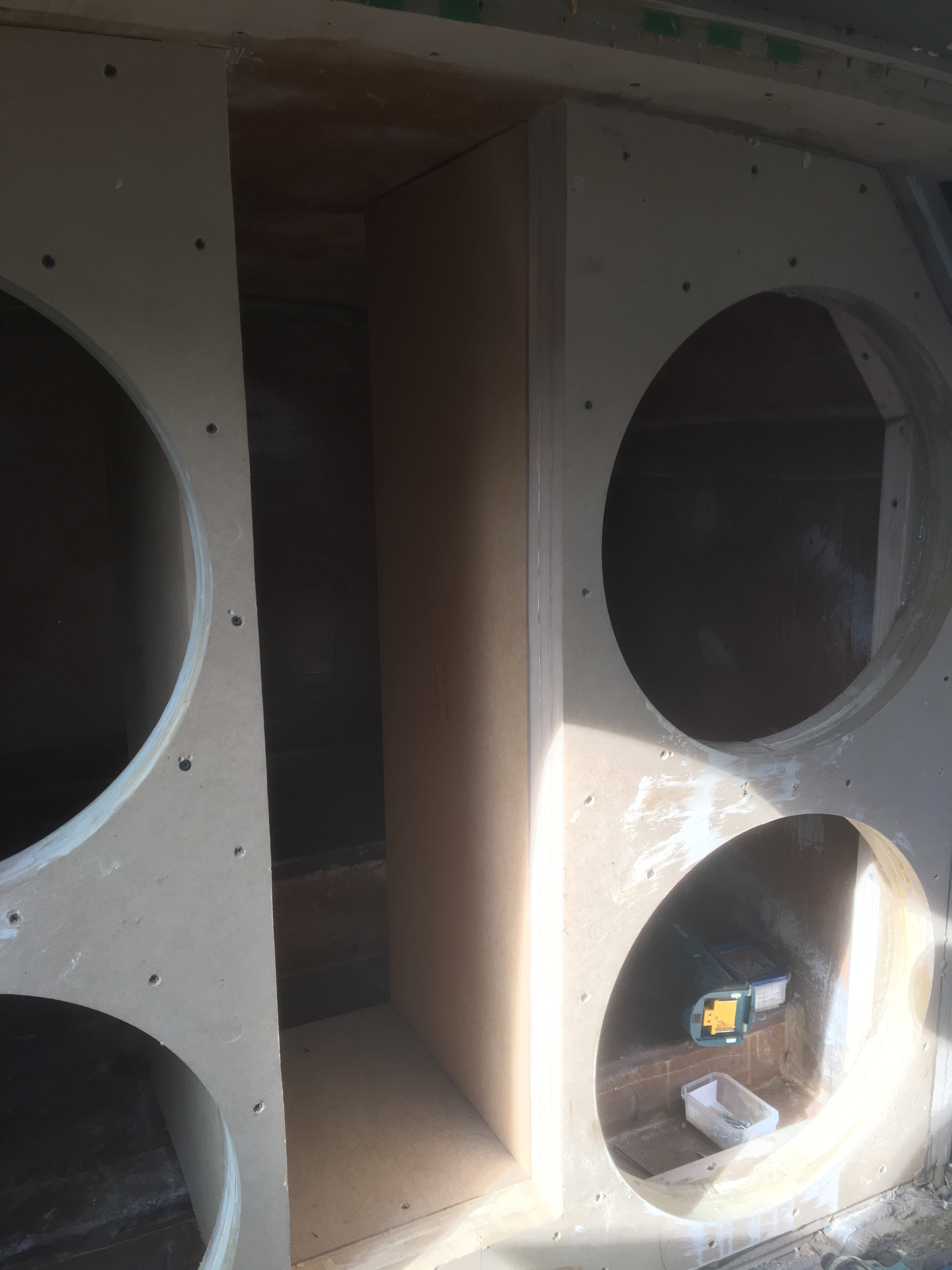

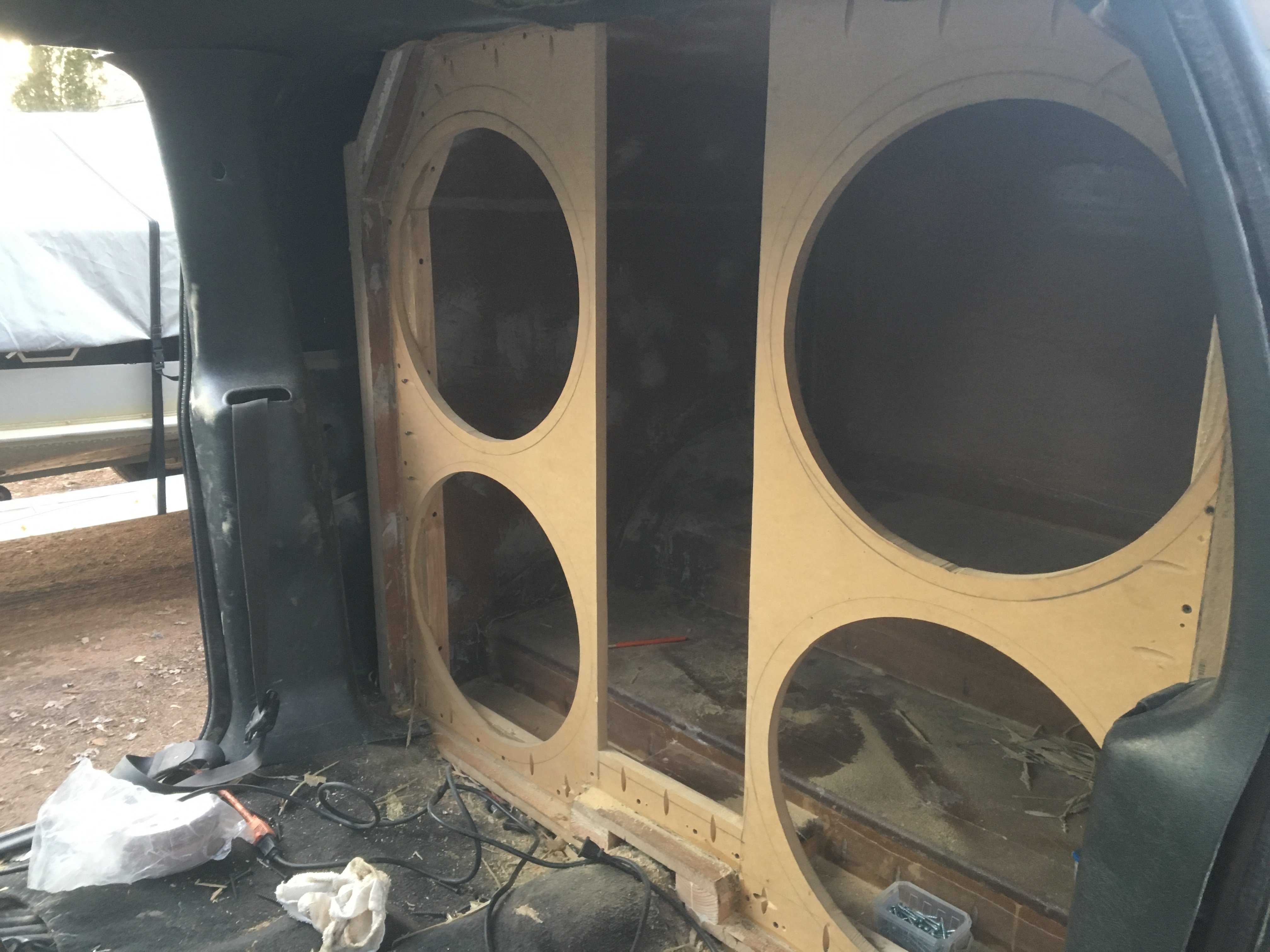

Been a while since I updated. Been dealing with either -50° Weather or 3 feet of snow fall. So I haven’t done much to it in the last month. Got the wood roof finished. Final thickness is 2.25” thick. Then got the sides glued into place and connected to the roof with 45’s. Still a lot of work to be done, but the next step will be a second layer of 45° on top, attach the back sides, then work on fiberglassing over the wheel wells.

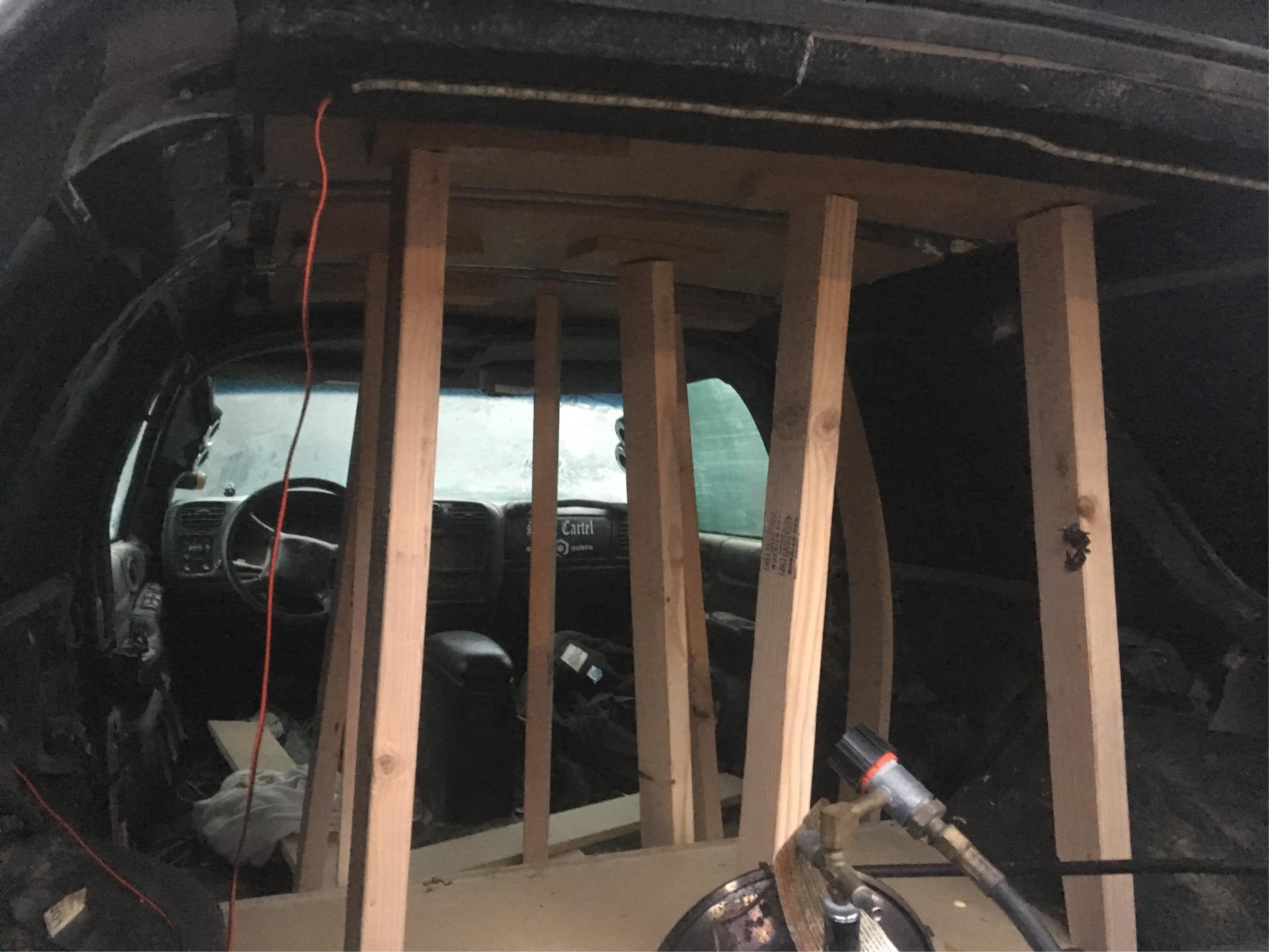

Progress has been slow with the cold weather finally setting in. Was able to use a small propane heater inside my truck to warm it up enough to start my wood roof. First layer is 1/2” mdf. Second layer is 3/4 mdf. 3rd layer will either be 3/4 or 2 layers of 1/2”. So roof will end up being between 2 and 2.25” thick. Once the wood roof is all done I’ll be able to get the sides permanently mounted and things should start moving pretty quickly after that. Layer 1: Layer 2:

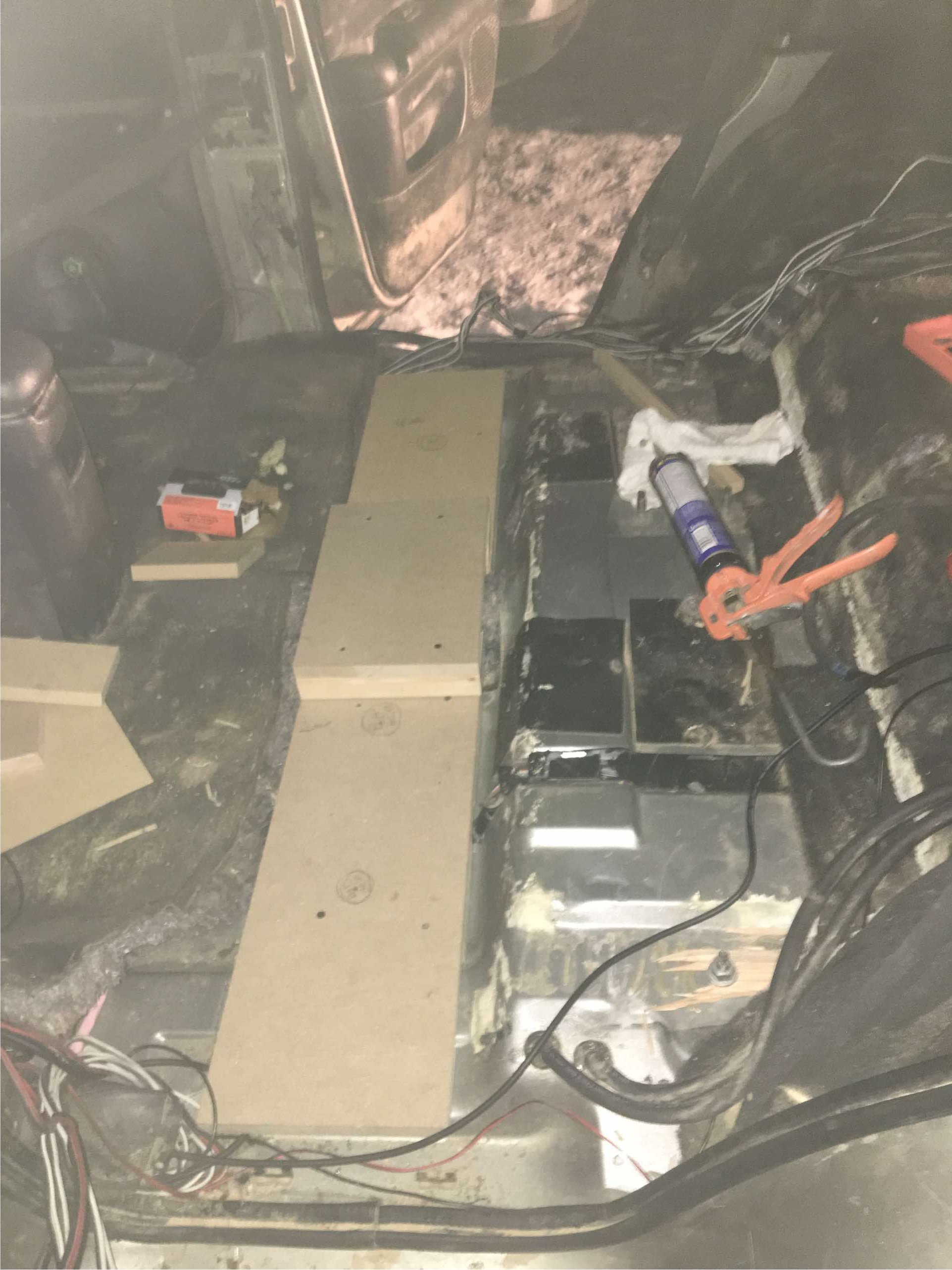

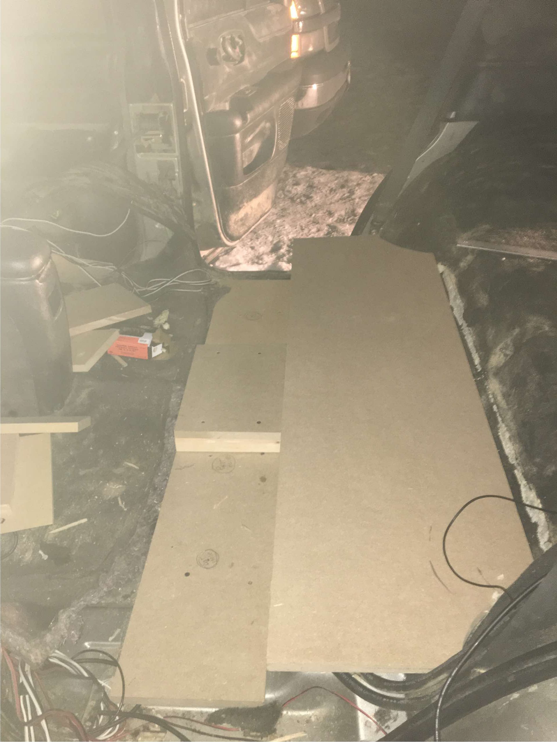

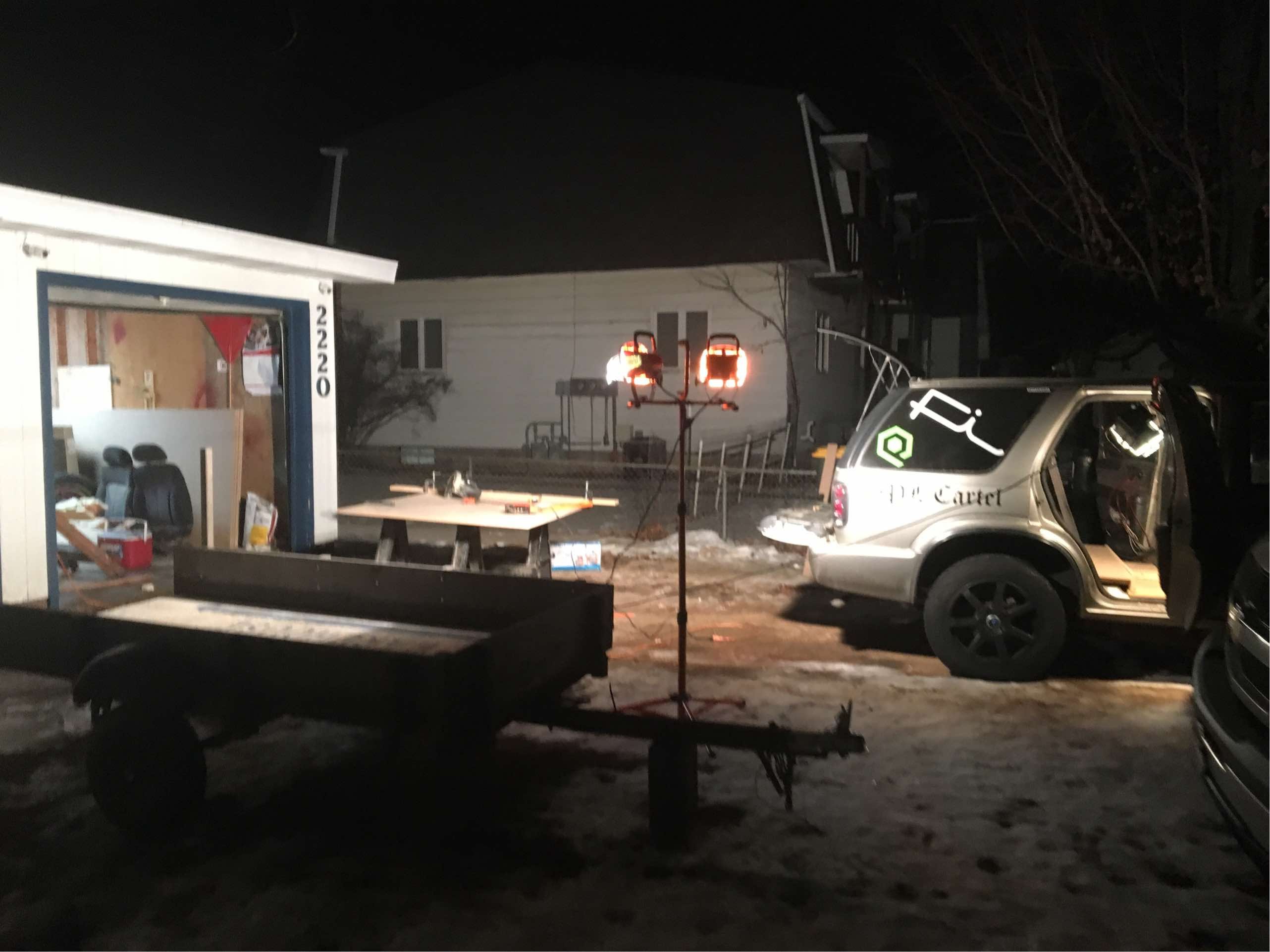

Made some more progress. It’s not all glued in but that’s roughly how the floor of the wall will be. I took some vacation from work so I’ll be working on it all day tomorrow. Hope to get the floor all done and start on the sides and top. Its coming together a lot faster than I thought. Really excited to get this done working in the winter sucks. But it has been in the 30’s here all week so not too bad. Got some nice lights to work with when it’s dark. Don’t mind the shitty pics. Phone sucks taking pics at night.
