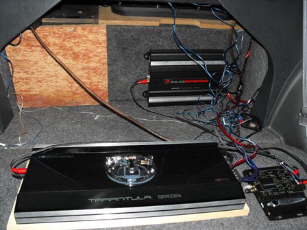

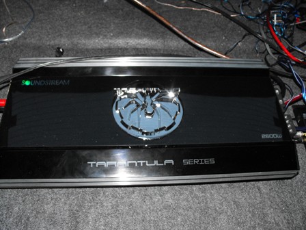

Yes 4 gauge I know I should run bigger wire but don't have the funds.. I'm running a sound-stream tx1 2600d and a bass inferno high amp.. the sound-stream is pushing one kicker solo x 18 in a 5cf box
you're running 4 gauge on an amp that pulls in excess of 250 amps of current. yeah...i'd definitely think about rewiring everything with 1/0 first THEN doing the big 3 (you could even do 2 runs of 4 gauge for each of the big three.
edit: are those wet cell batteries?! thats a HUGE no no dude.
edit: are those wet cell batteries?! that's a HUGE no no dude.
The one is a wet cell truck batt and the other is a shuriken 35 amp hour. should I just have the dry cell batt then

I posted pics of my system above no vid yet. Can I ask why you would think it was B.S. was it because I had the wrong wire? also its in a cavalier
Know where I can find some good 1/0 for a good price
