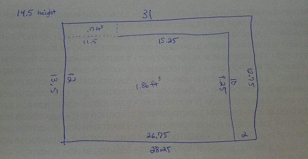

Bonka Posted June 25, 2017 Report Posted June 25, 2017 Putting an SA-12 D4 v3 in my WRX and am trying to design and build a box for it since the shop costs too much. Ported isn't as easy as my sealed I did for an old build. If I did my math right, using 3/4" wood, I should have 1.89 ft^3 (1.86 + .17 - .14) and the port is 2" x 13" x 28" giving me roughly a 34 hz tune. This would be so much easier and smaller with a sealed box but I want the lows. Would greatly appreciate any feedback on this.
Jessica Posted June 25, 2017 Report Posted June 25, 2017 im showing 2.2cuft net with a 30hz tune and very little port area. edit 2.07 @ 32hz Rest in peace, walled 87 accord build log 03' Corolla build with AA Mayhem inside. My super random youtube channel and terrible camera work. Wiring comparison by CaptainzPlanetz Wire and fuse guide by Guest SyKo13
Jessica Posted June 25, 2017 Report Posted June 25, 2017 edit: corrected for woofer displacement Rest in peace, walled 87 accord build log 03' Corolla build with AA Mayhem inside. My super random youtube channel and terrible camera work. Wiring comparison by CaptainzPlanetz Wire and fuse guide by Guest SyKo13
Jessica Posted June 25, 2017 Report Posted June 25, 2017 i forgot woofer displacement. let me fix that Rest in peace, walled 87 accord build log 03' Corolla build with AA Mayhem inside. My super random youtube channel and terrible camera work. Wiring comparison by CaptainzPlanetz Wire and fuse guide by Guest SyKo13
Bonka Posted June 25, 2017 Author Report Posted June 25, 2017 Thanks for checking. I was using http://www.the12volt.com/caraudio/boxcalcs.asp and thought it looked good. Then again I've never done this before. Hence why I'm asking for some help. Now I'm kind of lost though. I don't know how it could be that far off.
Bonka Posted June 25, 2017 Author Report Posted June 25, 2017 I guess I messed the port length up. I was taking 12.75 + 15.25 rather than 10 + 15.25. Time to look this back over.
Jessica Posted June 25, 2017 Report Posted June 25, 2017 measure down the center of the port. also did you sbtract the thickness of the port walls from your volume and the sub displacement.? Rest in peace, walled 87 accord build log 03' Corolla build with AA Mayhem inside. My super random youtube channel and terrible camera work. Wiring comparison by CaptainzPlanetz Wire and fuse guide by Guest SyKo13
Bonka Posted June 25, 2017 Author Report Posted June 25, 2017 Measuring down the center of the port I still get 28" of port length. My volume calculations were done with all the internal dimensions so the thickness of walls was already taken out. There's a big volume difference between what I have and what that program has and I'm not grasping it right now.
Jessica Posted June 25, 2017 Report Posted June 25, 2017 have you ever used google sketchup? Rest in peace, walled 87 accord build log 03' Corolla build with AA Mayhem inside. My super random youtube channel and terrible camera work. Wiring comparison by CaptainzPlanetz Wire and fuse guide by Guest SyKo13
Bonka Posted June 25, 2017 Author Report Posted June 25, 2017 For my volume I was doing 9.25 x 26.75 x 13 / 1728 = 1.86. Then the 11.5 x 2 x 13 / 1728 = .17.
