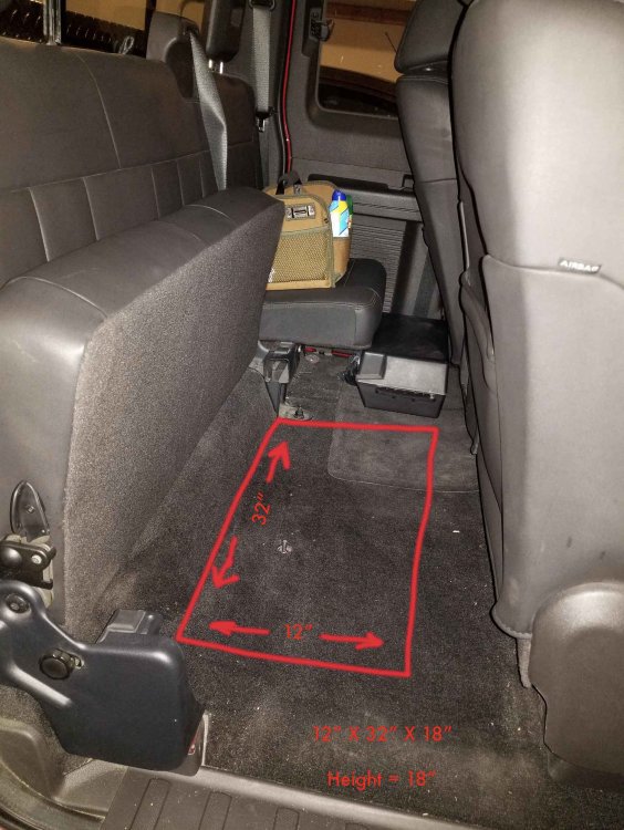

Box would need an internal volume of 1.5 cubes after sub displacement. I want to tune to 31-33 hz.... I can build a box if I have blue prints, but in terms of figuring port size for tuning and subwoofer displacement I get lost.
The dimensions I am willing to work with are 32" Wide, 18" High, and 12" Deep, I have attached a picture showing the max dimensions I can do. I cannot remove the seat cushion... that was my initial plan but it is not possible without removing the single seat on the drivers side as well.

Thank you for any advice, input, or box designs.... I am willing to pay for a properly designed set of box blueprints that are straight forward. 5a6681ccec580_ScreenShot2018-01-22at6_27.44PMcopy.thumb.jpg.0b6be478484ee336b794bf36816992ce.jpg
