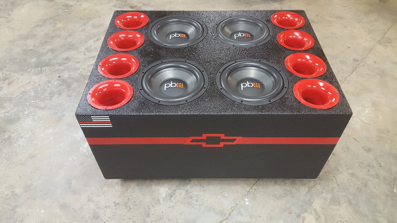

Thank you all so much. I really appreciate all the help. Tuned to 29 and it hits stupid low and way harder than I could have imagined. This beats anything I have ever had as far as lows go. It puts the rearview mirror straight down at the dash and I get a good amount of flex. My windshield has started leaking now but I couldn't be happier.

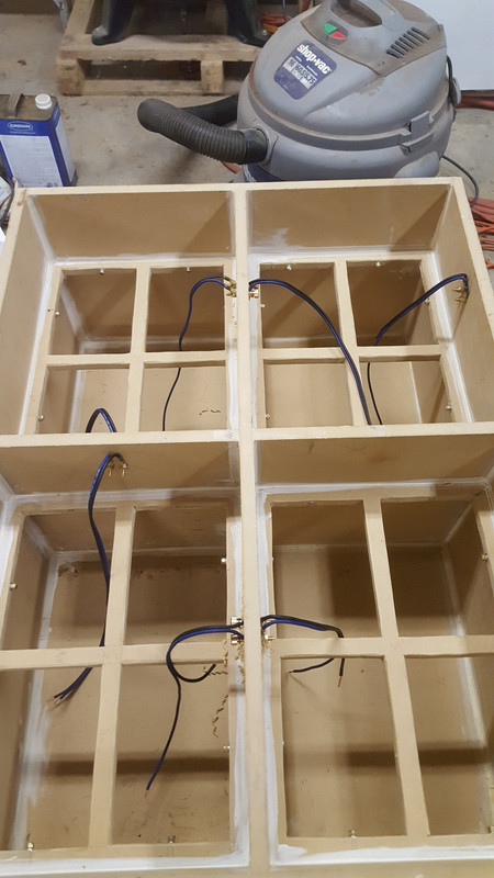

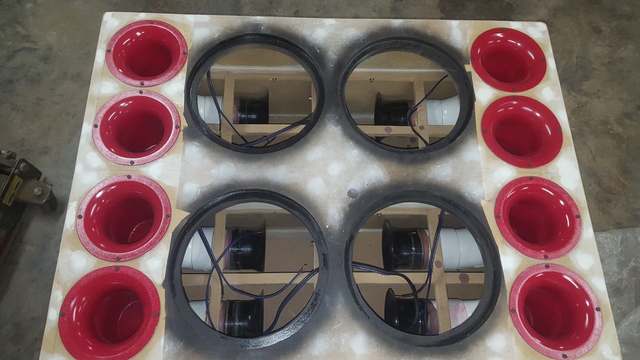

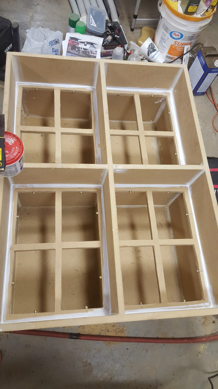

Double floor and double top. That way I could recess the sub faces which you will see later. I screwed liquid nailed and caulked everything. I even bolted the windows in and used locknuts and red locktite and then hack sawed the ends and ground off the excess
