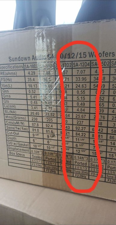

Recently bought 2 sundown sa-12 d4's and im trying to build my own box to get the most out of these. Could really use some help with the box specifications though. Looking to build a ported box tuned to 35Hz (i normally listen to electronic music like dumbstep, drum and bass, etc but the recommendations for these subs is 35Hz so i assume that would be best). Trying to find the best way to squeeze this box into the back of my current Honda odyssey. Dimensions i can work with back there are 34 inches wide, 26 inches high. depth varies because of the rear seat angle but lower depth is 19 inches and 10 inches up top. If anyone can help me out itd be greatly appreciated. The 2 subs are 750watt rms each and ill be running em with a 1500watt rms Skar amp if that makes any difference.
Attached picture is the side of the box the sub came in and has the specs circled in red.
