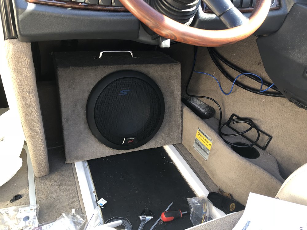

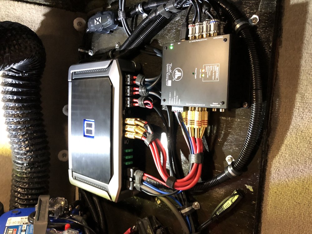

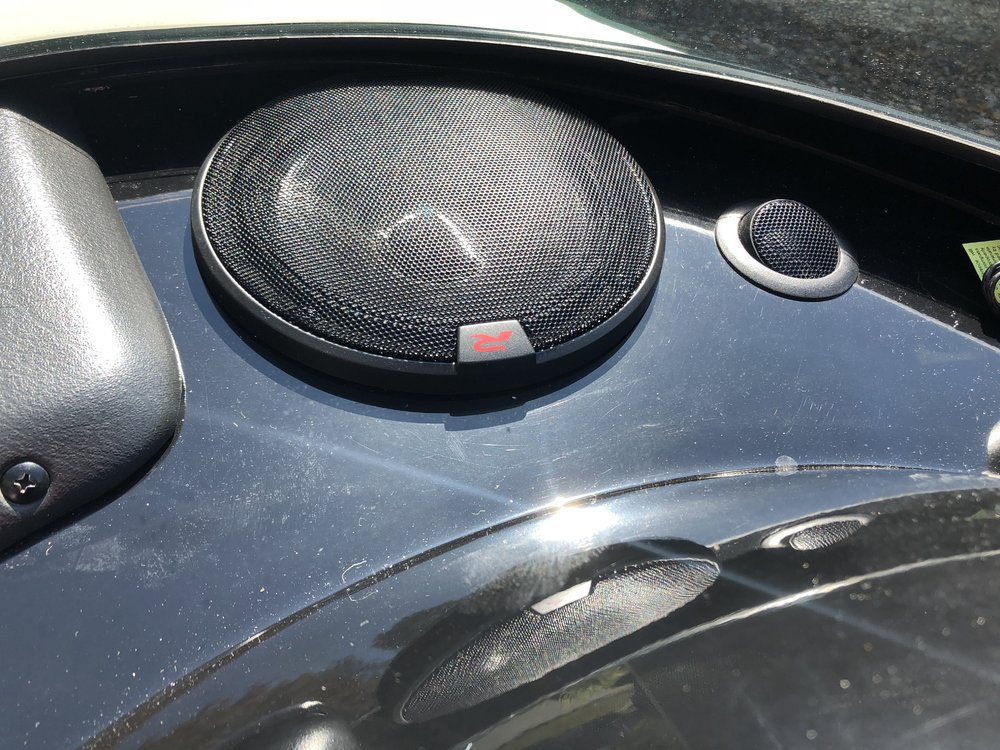

Hi all...Put small system in 2001 Malibu Sunsetter LXI which I bough new some 20 years ago now... Attached a couple pics for you. I put in 5 channel Alpine Amp, TWK88 DSP, Alpine 6.5" components up front with passive tweeter and Alpine co-axials in back. A 12" dual voice coil woofer wired to 2 Ohms in a box under the helm. All heavy gauge wire.

I am using twk88 and it really very good and fun to use. Lots of flexibility and the stereo is sounding quite good now. I have read enough posts on here to know that many of you are way beyond my knowledge and I have lots to learn. So I want to share an issue I am having now.
Thanks to the helpful posts above I did finally get gains set for HU, DSP, and amp. I suspect maybe I set them all too close to the max when my light went off on my DD1.  After setting gains, I set my eq separately for each speaker. Quite a bit of cutting is needed in upper frequency range 2500, 6500, 12k....those were problem spots.

Now the stereo sounds awesome...however for certain songs I am getting some disturbing distortion through the (only) front left speaker at high power...its hard to describe it but kind of a higher pitched crackling buzz. It can be heard on Sia's Chandelier (piano version). This is a really beautiful high powered voice on this song and the speaker can't handle it. I am running at 4-Ohm, approx 75W RMS.  (Speaker is Alpine R-S65C.2 with passive tweeter)
