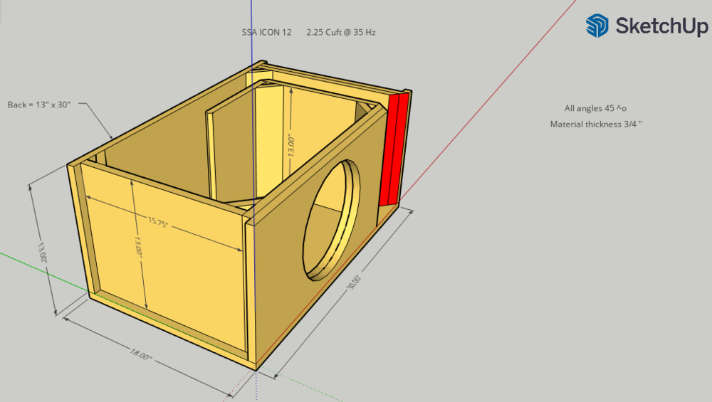

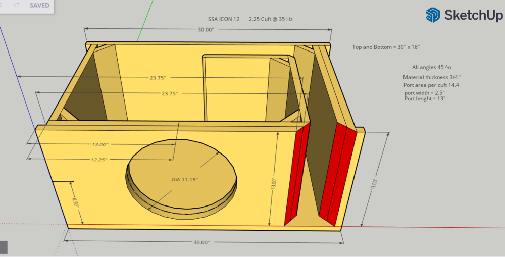

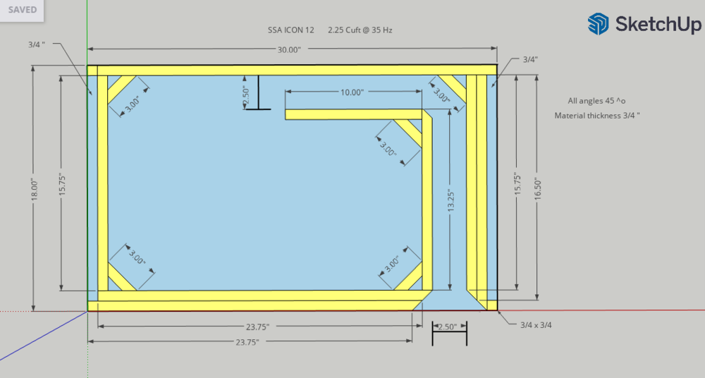

StreetLegal Posted December 4, 2020 Report Posted December 4, 2020 SSA Icon 12 Box design 2.25 cuft @ 35 hz Never Argue With A Fool, People Might Not Know The Difference.
StreetLegal Posted December 4, 2020 Author Report Posted December 4, 2020 Sub up port back coming soon. Never Argue With A Fool, People Might Not Know The Difference.
StreetLegal Posted December 13, 2020 Author Report Posted December 13, 2020 SSA Icon 12 2.25 cuft @ 32 Hz Never Argue With A Fool, People Might Not Know The Difference.
