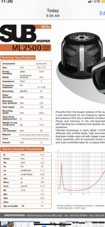

Hey guys I have a 2012 Passat and I Need to make a box for 2 hertz ml2500s. Anyone able design a box for me by chance?  They will be receiving about 550w rms a piece, my first SQ oriented setup with 3 way active etc. Usually listen to hip hop, edm and such some country and rock. Was thinking a box around 2.0 cubes tuned to 33hz. I tried modeling them but I’m not to familiar with port velocity and how to tel if I’ll get full time excursion with the power I have. But ya  have 36W x 14H x 10-15” D to work with.
much appreciated in advance!
