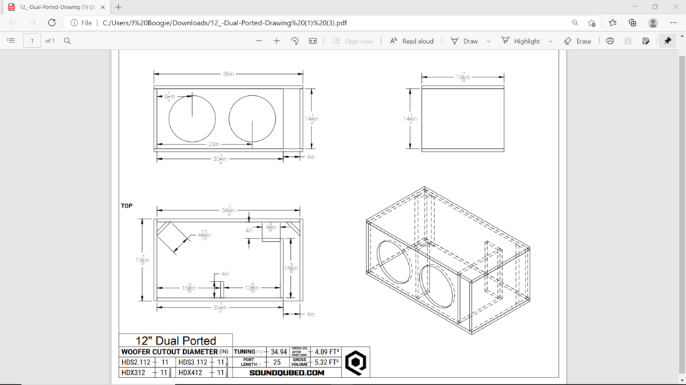

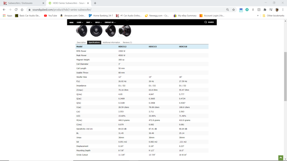

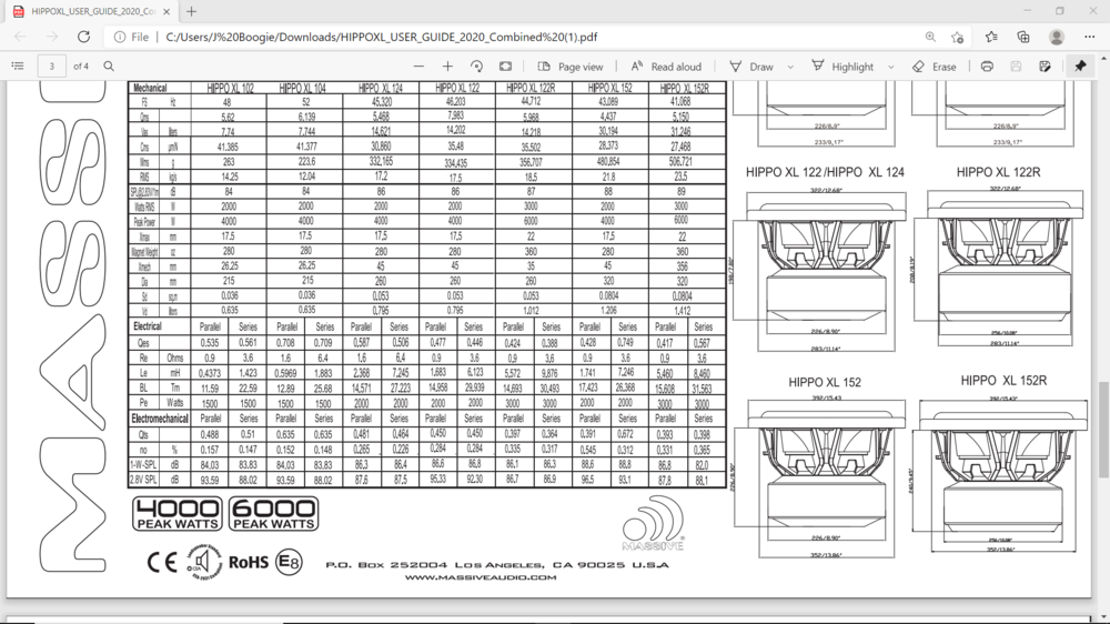

I'm looking to build a new box for my 01 Tahoe. Currently running four 12'' Massive audio Hippo xl 122 on a  Taramp's 15000. In a box designed for me by joe x here in the forums. Current box design is subs up port back. I'm looking to re orientate the port to the same plane as the speakers. current box size is 46" wide 20" tall and 26 1/2 " deep. I am thinking about doubling the box design that I used from Soundqubed for two of their Hdx3 12" subs. That box sounds great! Plus the soundqubed and Hippo's are practically interchangeable. My issue with building the new box is it may be a little to deep. But will have room to make up for it in the width. looking for help with reproportioning the box to fit. hopefully  the file I uploaded is visible. If not ican be viewed on Soundqubed's website. And as always any and all help is greatly appreciated
