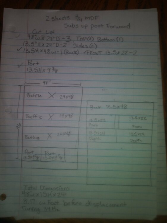

I'm planning on building an enclosure for my 2018 impala. 2 digital design redline 600 15s on a rockford fosgate prime 1200. I went on another website to figure out the cubic feet and came up with a cut sheet. Was wondering if everything looks fine before I buy the MDF and build it. Suppose to be 8.17 cu feet before displacement and tuned at 34 HZ. Thanks
