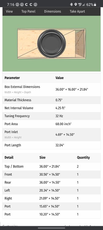

I just got a Sundown Xv2 15 and am trying to get dimensions to build a box this weekend. It will be going in a Honda pilot so I have plenty of room. I have an area about 46 w x 36 d x 24 h I can use whatever of that's needed. I'm using a Skar RP2000.1 to power it for now but  hoping to upgrade in next few weeks. Sundown recommend 4.25cuft at 32 hz with  68 sqin of port area. I was going to do speaker facing up and port to back. Isn't that supposed to be best in SUVs? All my prior system have been in cars. If someone could hook me up with some dimensions and maybe a cut sheet it would be greatly appreciated!!! If anymore info is needed please just ask... Also I listen to rap mostly
