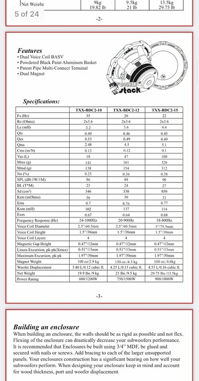

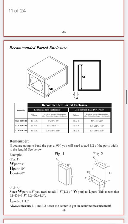

Ported box design for 2 15s on 3k
(2) 15” audiopipe TXX-BDC2 subs on 3k rms,
this will be going in a crew cab Tacoma
my initial idea for the enclosure, looking for suggestions. Want this to be impressive. Is tuning frequency ok? Port area alright? Goal is to be in in the 150s or be able to do hair tricks, one or the other or both. T/S parameters and manufacture recommended enclosure specs are attached as images. Any and all input is welcome, looking for input before I pull the trigger on the build.
3/4” birch, 9 cubic ft gross, 7 cubic ft net after bracing, sub and port displacement, 8x16”x23” long slot port firing towards the driver side, subs firing forward, tuned to 35 hz
