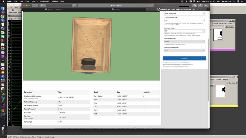

Also here's a link to the box i made online im thinking of building as is fits right into the Elcos smuggler box. Is it a good design? thinking of making a new one but the design won't have the sub facing the back of the seat they'll be facing into the smuggler box and im unsure how that will sound and play into effect  because i'm planing on having one of these boxes on each side of the smuggler box in the corner (for sq).
https://subbox.pro/en/b/4tisUQAUi

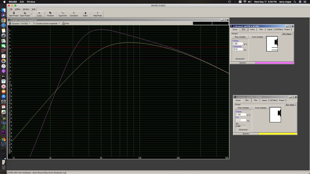

32D7CE46-0587-4357-8B81-29A7B1BF3D47.thumb.jpeg.43a0561596d938a3d0868b57d4a09cf7.jpegHELLO EVERYONE HERES AN UPDATE.  IM DESIGNING MY SUB BOXES ON WINISD AS IM PLANNING IM PLANING TO BUILD THEM THIS WEEKEND UNDECIDED ON A SEALED OR PORTED BOX. ALSO THIS IS MY FIRST TIME BUILDING A SUB BOX IN ANY CAPACITY. BELOW I TOOK A PIC OF THE GRAPH FROM WINISD PINK IS THE SEALED AND YELLOW IS THE PORTED. MY QUESTION THOUGH WAS IF THE READOUTS LOOK OKAY? THE BOXES FOR BOTH ARE THE SAME SIZE 1.3ft3 i can go bigger which would be 2ft3
ALSO FORGOT TO MENTION THAT I WILL BE USING MY DSP TO RUN THE SUBS ONLY FROM 80hz<32D7CE46-0587-4357-8B81-29A7B1BF3D47.thumb.jpeg.43a0561596d938a3d0868b57d4a09cf7.jpeg
