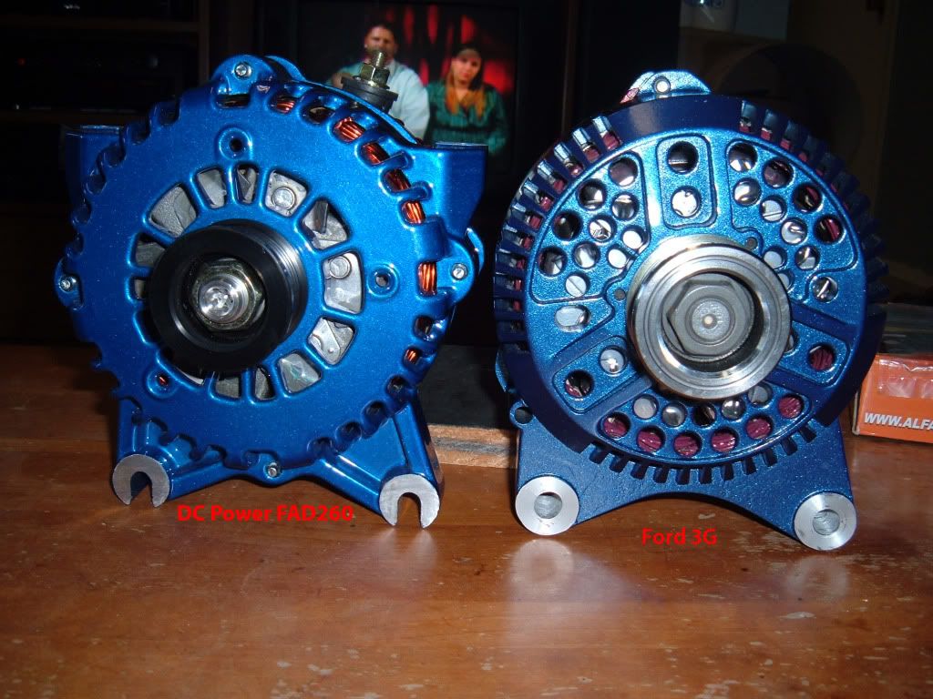

When it comes to HO use, 3G's and 4G's are a 4 letter word for me, and we just wont build them for HO use. We had castings made to run the much better GM type AD244 alternator in all the Fords with 3G or 6G alternators, and there is no Ford alternator even close to being anywhere near as capable in output, nor as reliable as the AD series alternators so we designed something better. Just for reference here's a pic of one of our alternators next to a 3G. I hope this helps, if you have any other questions, let me know.. Rob
