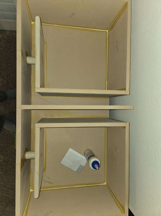

  1.  In the process of building my new enclosure that will house two DD Audio 710Fs (10") each at 1500rms. This box will be double baffle. My question is whether I should add any additional bracing to it ? Its ultrapro 3/4" MDF only because baltic birch inst readily availablein my area unless i want to use veneer from HD. Which is full of voids. (See pic for reference). Each side is 1.5cuft separated at the port via a divider. Everything is glued and screwed as well

      The ports act as bracing in that design style so no you should not need to add more bracing. Still if it feels flimsy then you can make your mind.

      Should I add a price of bracing in the middle of each side walls. Like  2x2x10.5" price of mdf with 45's on each side of the brace edges? My depth of this depth is 18.89" x 10.5"H.
