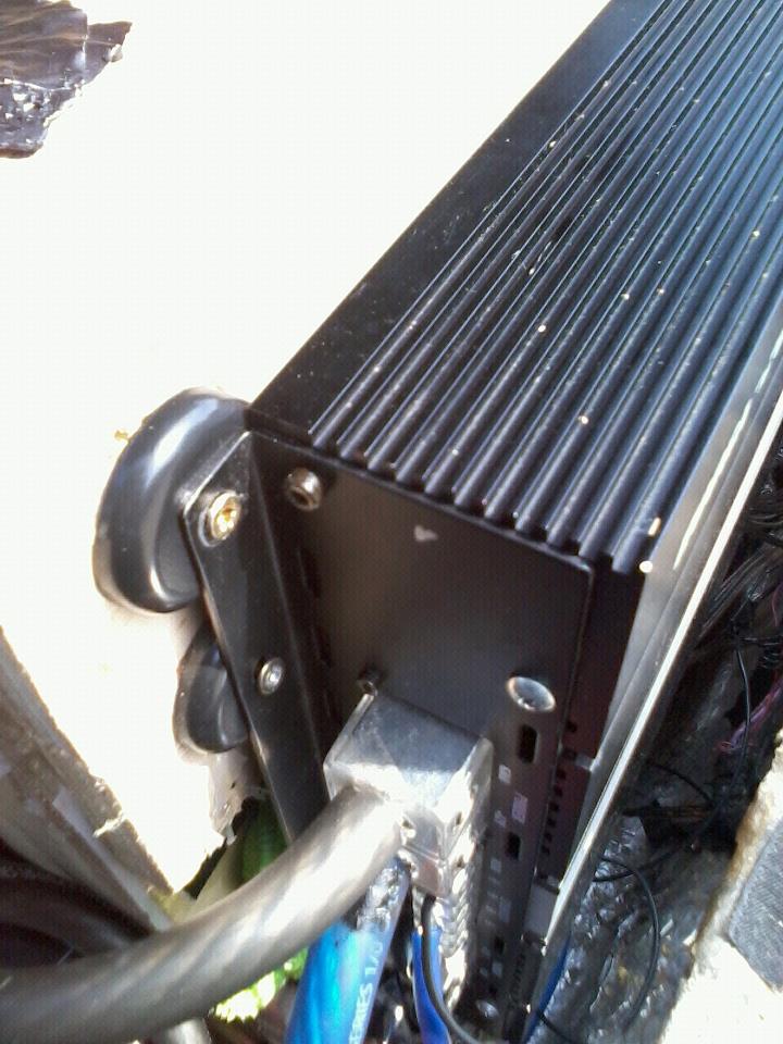

  6. My amp just got back from dbr for a mosfet repair and the back plate seems to rattle violently still, even though they said they used loctite on all the screws. It flexes about 1/8th of an inch, is this something to be concerned about to damage anything? Ive tried alot of methods (stuffed towels in corners of amp, mounted dense rubber on mounts to absorb vibration) and minimized the rattling a little but it still flexes, especially on high notes. attached is a pic on how its mounted. Its mounted on birch wood on back of enclosure, 3 inches away from back of the trunk so im limited on space

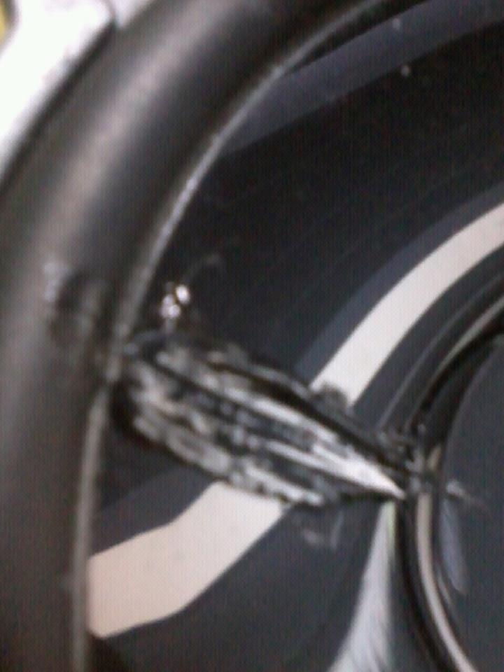

  7. The glue exaggerates it a little, its literally invisible without the glue and had no performance problems, just sealed it so it didnt crack more
