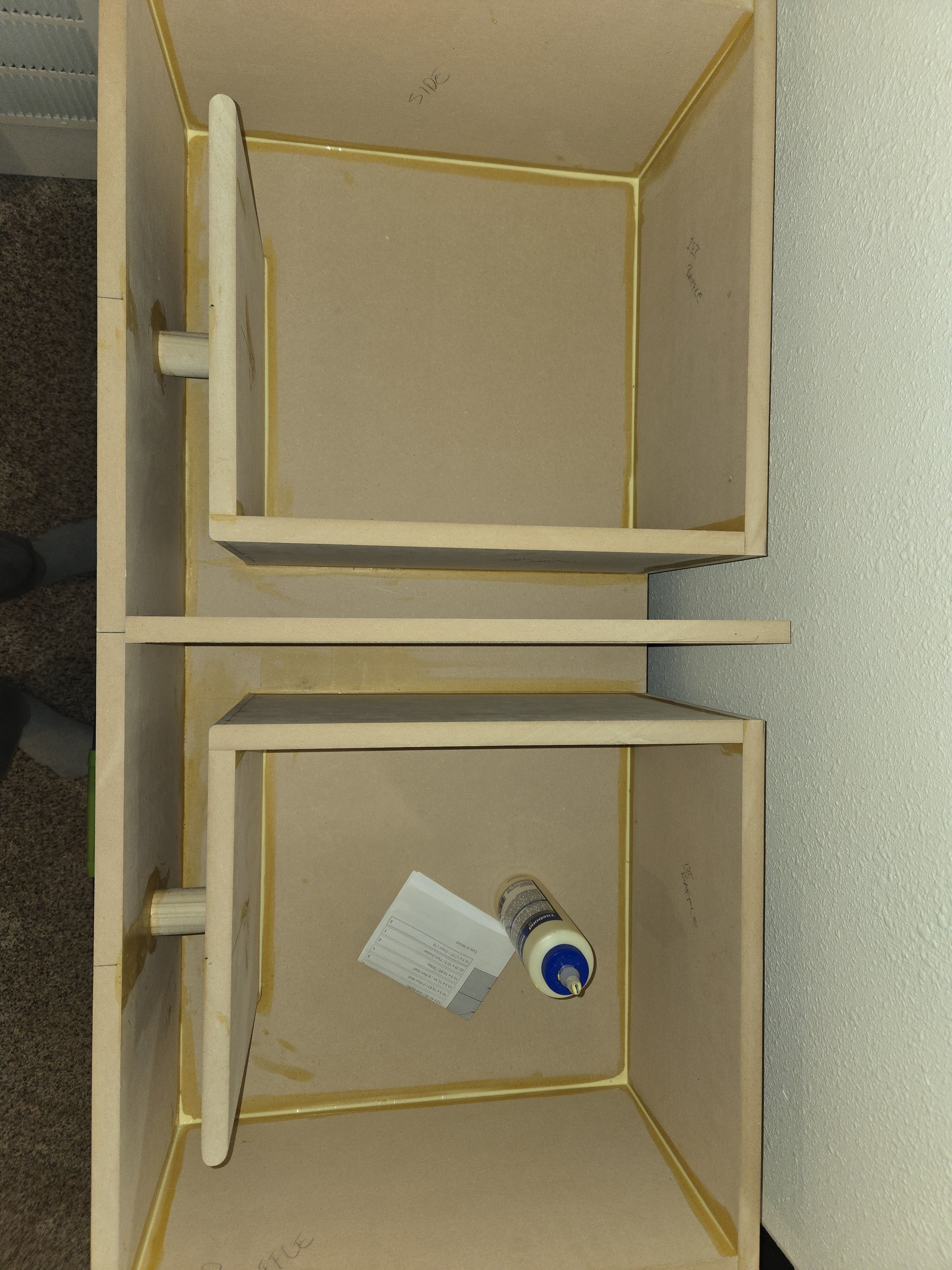

  1.  In the process of building my new enclosure that will house two DD Audio 710Fs (10") each at 1500rms. This box will be double baffle. My question is whether I should add any additional bracing to it ? Its ultrapro 3/4" MDF only because baltic birch inst readily availablein my area unless i want to use veneer from HD. Which is full of voids. (See pic for reference). Each side is 1.5cuft separated at the port via a divider. Everything is glued and screwed as well
    1. Joe X
      Joe X
      The ports act as bracing in that design style so no you should not need to add more bracing. Still if it feels flimsy then you can make your mind.

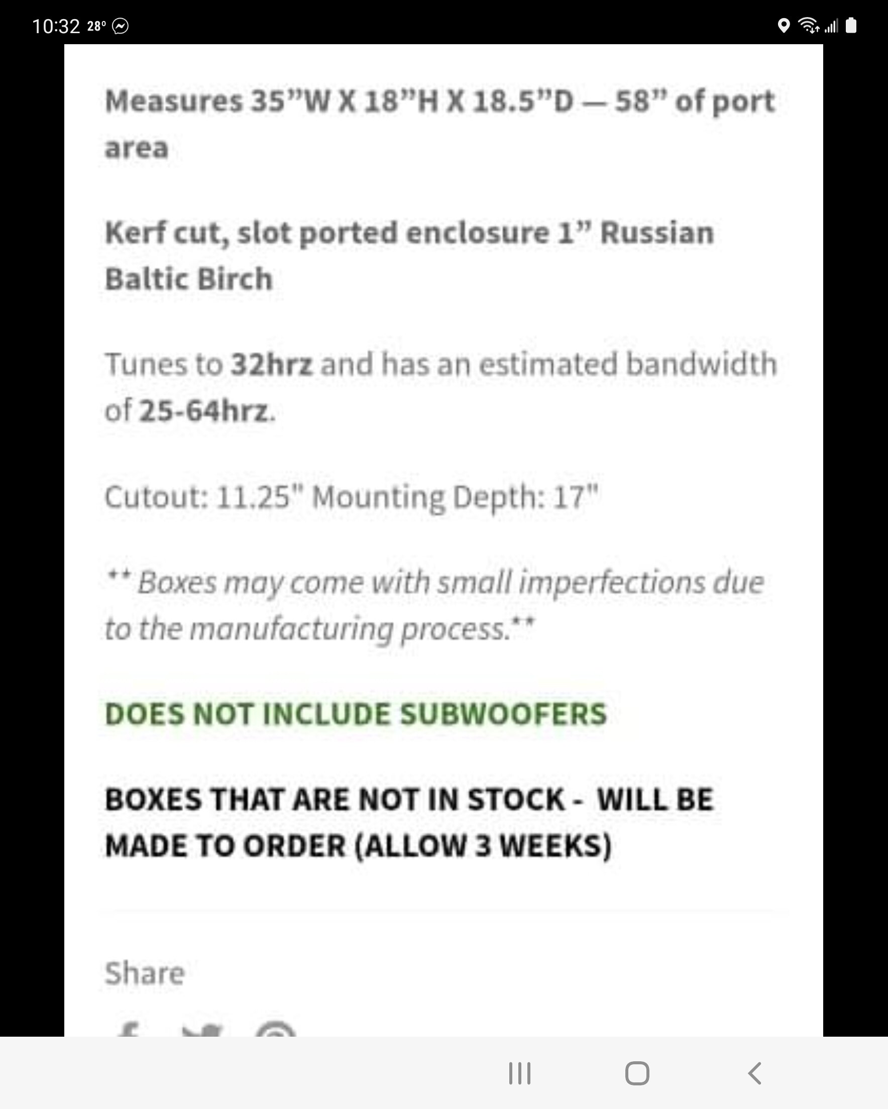

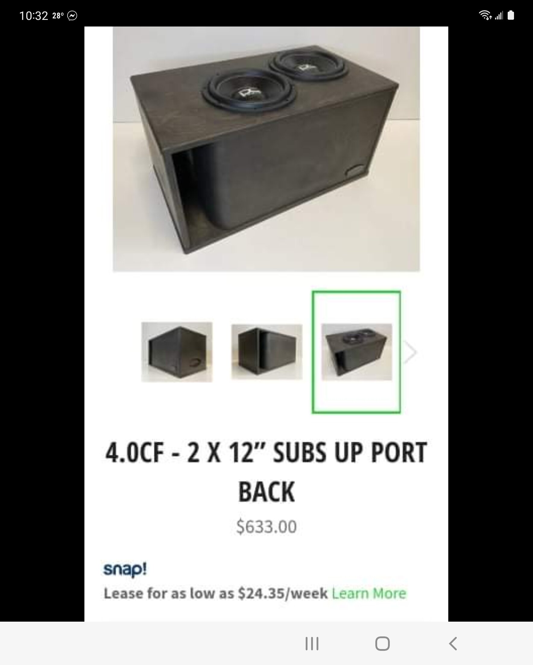

  8. HELP PLEASE!!! THANK YOU IN ADVANCE...
    I have (1) 15" Orion HCCA sub. It literally blows my boxes apart, and or flexes them so hard the wood just splits. I'm not talking prefab either. This was before the subwoofer blew. Now the sub has been completely rebuilt to over spec. Just ran across a local guy that has a Gately dual 12" 4 cube, subs up-port back box. Was thinking of getting it and putting a single 15" face plate on it. I love the Gately boxes, I'm just not in a position to spend $700 for the exact one at the moment. Any thoughts, opinions, advice etc would be greatly appreciated.
    1. Joe X
      Joe X
      Port area may not match even if you were willing to pay that much for a box only to modify it, you have to review your building materials and methods, improper wood or it's thickness, bad glue, improperly cut wood, lack of bracing or improper bracing can all lead to such damage, ask in the subs/enclosures section for further help. Its' not even hard to learn.
