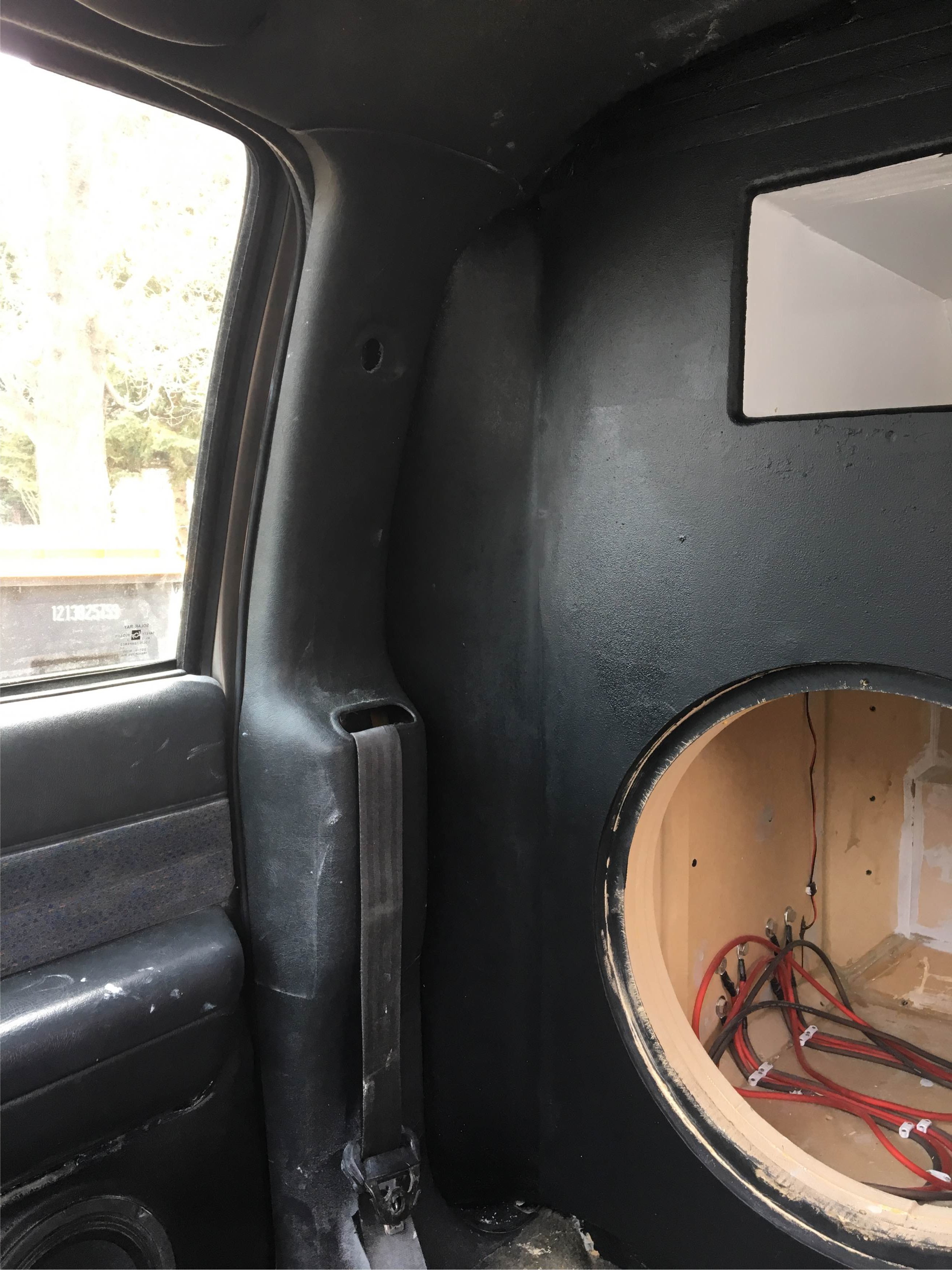

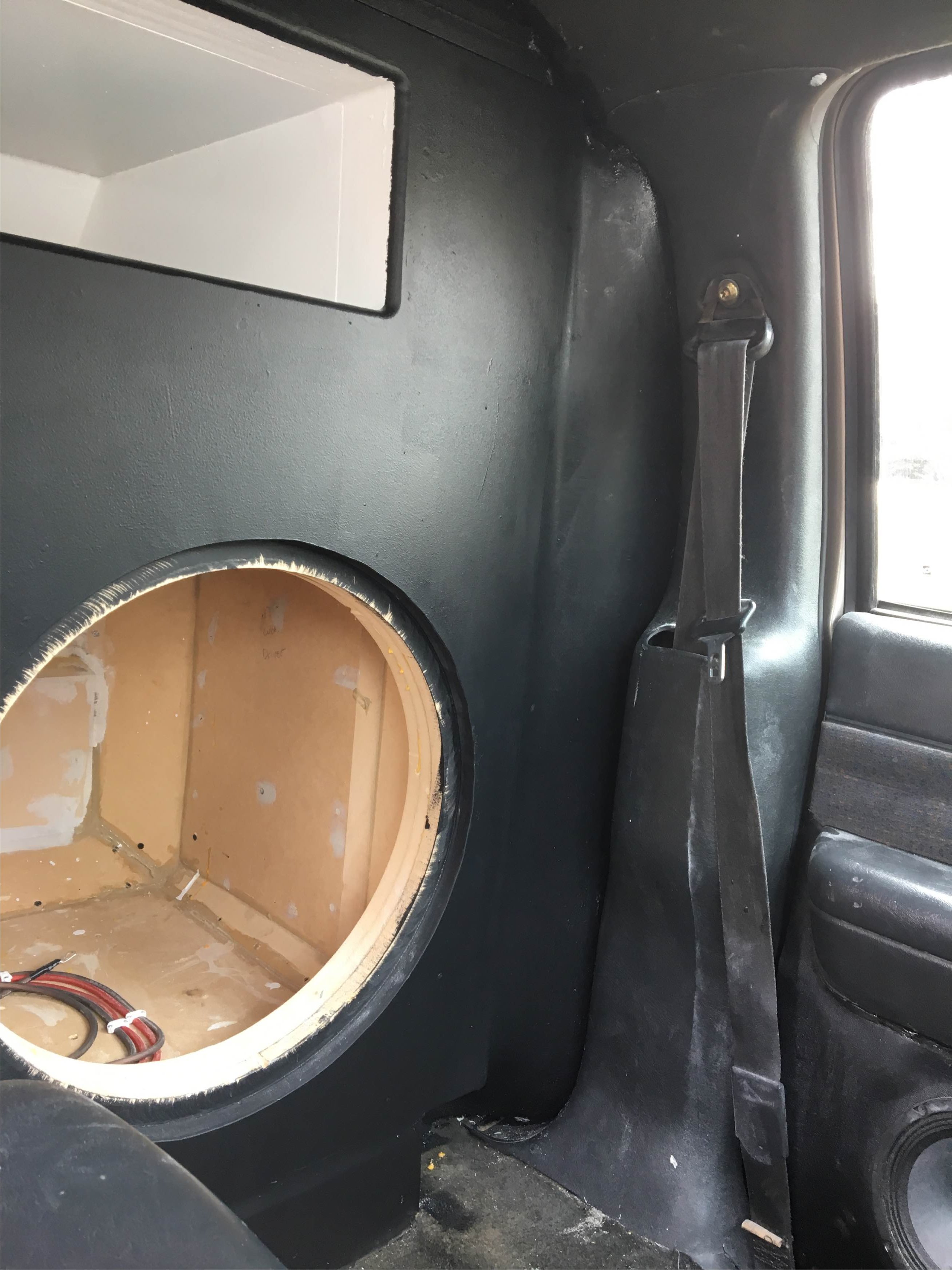

Well, started to tear everything out to get ready to rebuild. Will be adding two more team 18s. Just picked up two blown 15’s. Just gotta get two 18” baskets and recones and I’ll have 4 18’s. Got all the amps and batteries removed today. Will get the subs taken out tomorrow and will be starting to remove he wall shortly.

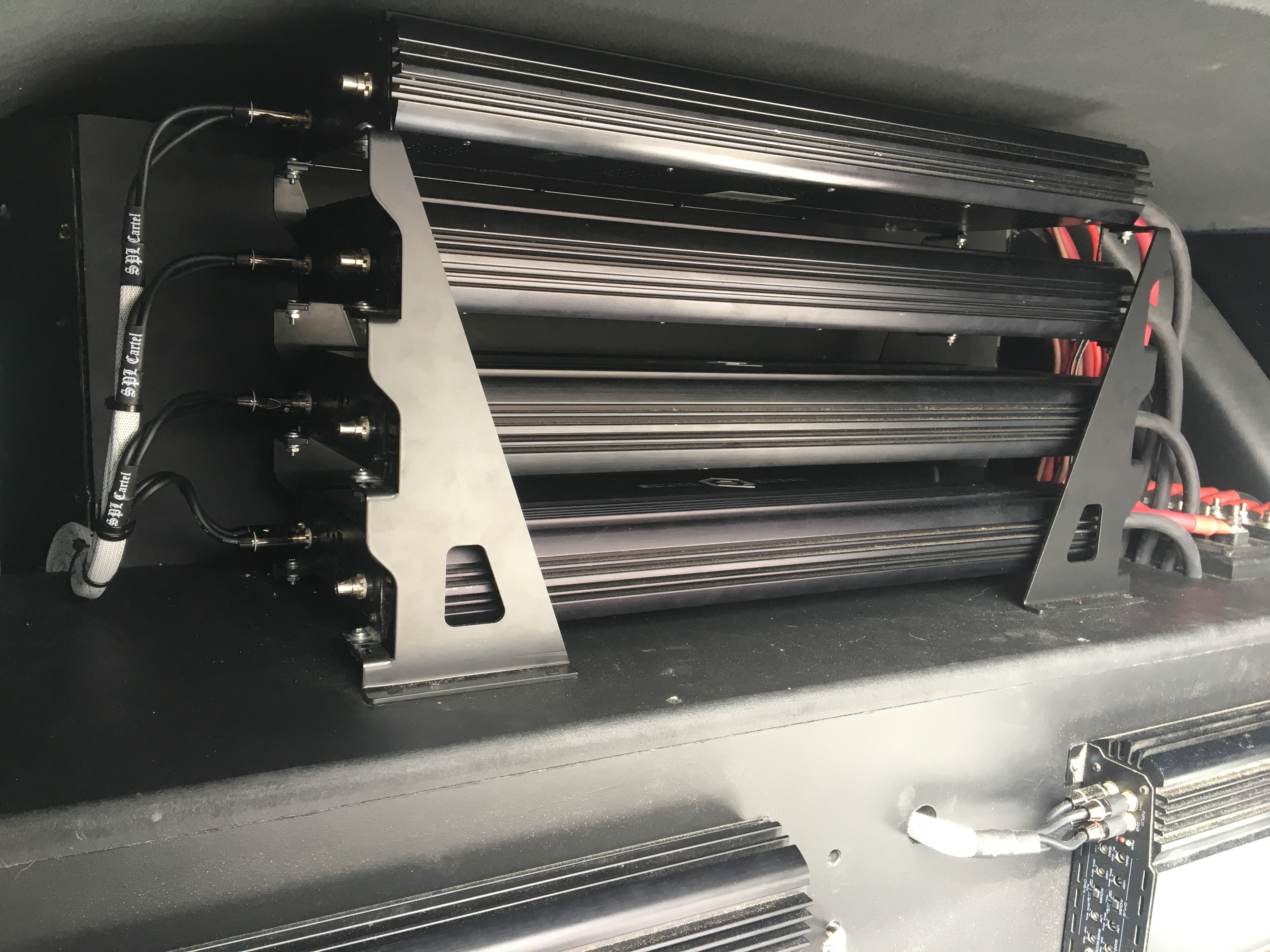

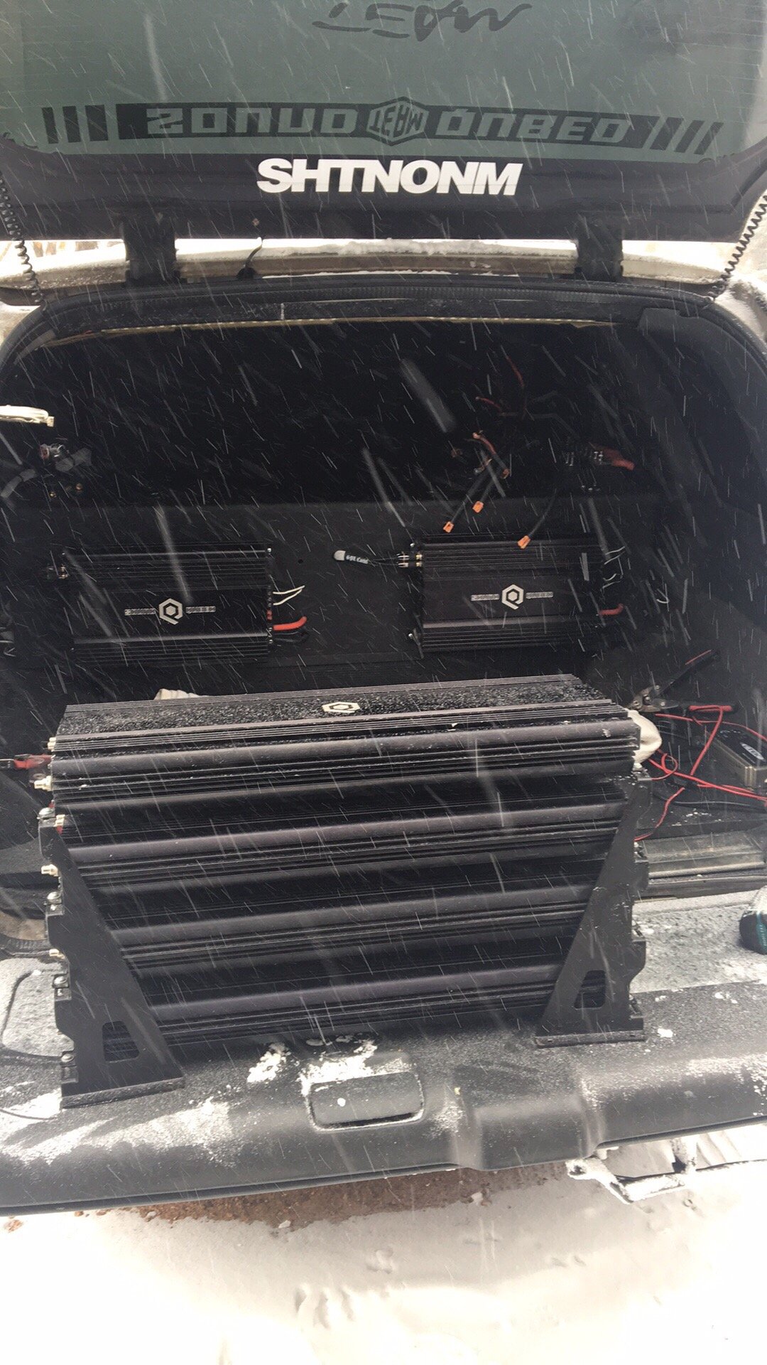

I took a look at the 3500 I didn’t think was working, and wouldn’t you know it. It works now! Lol. Hooked up all 4 and did some testing. Didn’t gain much. Got sooooo close to 156, but could only pull off a 155.9. They get a lot warmer much faster with an amp per coil and not much louder on the meter, so I just went back to running a 3500 at .35 each. Hammered on them all day at automotion and even had a couple tapouts. Got subs so hot you could almost burn yourself on the dust cap, but didn’t smell them at all, and they just kept taking it.
Well, come to find out one of my amps isn’t putting out any power. So this whole time One of my subs has only been playing on one coil. So I hooked up just two amps for now. Each 3500 wired at .35 ohm to each sub. Gained over a db by writing up the two amps! Does over a 155 now! I’ll have to pull the amp and take a look. Hope its an easy fix.

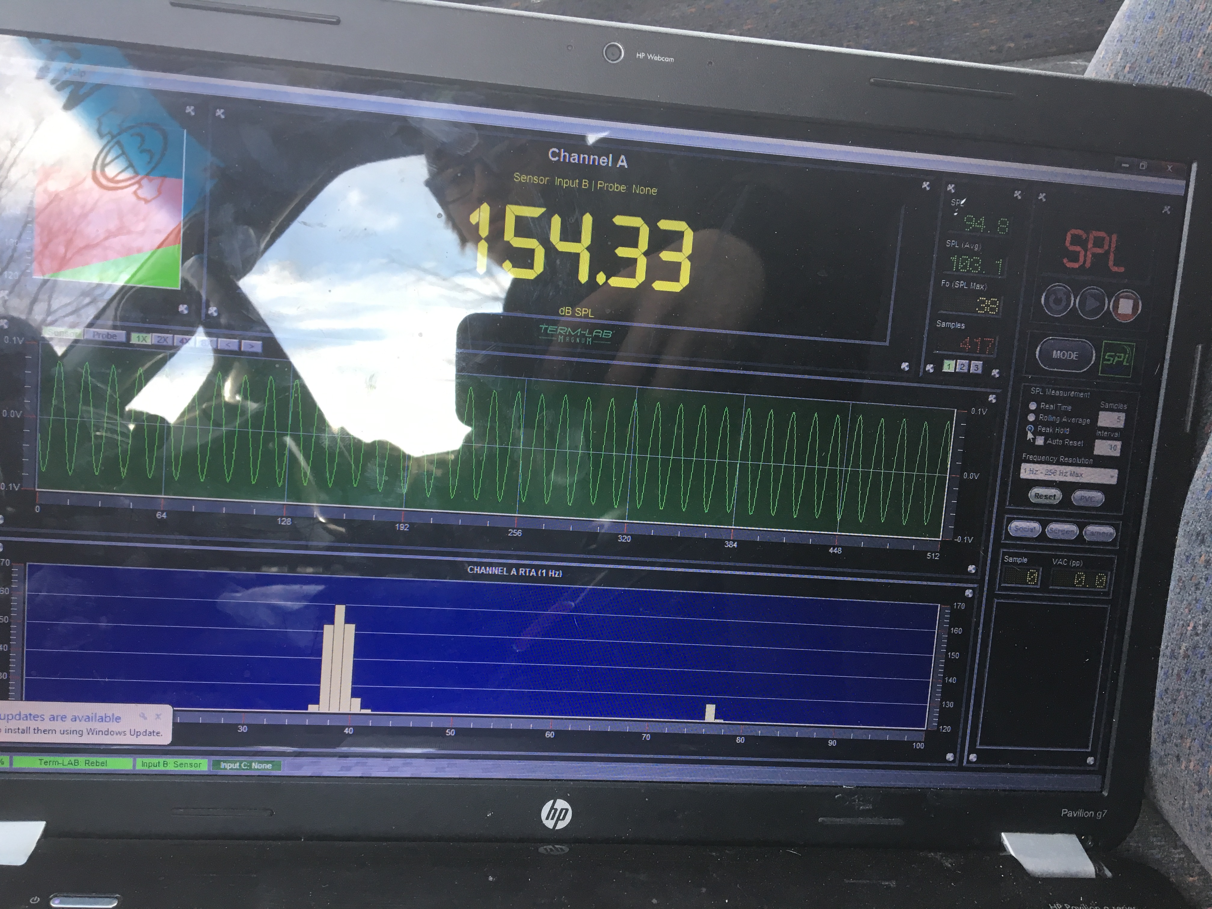

Got it all hooked up and playing. Waiting to get some tones for my cc1 to dial it all in properly. But it’s very musical! Plays much lower than I’m used to with the hdc4’s. I did a quick burp and did a 154.3 @38hz with drivers window down. Pretty decent for brand new subs. And pretty impressed with my electrical. Full tilt it holds 14.3-14.6 steady! Excited to do some more testing. I’m sure it’s got a couple more DB’s in it once it’s properly tuned and broke in.
