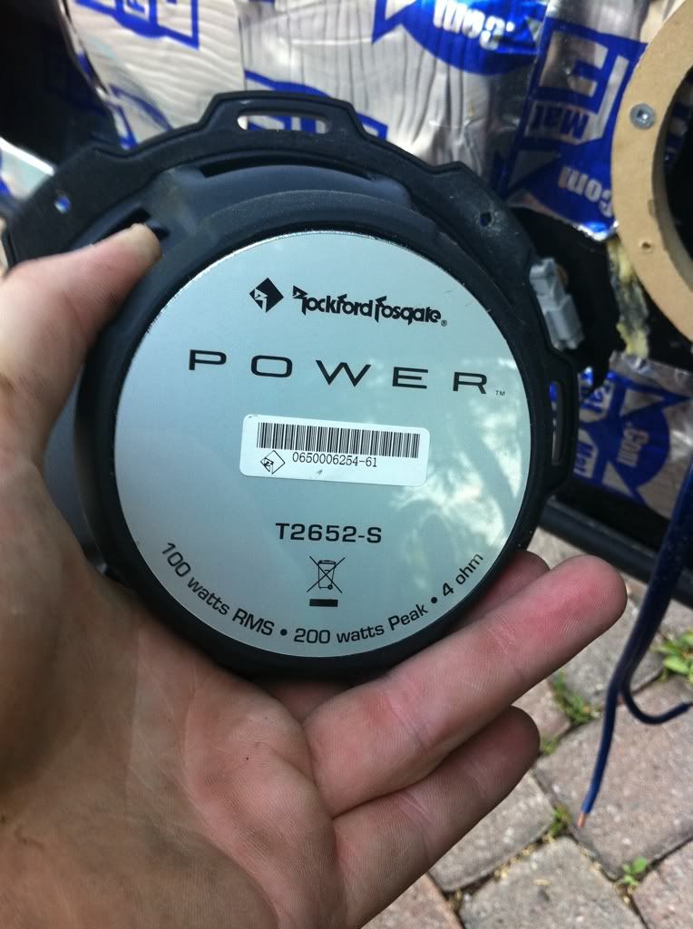

Soo after i sent all that time and money makin the panels i decide that I did not really like them. This is my daily driven and just want it to be clean and simple. So i ordered up some rockford 6.5 componets for the fronts. I went to the scrap yard pick up some new panels and some other parts for my car,
Fat mated the front doors. I know this stuff isnt the best but it was local and cheap. The rest of the car will be done in second skin lol
Ran 12 gauge speaker wire and made custom rings, the stock speakers were only 5.25 so I had to make the whole bigger.
Rockford mids!!!

Crappy pic of the stock door panels with the rockford mids and highs in.

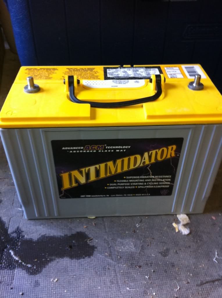

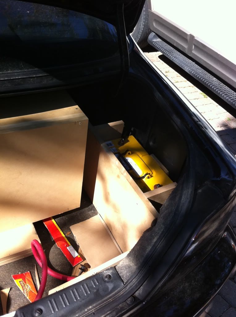

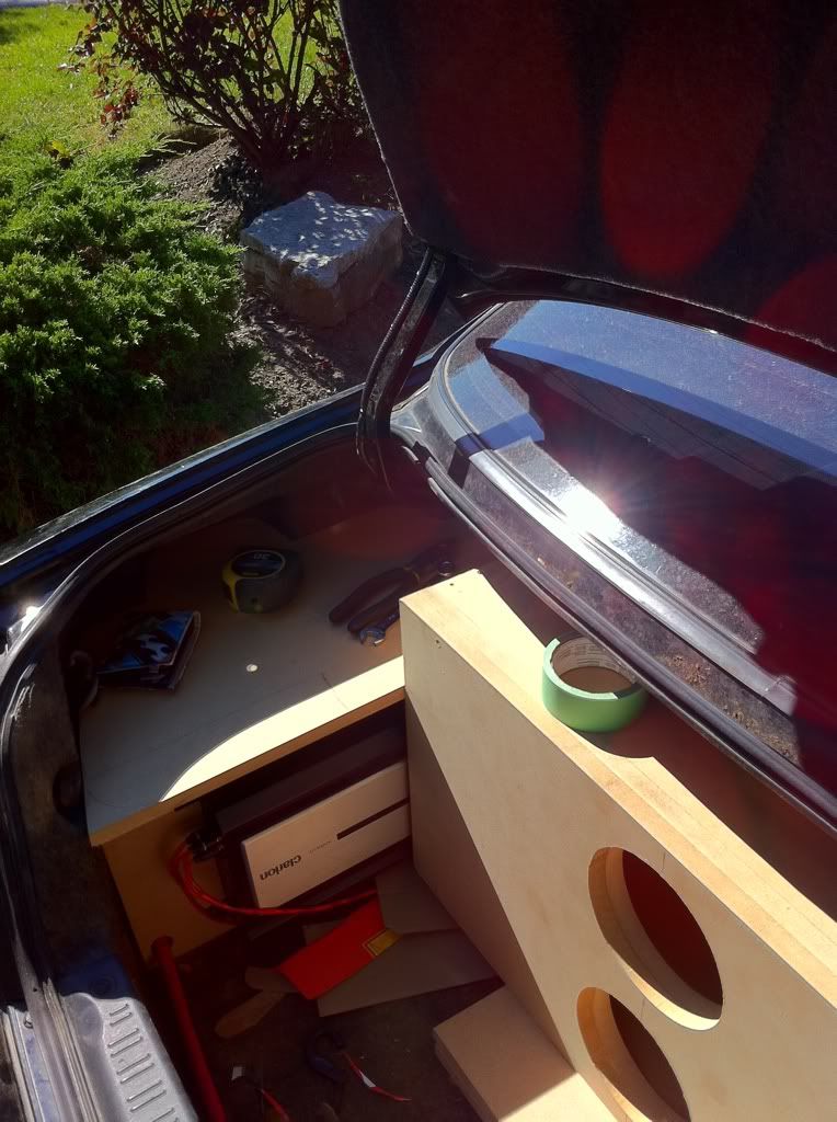

well i decided to move to the trunk. first thing is making the battery boxes
Picked up two of these:)
Got these to hold the fuses. they seem to work well

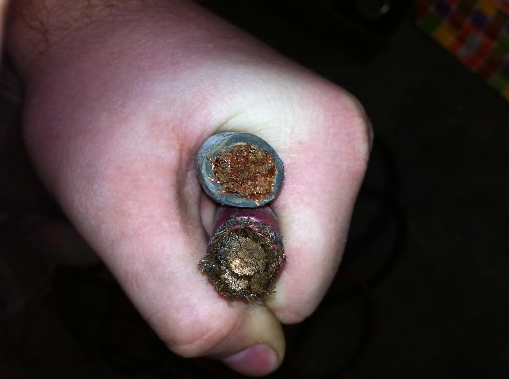

then i had the fun task of runing some 2/0 wire. ohh ya i got all this for free :)

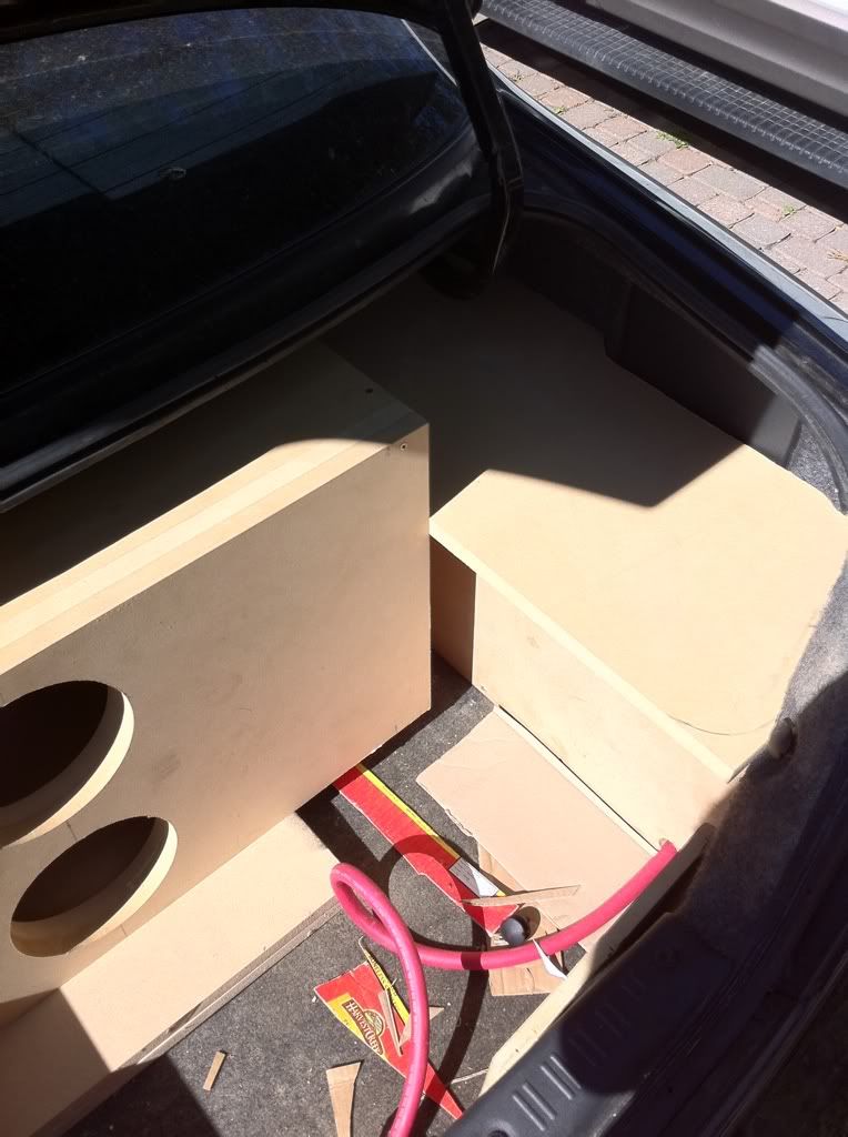

Front end
Rear end

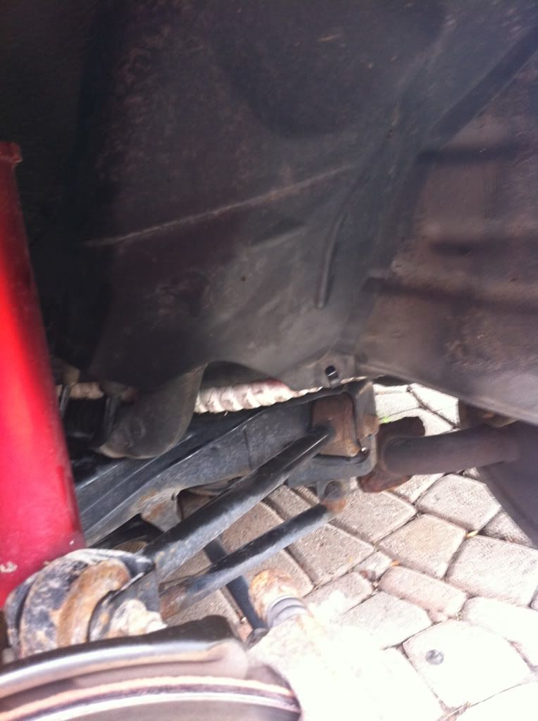

This is run under the car so it had to be run through the rear suspension. Its in a good spot will it will not get pinched.

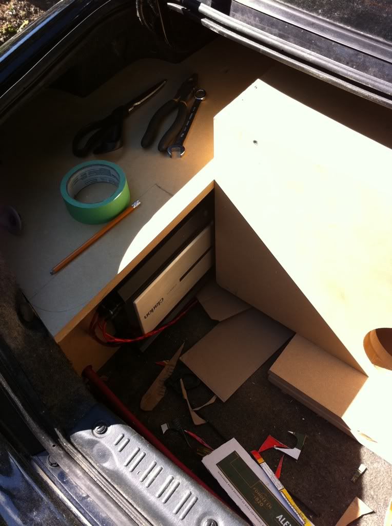

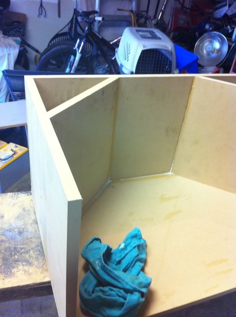

Next it was on to the box. RAM designs made this box up for me . It will be 3cuft tuned to 35hz. there will two 4in aero ports in the middle. this box is designed for 2 dc level 5s 10..
