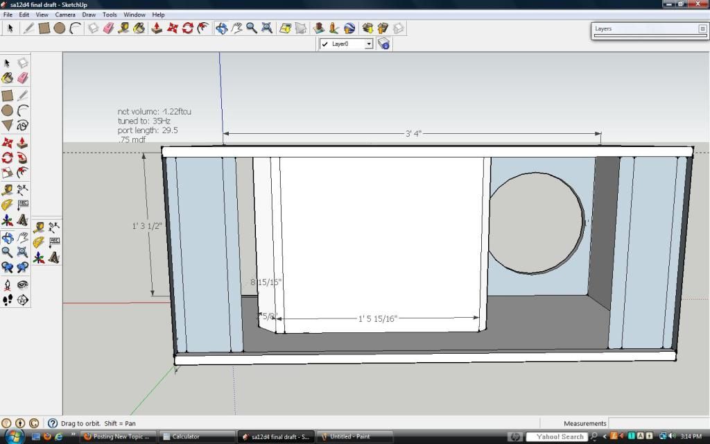

so i hopped online and found smd, after months of study and research i designed my first box since 1994. i was hoping some1 would check my math and design because i did it how i no should be the same but subs r so much more efficient now. please ring back if i need to change anything all help is appreciated. going in a 1991 isuzu trooper

is that box 1.2 cubes? if so too small for 2 12s
I think it says 4.2 but I think its before port is calculated in so its volume is like 3.something I think.. By looking at the measurements provided.

Looks about right per RF's specs online. Another member I'm sure will chime in on what they recommend for port are etc. Someone with more experience.

oh the box is for 2 sundown sa12d4's with a memphis mclass 1100 and soon to b a sundown saz 1500
how i sound wit my windows down
give me your dimensions
box dimensions r w=40" h=17" d=20"
port is 15.5x4.5x29.5
box was gross volume=5.56 port volume=1.86 subs=.14 and my corners and bracing was .14 hence 4.22ftcu unless i screwed up on my math
