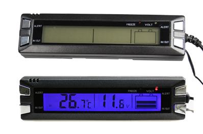

b33lz89 Posted February 10, 2013 Author Report Posted February 10, 2013 I do have a small car but I have plenty of space for the battery.. setup is around 2000 watts.. I'd hate to keep checking the battery with a voltmeter I thought there would be something I can install in the dash to monitor it.

Carbon Posted February 10, 2013 Report Posted February 10, 2013 ^ Get the biggest AGM cell you can fit under the hood wether it is one or two. and you should be good to go man! You seem to be avoiding the voltmeter so is this what your looking for? 531_2.jpg
