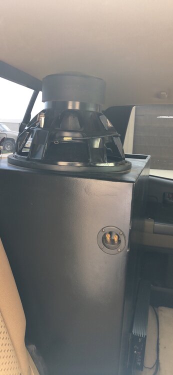

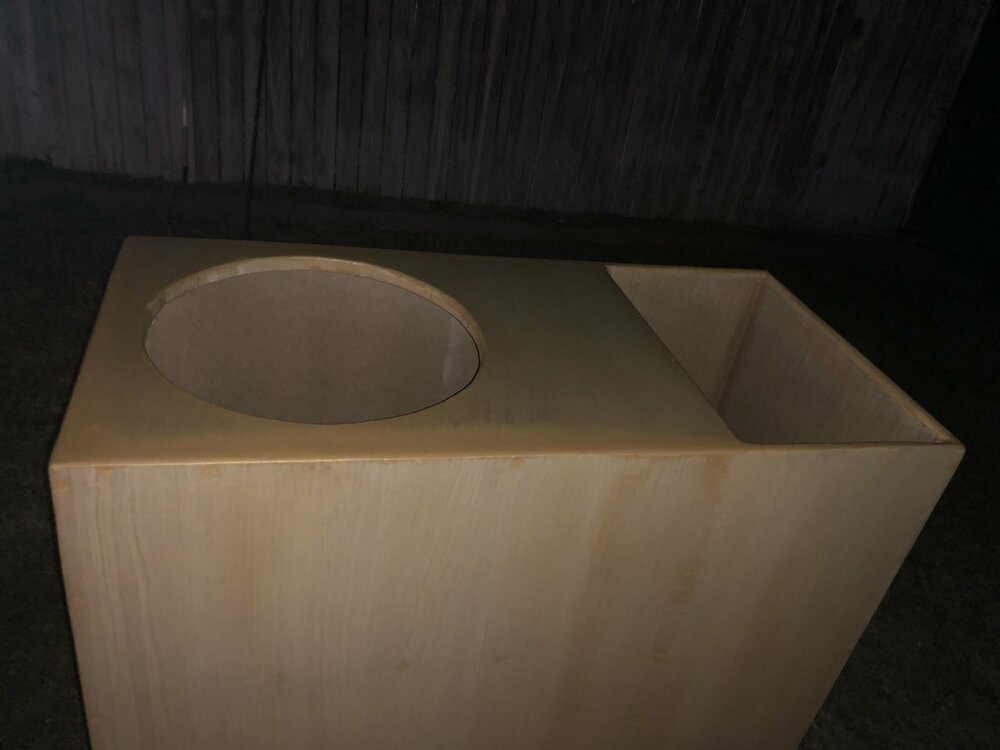

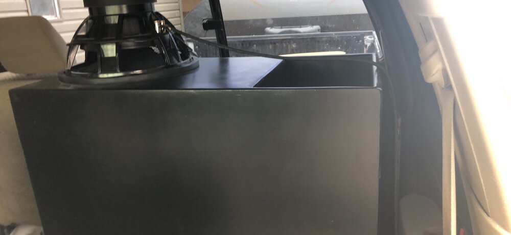

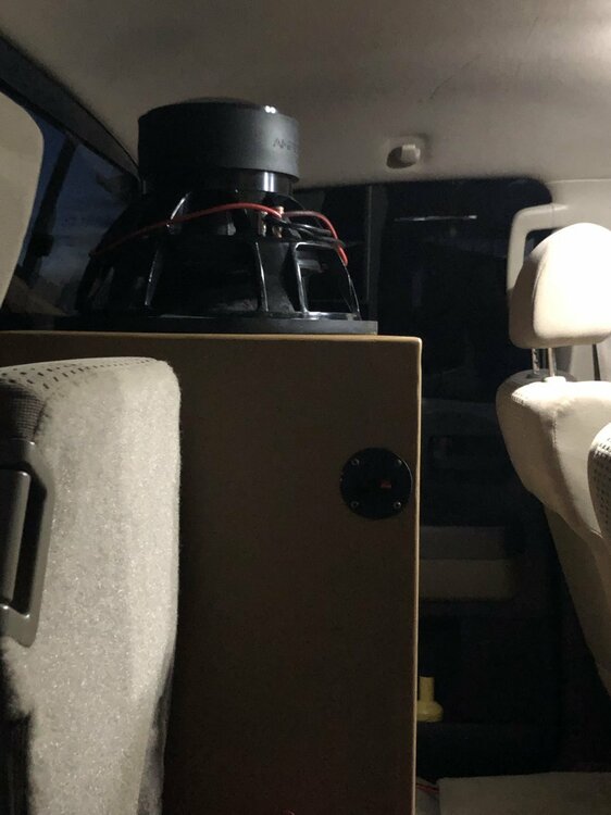

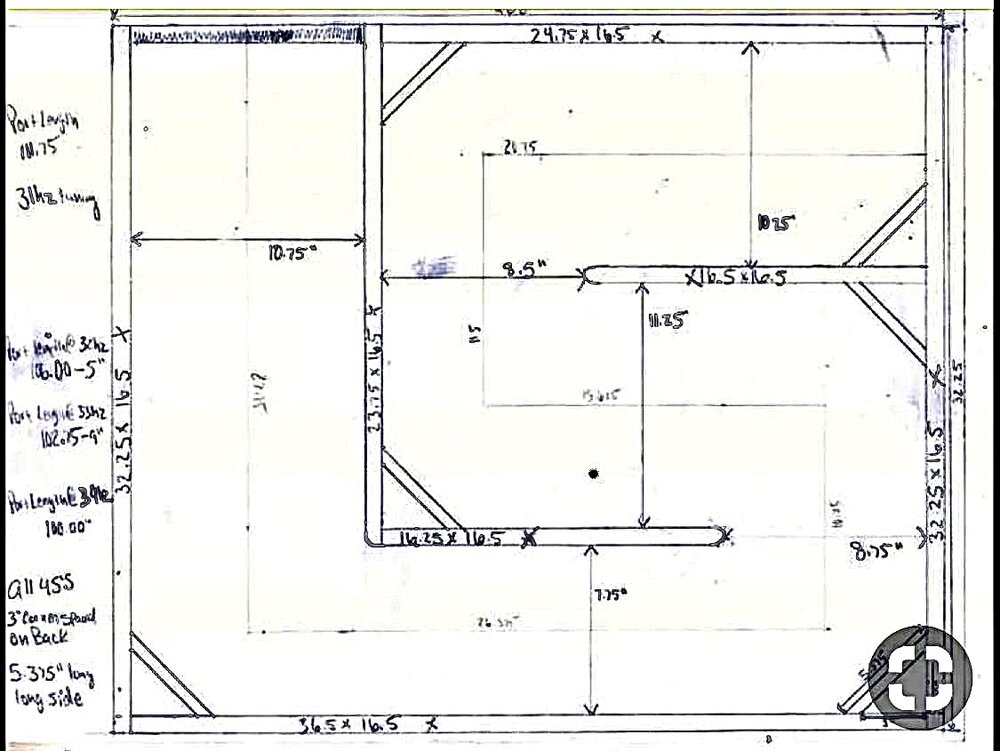

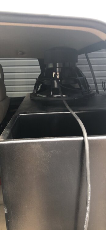

I know it’s a slightly old post but I figured I would chime in anyways. I built one for a single Ampere Audio 3.0 15” I was surprised With how hard it actually hit the lows. It hit hard enough to crack my windshield from passenger side to driver side. Attached is a picture of the enclosure and drawing with tuning numbers on the left.
