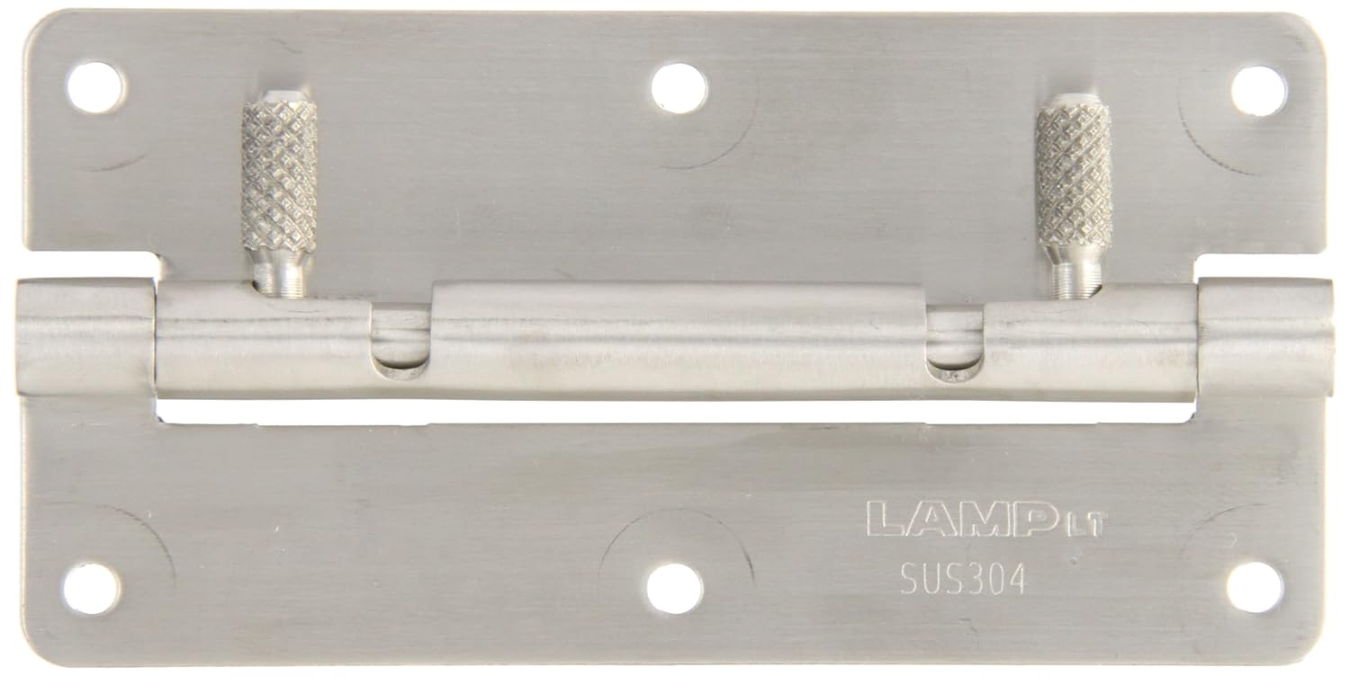

Was actually thinking about a couple of these. Quick release hinges.
Seams like one of those on each side would get the job done, that and being behind the seat will resist forward motion.

that looks prefect! the one i did was really strong!
we tried to move It And break it. not gonna happen!

but needless to say don't use the screws that come with the latch. we bored out the holes And put some really strong thick bolts there.
