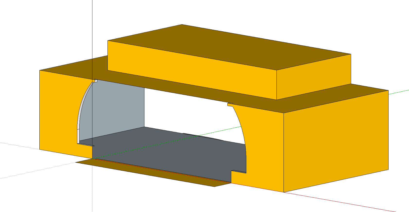

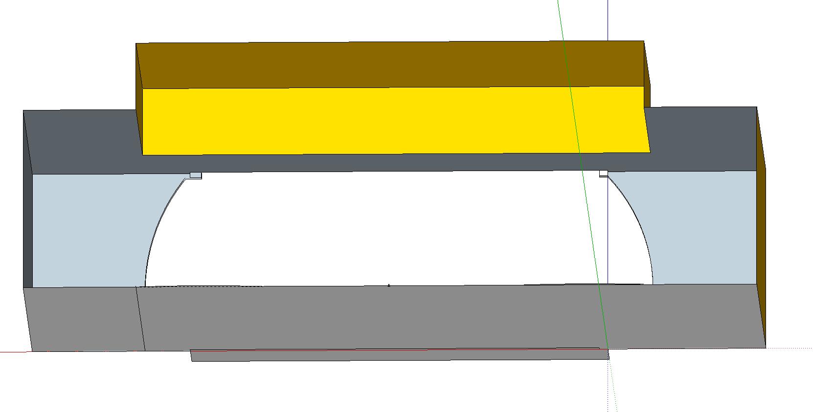

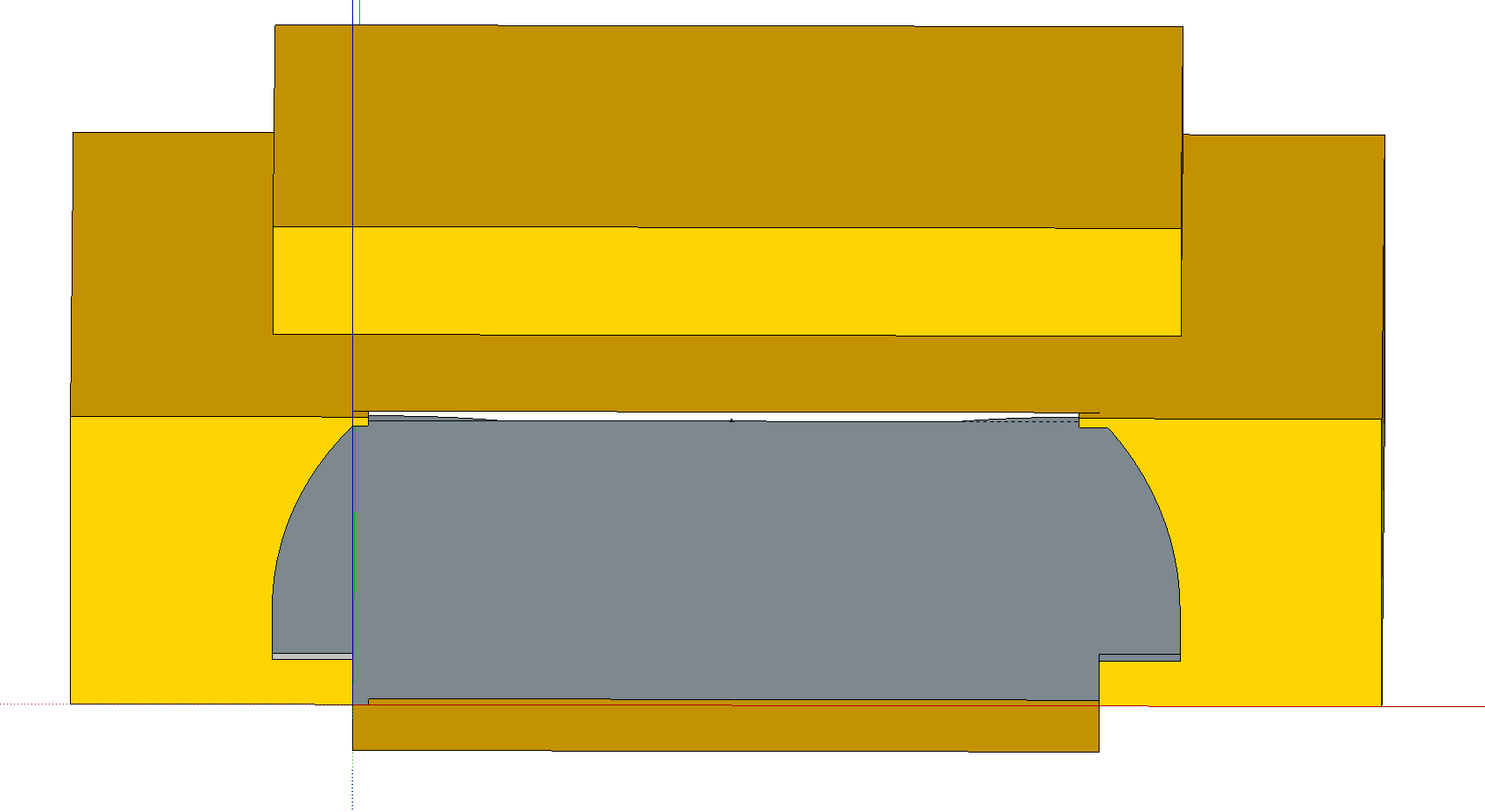

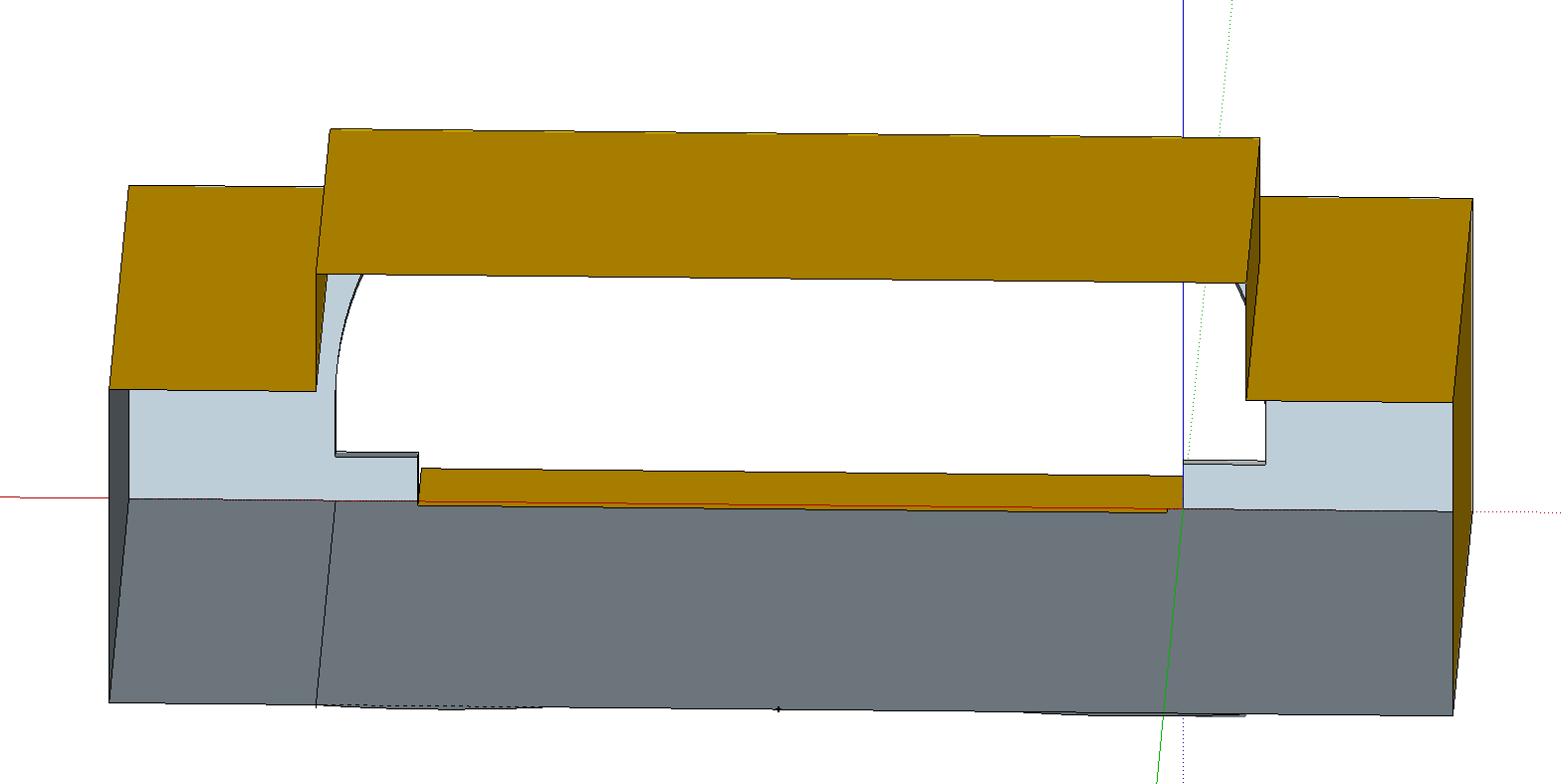

roudabout6 Posted July 19, 2015 Report Posted July 19, 2015 Upgrading from dual XFL 12s on a bc2000 to hopefully dual hds3 15s. My only problem is trunk space. The opening to my trunk is 15in tall and 36in wide. My trunk is 30in deep though. With those dimensions that nets me 7.68 ft3 according to Torres. If I were to build the box inside the trunk I could build it with the dimensions of 21h x39w x 21d. My problem being I dont even know how I would start building a box inside my trunk. So I came here for help. Also I have not purchased the subs yet so if there is a sub that would perform better in my situation I am open to anything. Smaller box through trunk opening Box built inside trunkSketups of my trunk too big for forumshttp://i.gyazo.com/4abc9b3db8c0a996162d510c848c2456.pnghttp://i.gyazo.com/a8030d3c3be2babbb3103a32d56a7011.pnghttp://i.gyazo.com/be52481c0747a7989435b7d9a584e011.pnghttp://i.gyazo.com/2b07b28bd3e3d41c0dc7c381c9b9db8a.png
Triticum Agricolam Posted July 19, 2015 Report Posted July 19, 2015 Neither of those dimensions are going to give you enough space for two 15"s. Keep in mind the port is probably going to take up at least 2 cubes of space, unless you want to run the subs sealed, which I assume you do not. "Nothing prevents people from knowing the truth more than the belief they already know it.""Making bass is easy, making music is the hard part."Builds:
