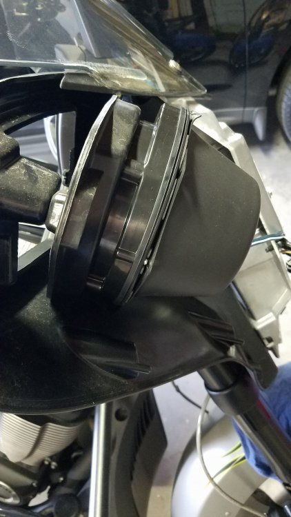

I have upgraded my mobile audio system on my 2014 Victory XC bagger. I am looking for advice of subwoofer and enclosure types for very limited space. Seal, vented, 4th order, 6th order. Whatever it takes. I am looking to get the best quality bass out of a small area.
Current upgrades to bike are 6 1/2 RF 1650 in the fairing, 5 1/4 RF Punch in the saddlebags, have a RF Universal Punch bass/treble and line driver RFPEQU, RF PBR 300.4 and a RF PBR 300.1. She sounds great, but I am looking for some I can run at 1 ohm off of the 300.1 and enclosure type to put it in. Any and all suggestions will greatly be appreciated.16112602_2035843809975486_8799175402980979562_o.jpg
Not sure how much room you have but it will almost definitely have to be sealed as that will be the smallest enclosure. I would look at Wet Sounds or Alpine Marine since they are water resistant.
