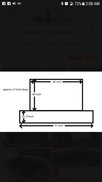

This is the dimensions of the trunk. The 40" width i cut down to 36" because of the hump at the bottom of the wheel well. My dimensions in my first post were conservative.   I can use  as much trunk as needed,  just need to make sure I have room for 3 amps.
I'm not opposed to doing a sealed box. But if i have the room,  i wouldn't mind going ported.  I want spl, but i also love great sound quality. The trunk has a height of 17 inches.
