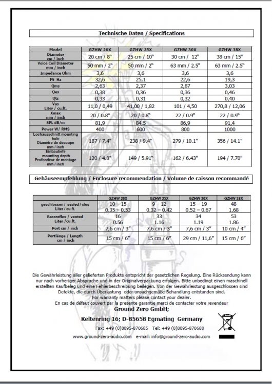

Nessuno Posted August 31, 2017 Report Posted August 31, 2017 Hope someone can help me out a bit. Thanks in advance for reading my post! Recently i have bought 2x groundzero gxwh 30x subs. The question i have is, when i look up the spec's. They tell me 12" ,800w rms and 2x2 ohm (what made me think 2 pair of leads both 2ohm.) So that you could fiddle around with the impendace (just like with my old kicker l5. 2x4 or 2x2 or 1x8 ohm) (1x4 ohm) 2x2 ohm or 1x1ohm?) When i got the subs i noticed they only have 1 set off leads connected and when i measure them, I get 4ohm. There is also just one pair of push therminals. So are these just 1x4ohm?? On the spiders i can see the second set of leads but they are not connected and when i measure them i get nothing. If any any one know these subs and could help me out with some info i would be rly happy. Thanks Alex. Ps sorry for the grammar errors im dutch.
Herrie_V Posted August 31, 2017 Report Posted August 31, 2017 They are just 1x4 Ohm, that 2x2 Ohm is just a marketing thing.
Nessuno Posted August 31, 2017 Author Report Posted August 31, 2017 If i google the name i get 2x2ohm. if i youtube the type i can see clearly in some movies 2 sets of push terminals. 2x2 ohms is 800w rms what what would these do than @ 4ohm single coil. Just burned my L5 12" 600w on 2ohm And im not in the mood to burn these baby's ? Amp is btw a kicker zx750.1D mono subwoofer amplifier 375 watts RMS x 1 at 4 ohms (750 watts x 1 at 2 ohms) variable low-pass filter (50-200 Hz at 24 dB per octave) variable bass boost (0-18 dB at 40 Hz) subsonic filter (12 dB at 25 Hz) wired remote bass level control Class D design CEA-2006 compliant speaker-level inputs preamp outputs fuse rating: 40A x 2 4-gauge power and ground leads with 80-amp fuse recommended — wiring and hardware not included with amplifier Thanks again!
Nessuno Posted October 5, 2017 Author Report Posted October 5, 2017 found spec's seems there are 2 types 1x 4 ohm coil And 2x2 ohm coil so they are different.
