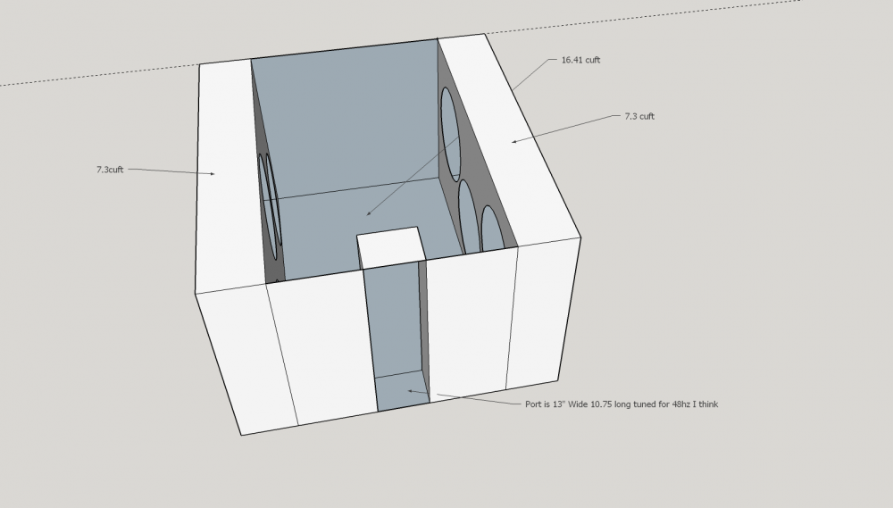

olumpa Posted October 20, 2017 Report Posted October 20, 2017 Alright guys here goes, I am looking to build a 4th order with 6 15" Soundqubed HDC3.115's (the subs will be facing into the sealed chamber) on a pair of DD M2c amps at .67ohms. This will be going in a GMC Jimmy, exterior box size is 49W x 32H x 48D Here is the drawing I have please help me figure this out.
Triticum Agricolam Posted October 20, 2017 Report Posted October 20, 2017 Your port is 13.5" wide, but how tall is it? "Nothing prevents people from knowing the truth more than the belief they already know it.""Making bass is easy, making music is the hard part."Builds:
olumpa Posted October 20, 2017 Author Report Posted October 20, 2017 Sorry forgot to add that info 30.5"

Triticum Agricolam Posted November 15, 2017 Report Posted November 15, 2017 On 10/31/2017 at 5:30 PM, olumpa said: Thanks I will check back for your reply. I got a chance to look over your numbers. I had a question for you, in the image you posted you listed the front chamber at 16.41 cu ft. Is that the net volume with the sub and port displacement already subtracted out of it, or is it gross volume? "Nothing prevents people from knowing the truth more than the belief they already know it.""Making bass is easy, making music is the hard part."Builds:
olumpa Posted November 16, 2017 Author Report Posted November 16, 2017 Gross volume I am unsure of the exact displacement I think the math I did said the total after the subs and port is 14.2 cu ft.
Triticum Agricolam Posted November 16, 2017 Report Posted November 16, 2017 13 hours ago, olumpa said: Gross volume I am unsure of the exact displacement I think the math I did said the total after the subs and port is 14.2 cu ft. Well the subs displace 1.02 and the port displaces ~2.56, depending on how you implement it. So I come up with 12.83 cu ft net. If you have any more space you could increase your front chamber size quite a bit for more output. You could probably shrink down you sealed side a bit too to make the front chamber larger. As far as port area goes I think you are looking pretty good. "Nothing prevents people from knowing the truth more than the belief they already know it.""Making bass is easy, making music is the hard part."Builds:
