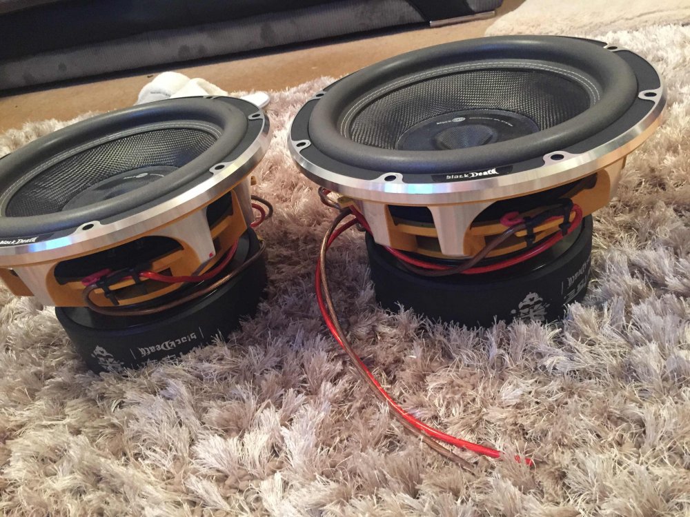

Jordan Walsh Posted November 19, 2017 Report Posted November 19, 2017 I have two Vibe blackdeath spl 12" v2 1500W RMS subs and i've tried to design my own box but got no luck with bassbox pro. Im looking for a ported box with the max sizes of Width(side to side) : 900mm/35.43" Height(up and down) : 650mm/25.5" Length( front of vehicle to back of vehicle) : 800mm/31.4" They will be powered by the vibe blackdeath mk14 v6 amp in paralell Using 18mm mdf with a double layer baffle If anyone could help it would be much appreciated. TS PARAMETERS Parameter Series Parallel Revc 3.6Ω 0.9Ω F0 34Hz 34Hz Sd 53cm2 53cm2 BL 28.9 TM 14.4 TM Qms 3.333 4.537 Qes 0.335 0.383 Qts 0.304 0.353 N0 0.283 % 0.269 % SPL 86.5 dB 86.4 dB Vas 23.623 Ltr 23.014 Ltr Cms 59.018 uM/N 58.601 uM/N Mms 358.295g 362.691g Mmd 344.933g 339.329g X-Max 15mm 15mm Peak to Peak excursion 45mm 45mm
AlpineNut Posted November 19, 2017 Report Posted November 19, 2017 Would this help at all? I think i found a instruction manual to those subs which gives the specs for the boxes you need/ https://issuu.com/vibeaudio/docs/blackdeath_subwoofer_manual 73456w9vbwevsdb sodtbsorutnvsd sdtuspdun sd d f gsdfiusd gdf n
