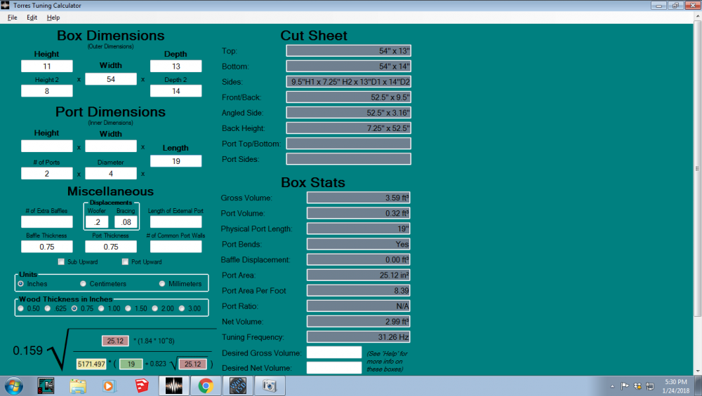

SLAB153 Posted January 30, 2018 Report Posted January 30, 2018 Hey guys I’m trying to get a sketchup of 1 sa10, 2 e10s or 2 Sa10s ported under my rear seat sub front firing and port side fire. My dimensions are 55w, 10 3/4 front height, 5 1/4 rear height, 13” top depth, and 14” bottom depth. I’d like it to 32hz. There’s a local builder who mass produced them with those dimensions and 2 ports front firing in each corner port dimensions are 2x4x14 long at 32hz he claims but it came out to 19hz

Triticum Agricolam Posted January 30, 2018 Report Posted January 30, 2018 41 minutes ago, SLAB153 said: My Orion 2500 birthsheet says 2713 rms 1 ohm @12.6v I’ll run about 1000w daily and some days I might turn it up to 2200w if possible. So the space you have to work with isn't impossibly small, but its small enough that some significant compromises are going to have to be made. SA-10s probably aren't going to fit. The problem is the motor diameter. You might be able to make them fit by machining out pockets in the top and bottom panels, but its going to require a lot of hand fitting and when you are done you are probably going to want to reinforce the areas you machined out with fiberglass since you are going to need to cut at least half way through those panels. E-10s SHOULD fit fine though. I say they "should" fit because it's still going to be tight and it's hard to know for sure without actually test fitting the sub. You don't have enough space to properly house two 10" subs. The gross internal volume I came up with was about 2.35 cu ft, but you have to subtract sub and port displacements from that which is going to put you WELL under the 1 cu ft per sub you usually want for 10" subs. Plenty of room for one sub though. With a single E-10 you aren't going to be able to use the full potential of your amp. Even putting a 1,000 watts to an E-10 is probably pushing your luck quite a bit. "Nothing prevents people from knowing the truth more than the belief they already know it.""Making bass is easy, making music is the hard part."Builds:

SLAB153 Posted January 30, 2018 Author Report Posted January 30, 2018 This is specs on a front firing side port dual Sa10 box that requires 2” seat lift kit. I don’t want to lift my seat because anyone over 5’6” head will touch the roof getting out.

Triticum Agricolam Posted January 30, 2018 Report Posted January 30, 2018 2 hours ago, SLAB153 said: The design u came up with is sub front firing or is it down towards floor or up towards seat? It was forward firing. The design you posted above has woefully inadequate port area. You would be wasting a ton of power on port compression and would have nasty port noise. I know you don't plan on using that design anyway because it requires a seat lift, its just something to keep in mind. "Nothing prevents people from knowing the truth more than the belief they already know it.""Making bass is easy, making music is the hard part."Builds:
